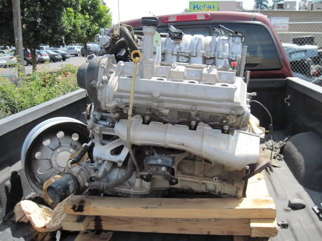

Here is a quick Google picture of the Tundra 4.7. I changed my motor mounts recently and they appear to be in the same location at the 100 Series 4.7L. The second picture is of the SAS that Slee did (100 Series). My question is the third picture, it shows a much different style motor mount. It's a stem with some type of dampener (Sequoia?)
So it appears the Tundra and 100 Series share the exact same motor mounts. However there is the 3rd pictures which is a 2UZ-FE but has a different mount. I can't say for transmissions though.
