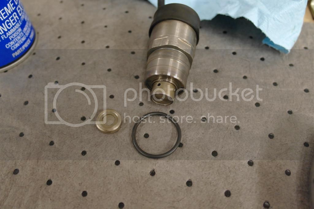

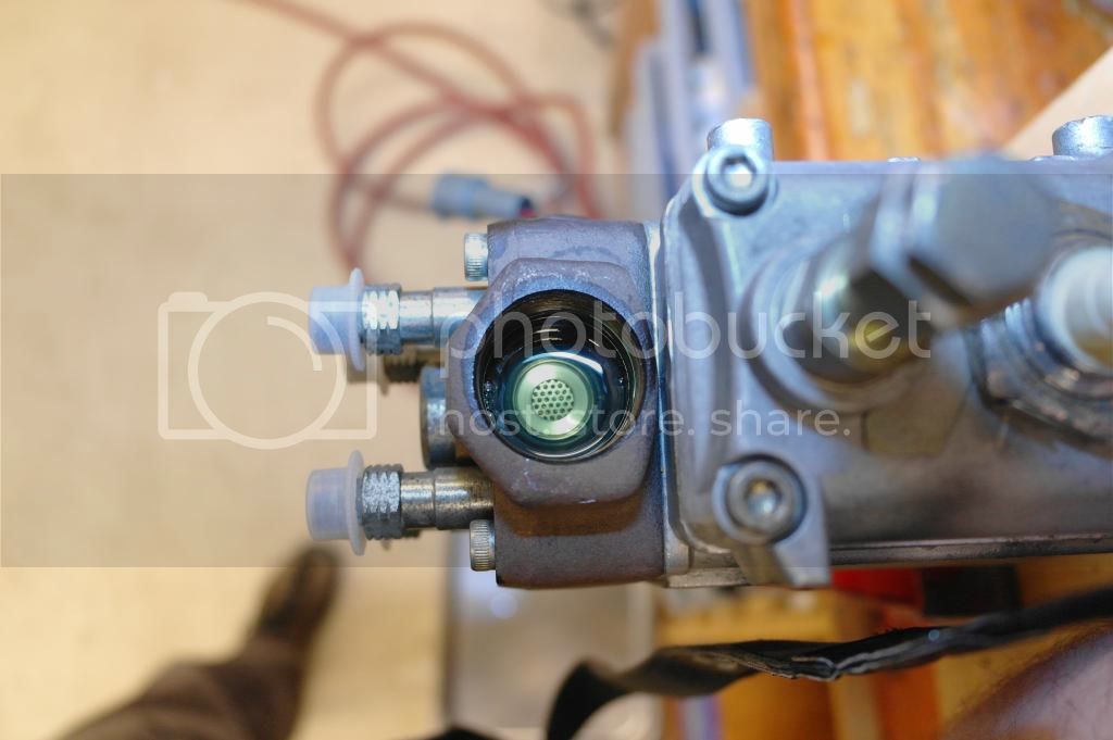

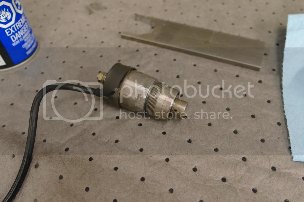

Your symptoms are classic fuel starvation. I know you cleaned your tank and fuel filter, but another possible location that algae could be plugging up the system is under the spill control valve in the head of the injection pump. There are some very fine filter mesh elements in there. If algae washed into the injection pump somehow (or grew in it), these filters could be plugged.
Remove spill valve to get at these. I had to make a tool to remove mine when I resealed my pump a few years ago. Here is a picture of the filter mesh I'm talking about. More pictures can be found here: Resealed my rotary injection pump - https://forum.ih8mud.com/threads/resealed-my-rotary-injection-pump.826009/
