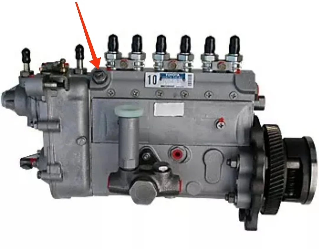

There is a big bleed screw on the IP itself also, that should be bled first, then then bleed screw at the fuel filter housing, then each Injector as you crank the engine over ( or as it running if it starts up ) worth a try.
