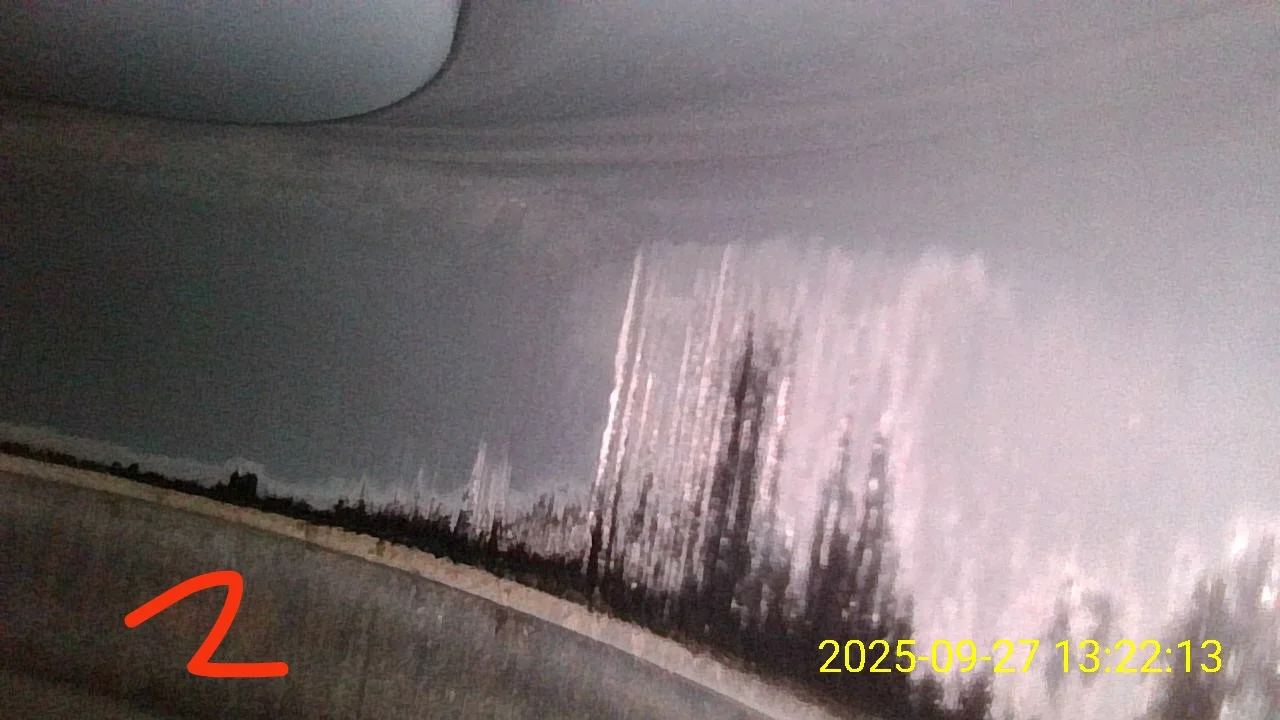

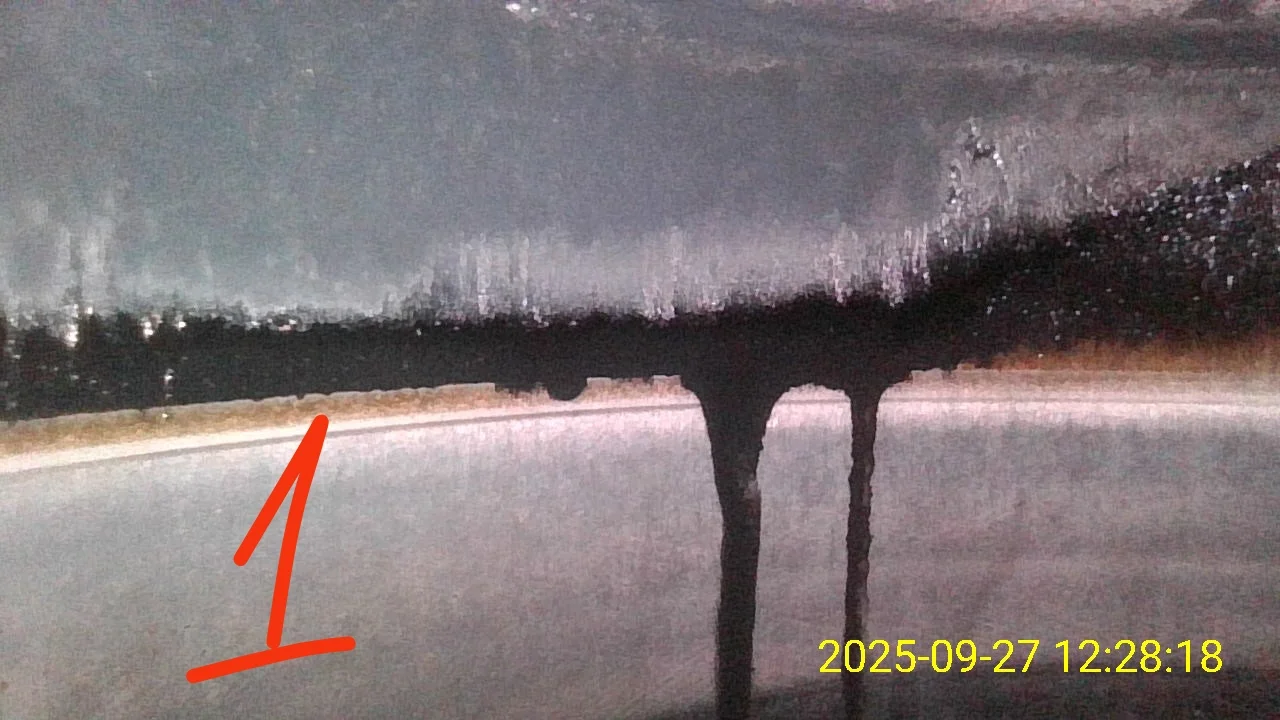

Did manage to put a boreacope through the pre-chamber. On all 6 cylinders in the upper section past the rings – some hefty gouging and black burned oil residure. However, looks pretty ok below the top dead ring stop point. Some scorring, yes, but nothing I personally would consider critical. Honing looks ok. Only 2 valves are leaking (#4 and #5 intake ones), the rest are good. I was hoping for the valve stem seals to fail but no luck.

Here's the characteristic gouging past the rings of the cyl #2 (don't want to spam here with pretty much the same images). Same pattern is present on all of them to a larger or lesser extent.
The #1 seems having it the worst, gouging + accumulated oil that is just dripping.
But, again, no excessive scratches on the rings travel path itself.

Those are interesting scratches on the bores, looks like there is some foreign (or broken ring) material riding on top of the top compression ring.
If the engine runs rough when hot and the injectors are good, I would start to wonder about the condition of the pistons/rings. The excessive oil on the walls of the bores might be masking low compression results.
Yeah I noted them too, because on the ring travel path there aren't continuing, at least that excessively. A friend of mine joked that I caught a sparrow in the intake :)
