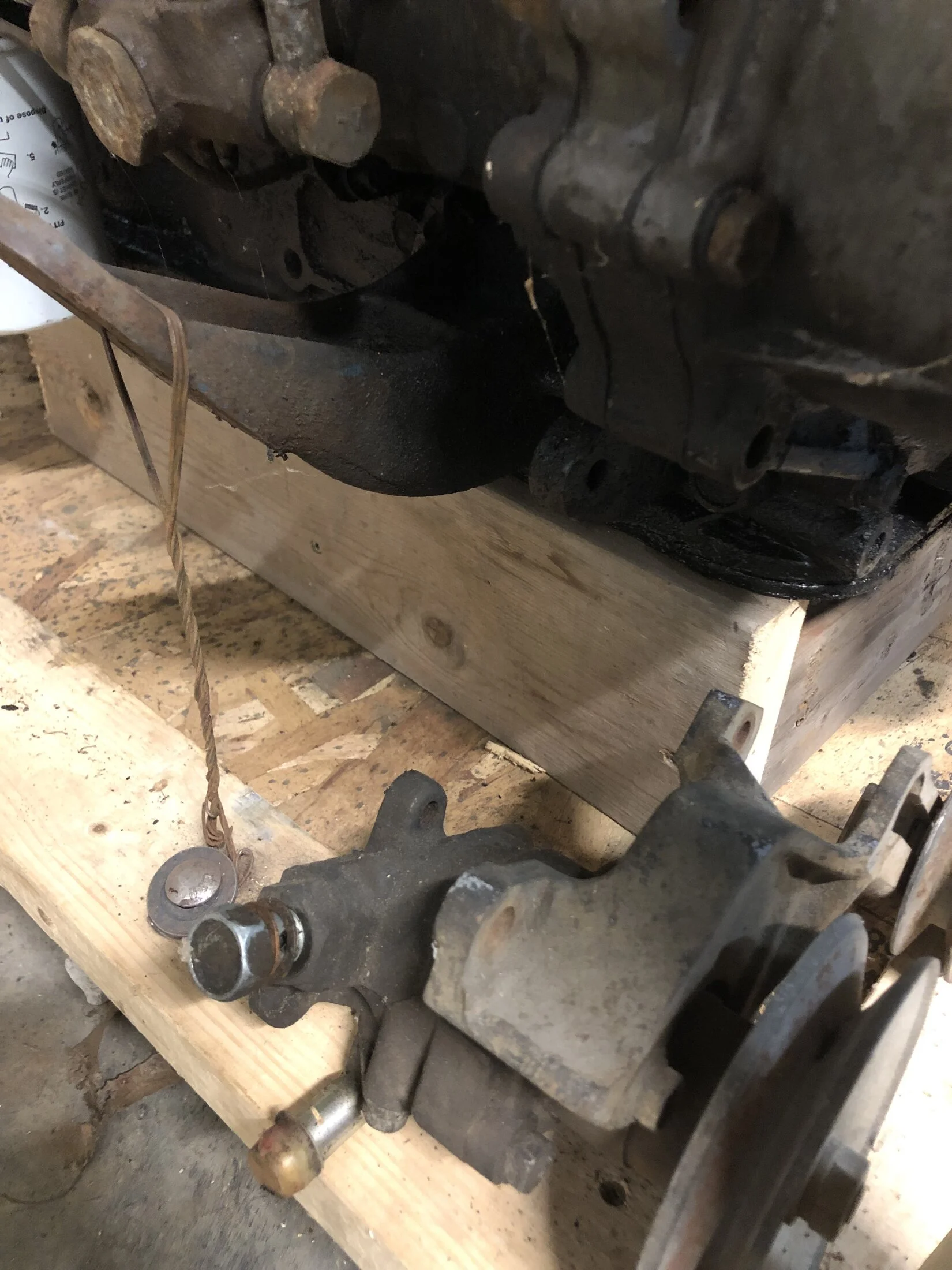

@duncanrm thanks for all the information. Here are a couple pictures. Of my pump that came with the 2h and engine Mount for that side. Also gear box is mounted and ready. I see what you stated about the lower radiator hose. I plan on using the bellhousing off the h with the 4 speed. I was told everything should bolt up.
I think thats a 4 Bolt pump.. so you may have to do a tiny bit of fabrication to make something work for the mounting. The H Bell Housing reportedly can work but I hear getting a starter motor in may take some effort with a grinder on the oil cooler cover.

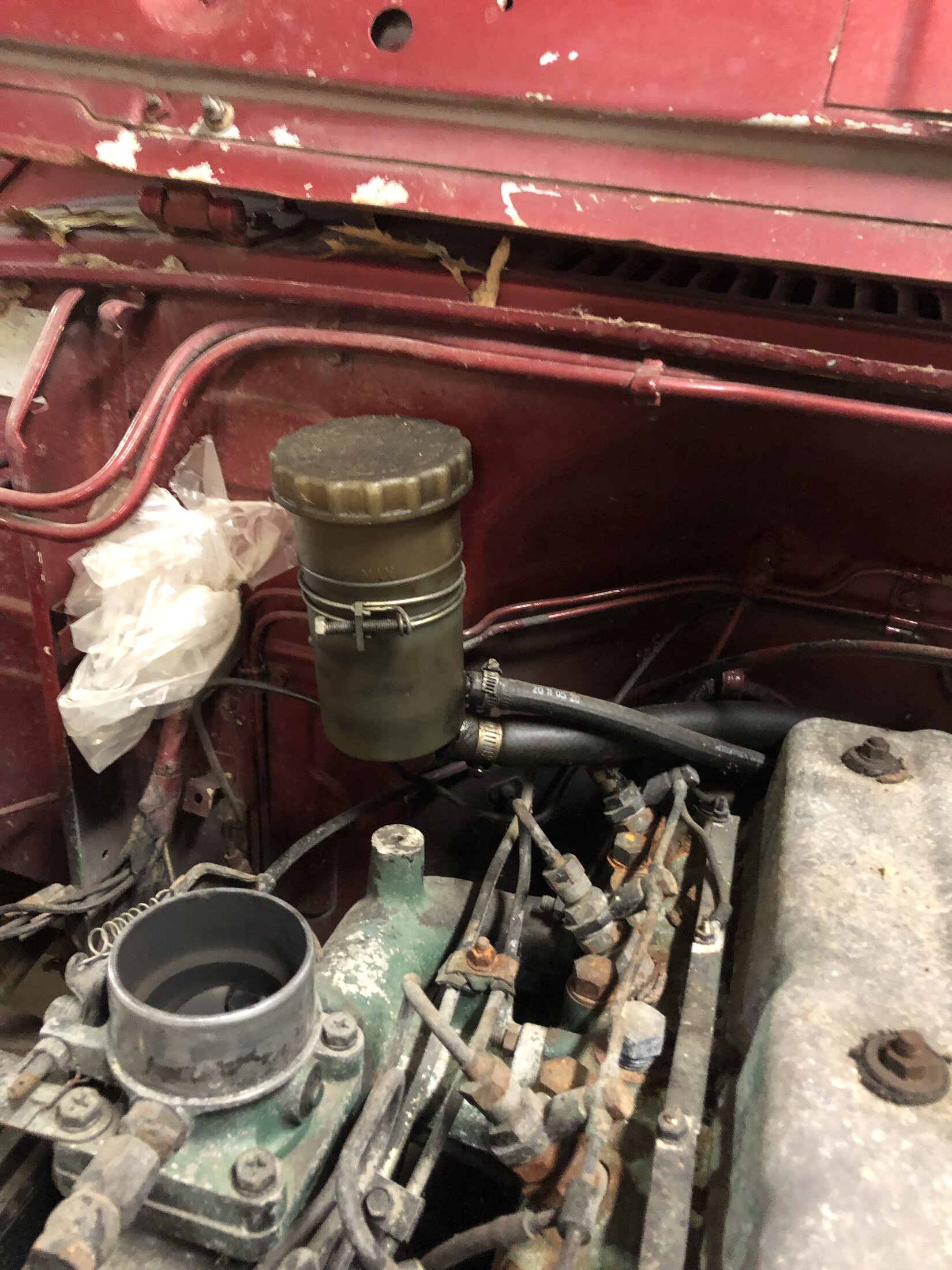

Great thanks for the help and information that the reservoir mounted to the inner fender. Current reservoir is on the firewall. So I’ll probably reuse it.
I was just wanting something more factory looking.

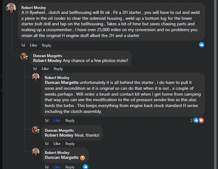

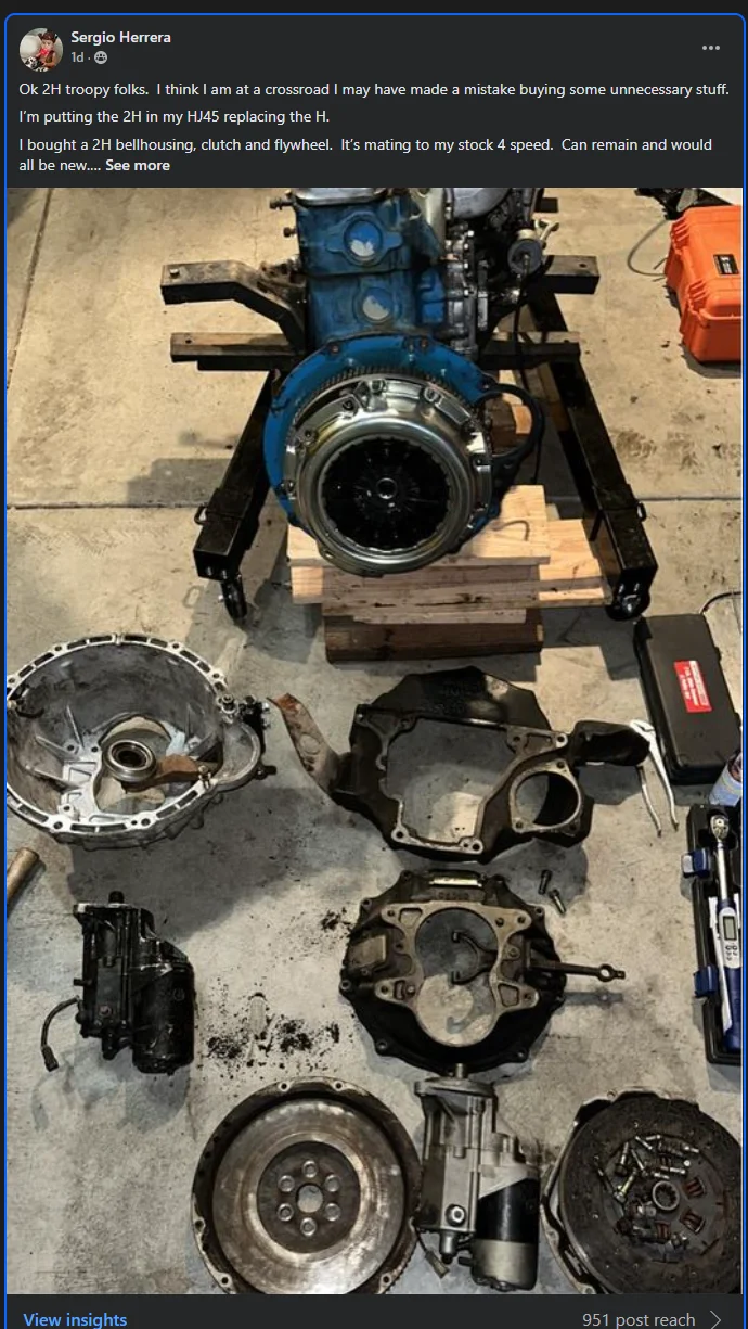

Over on my 2H/12HT Facebook group (link in signature) this question was recently asked.. relevant screenshots below are of relevance to you.. I would suggest the H Bell Housing and 2H engine is not for the faint hearted!..
Oh boy…I’ll check out the facebook page. Thanks for the help. Just not sure where to cut the piece for the oil cooler or the exact issues with the starter lug and tapping he is referring to. Thanks!
Jason
