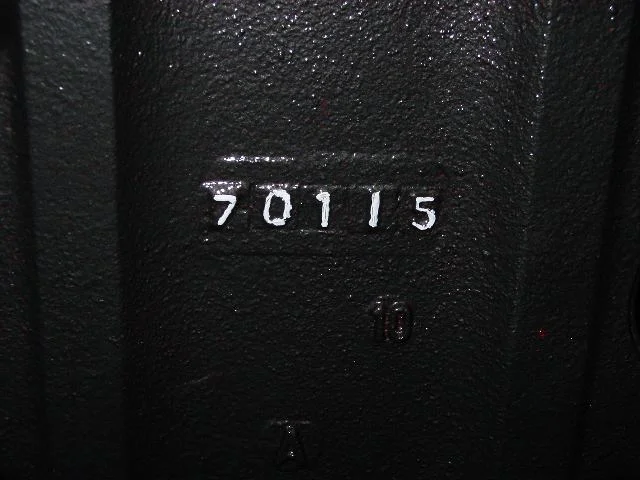

The driver side of the engine block, toward the rear has the production date cast on it.
Pics show the date code on a typical 2F block.
Format is Y MM DD
7 01 15 = 1977 or 87, January 15th
The paint is "Rustoleum hammered black metallic". It was used on this particular block to help camouflage the welded & bondo-ed hole where the rod tried to escape.
No, it did not go in a customer vehicle. It's in my junkyard dog truck.

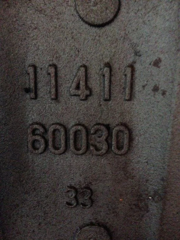

Or is this one my engine build date meaning it is 1971 June 9th. Both these are stamped on the one side of the block.
What is the 11411 number then.
Thanks Johnny for the info at least I have a bit better time from for the build of my 40.
Block part number is 11411-60030.
Block date is 1 06 09.
The 60030 tells us it is a later F engine (60010 is first version of F, 61010 is first 2F).
Date is year ending in 1, month 06=June, day=9th.
Year is after 1960's, but before 1981, so 1971 June 9th.
