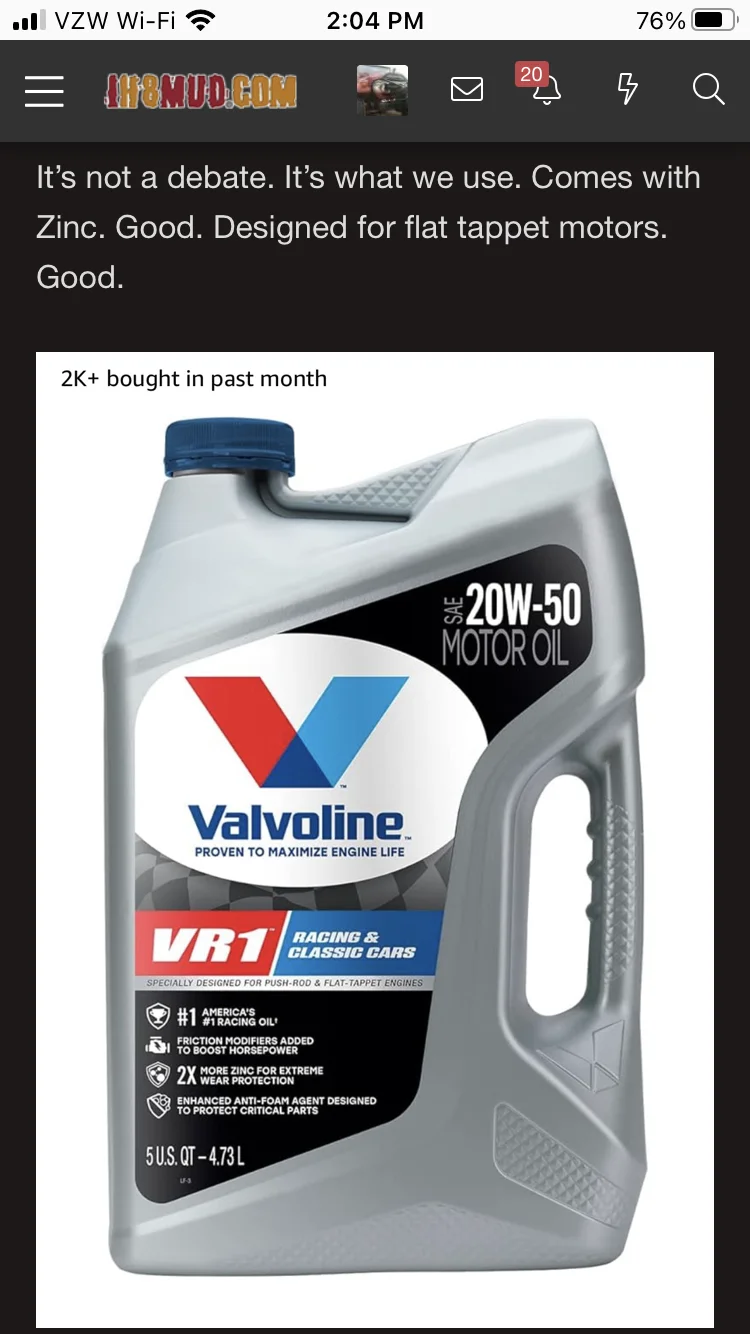

I’m trying to find a picture I saved but many use an oil that has zinc in it for these 2F engines. Not sure about the Toyota oil. @wngrog would know he posted the picture I’m thinking of.
Found it
FYI Kinda funny Nolan just posted over in the 40 section he’s going to use rotella 15w-40 for break in oil and then switch to the valvoline.
I use Rotella for everything F or 2F all the time.
