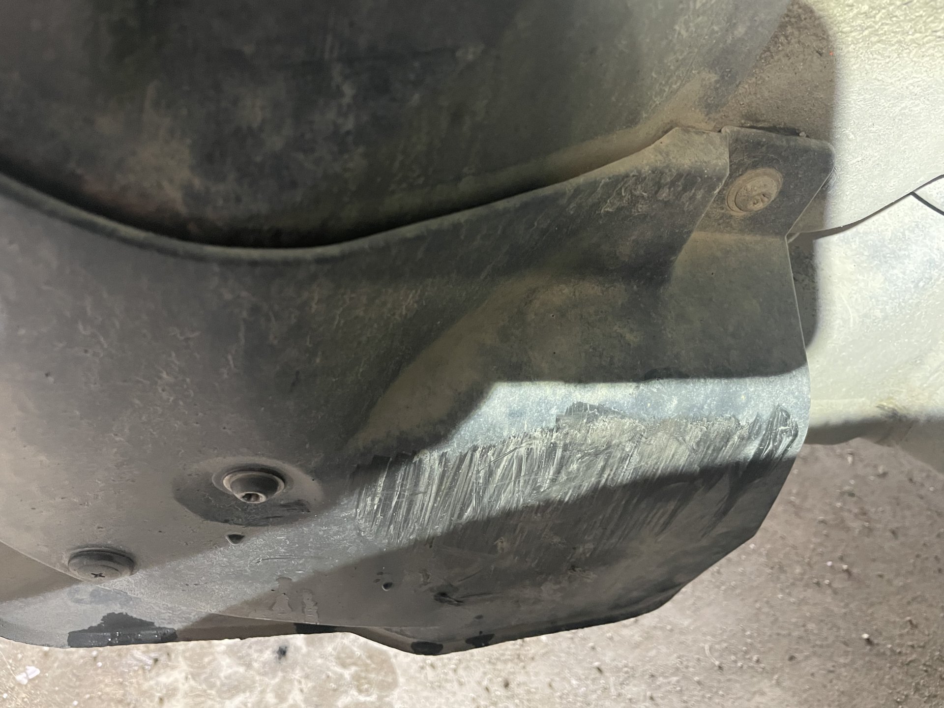

I have 285/70-17 on the +35 Alpha wheels on my ‘13 LX. I had to do quite a lot of front mud flap work, I still may take them off. My 0.02, you will lose more then you will gain going to a 295/70-17 instead of a 285/70-17.

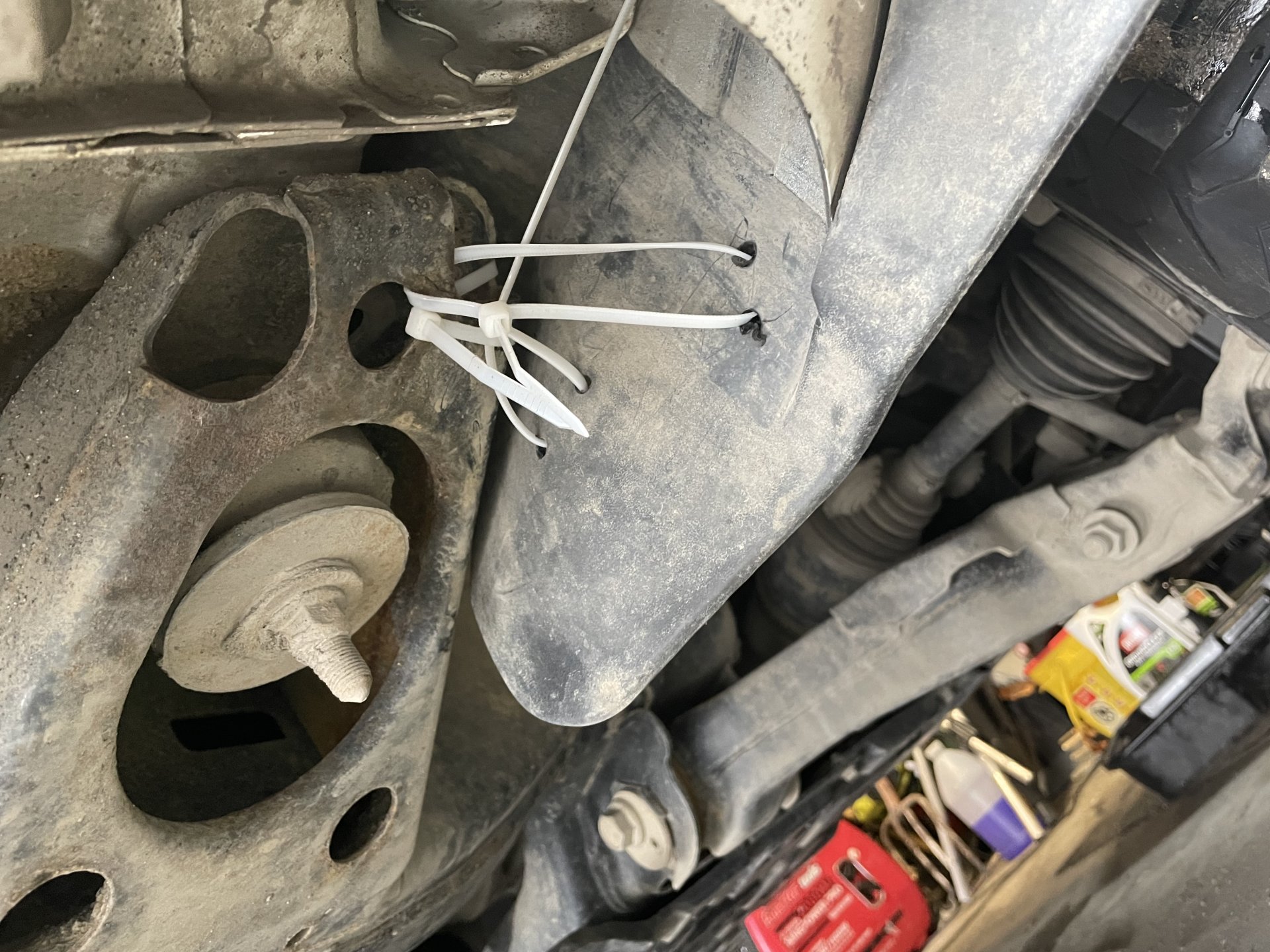

If Cole is referring to the front air dam here, the very very front square of plastic then yes, those def do gotta go. There are options to tuck the front tire rear splash guard but heatgun molding should be enough for anything under 34”. Mine scratch ar full lock in reverse and ive never bothered dealing with it. And i could use more caster too.
I had to work the front mud flap rear of the front tire quite a bit. I’ll probably remove them but wanted to keep them as with the +35 offset my paint would get hammered without flaps. ordered some rally style soft ones from
Amazon.
