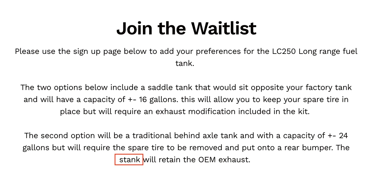

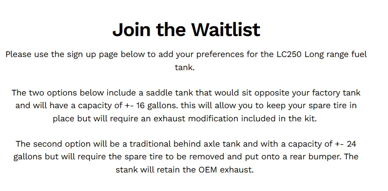

for those who might read this and wish to express interest in moving forward with resolving the most complained about LC250 issue.
LC250 - Long Range Fuel Tank | Long Range America - https://longrangeamerica.com/waitlist/1741898399088x280938273523630080

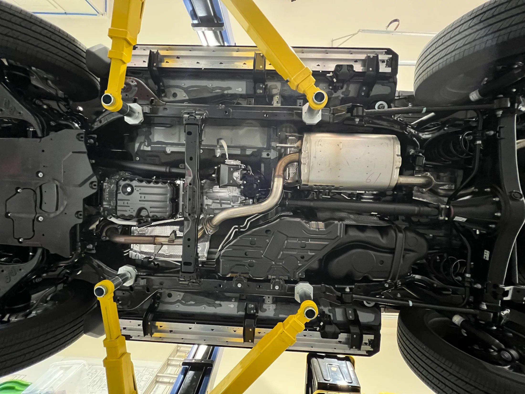

I am very curious to know what the exhaust modification will look like. Where is this gonna go if there is a tank there now?
