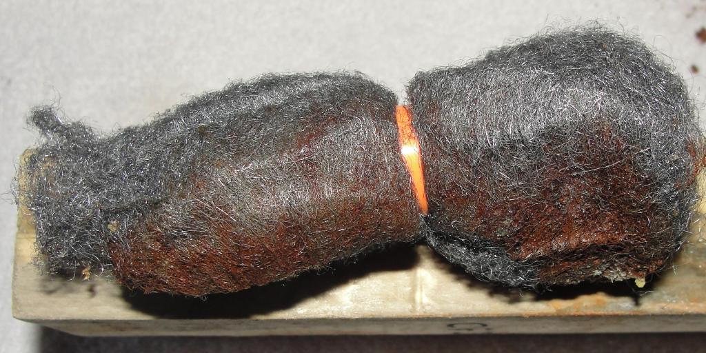

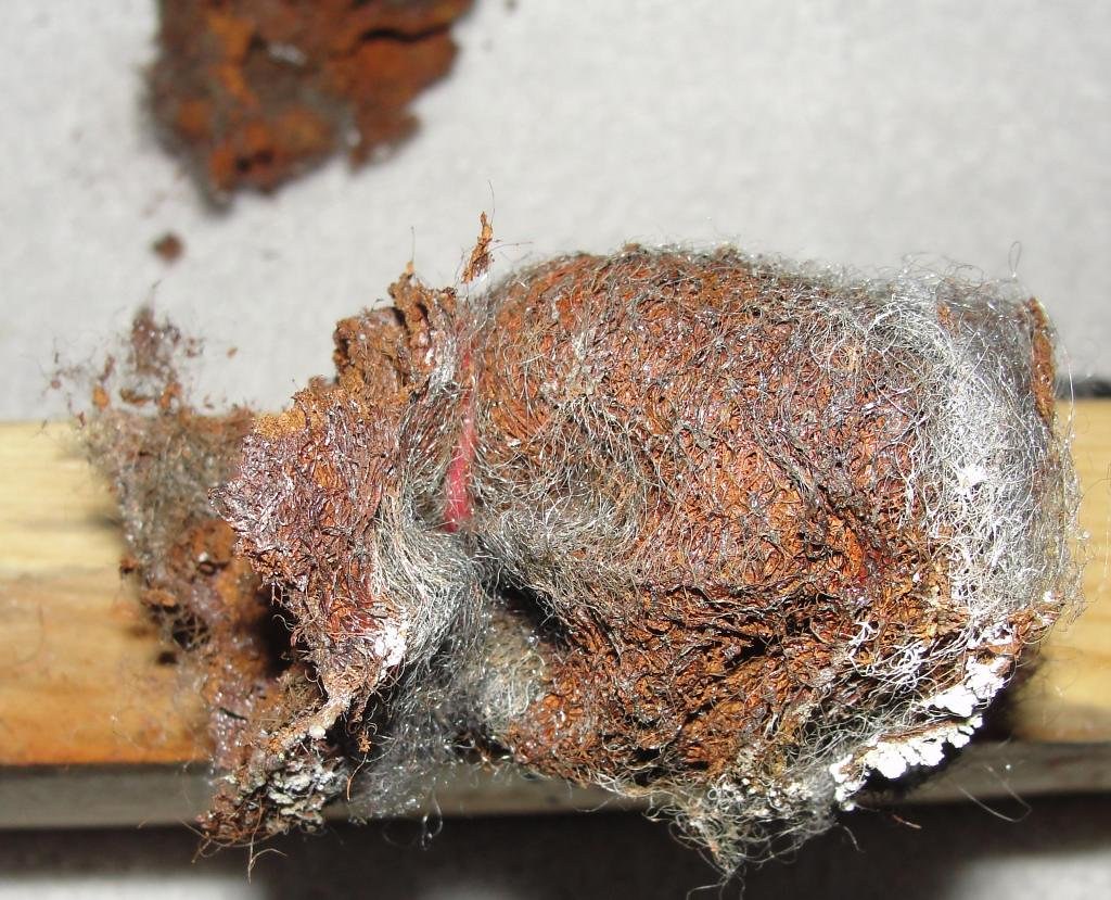

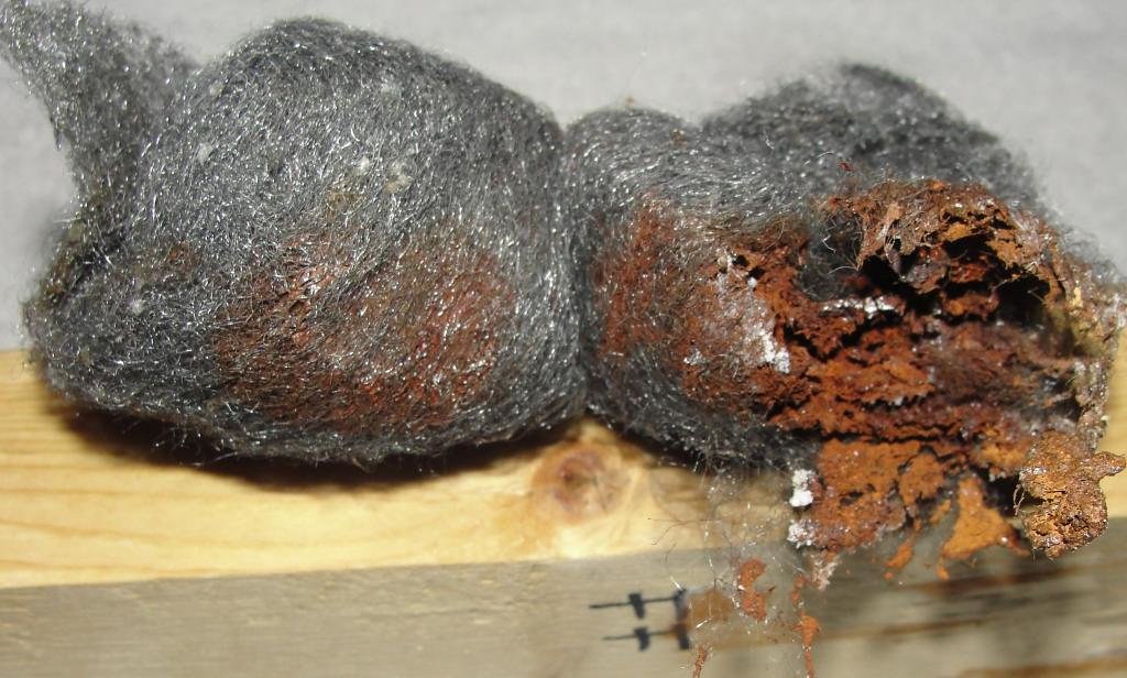

Corrosion Free is what the Canadian military uses to protect their vehicles. It is similar to FF and the first year had my Taco I tested Corrosion Free 3000 against FF on steel wool plus a control piece of wool. Sprayed the wool with a mixture of water and road salt once a week and kept them in my heated garage. Why I park outside, heat is a catalyst for rust. 20 to 30° below zero Fahrenheit not so much.
Control after 4 weeks
CF3000
Fluid Film
Corrosion Free is some good stuff, it is oil based and better than FF. But after the first year it jumped in price and have to get it from Canada so I switched to FF. For 11 years climbed under the Taco in the Fall and did it myself. Still got some rust but better than without it I'm sure.
