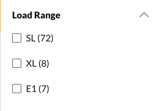

I considered all R18 sizes. There are no light weight LT tires for R18 rims.
Here is the list of Load Ranges for that tire size. SL and XL are non LT load tires. The only LT load is E which are very heavy. Missing is a Load Range C option which is what I desired for the combination of comfort and capability.

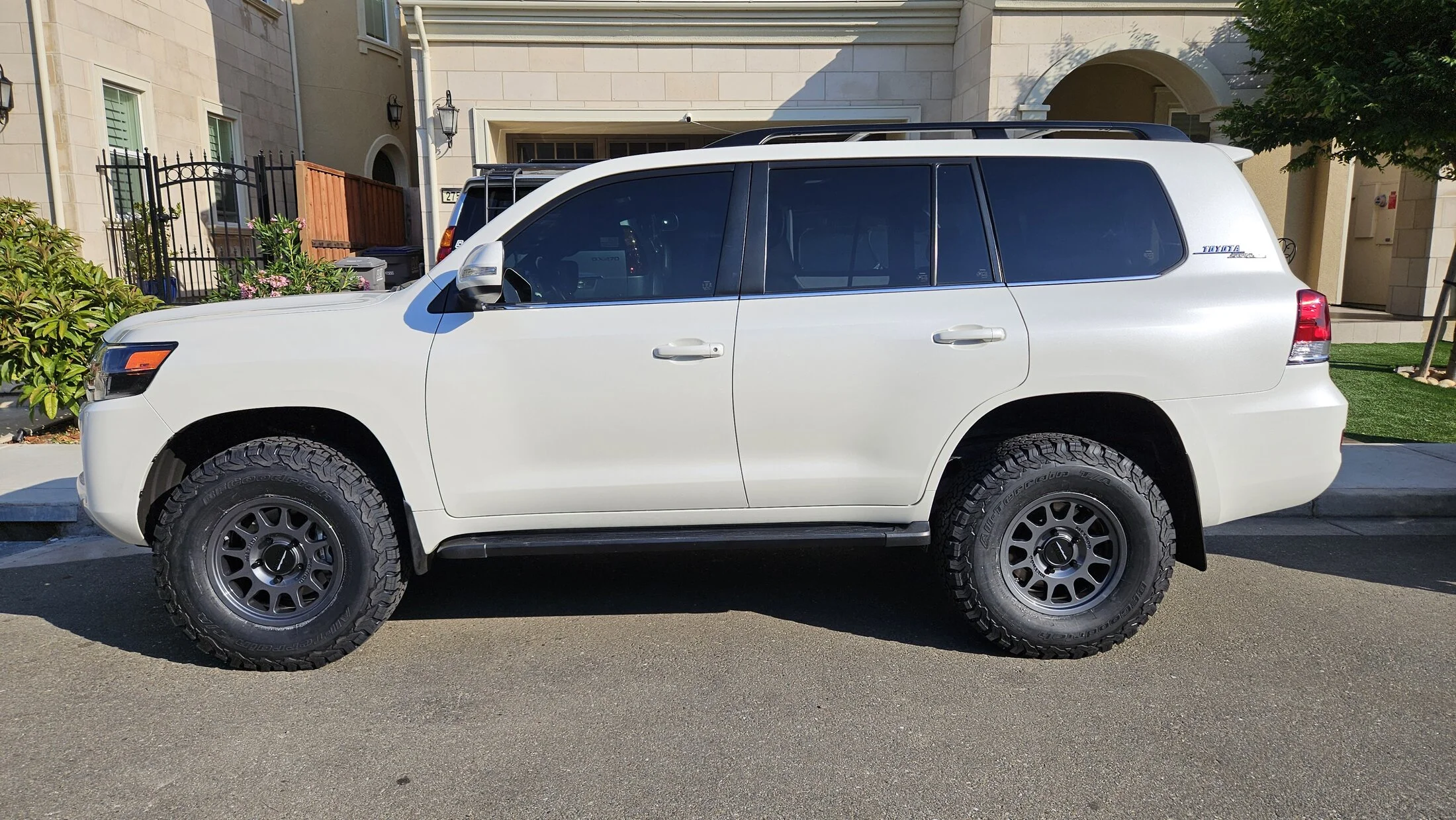

Proud new owner with new 17" Method wheels and 285/75R17 K02 tires. Matching spare coming after Dissent rear bumper is completed.
How was it fitting them?
They fit pretty good with the 35 offset wheels. There was some slight rubbing in front remedied by removing the mud guards and the small plastic pieces under the bumper, I'm not sure what they're called, and using heavy duty cable ties through existing holes to pull front of fender liners forward a bit.
