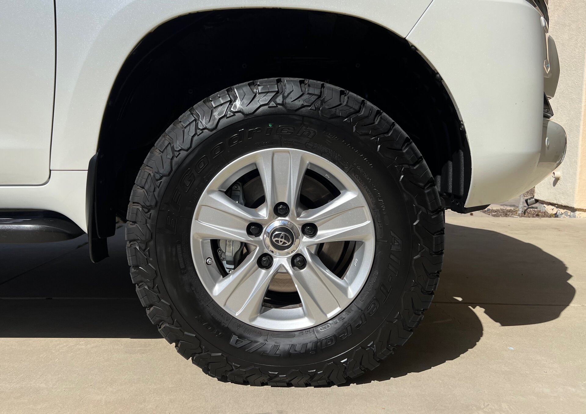

These wheels would not fit on the 2021 HE due to the size of the brakes without spacers. I was not willing to have spacers on the car because they created numerous clearance issues. However, I was able to determine that smaller brake calipers/rotors could be purchased through the USA Toyota Parts website.
MEX SPEC BRAKE PARTS
Caliper (RIGHT) 4773060340
Caliper (LEFT) 4775060340
Dust Shield (RIGHT) 4770360090
Dust Shield (LEFT) 4770460090
ROTOR 4351260180 x2
These brakes are just slightly smaller overall. They are standard on the LC 200 models overseas. Bolt on without modification. Picture below of the 17 inch wheel without spacers installed with smaller front brakes. Tires are the 285/70/17 BFG KO2 C LOAD (stock for Jeep Wrangler). No rubbing on anything (after new UCAs) - no wheel well modification

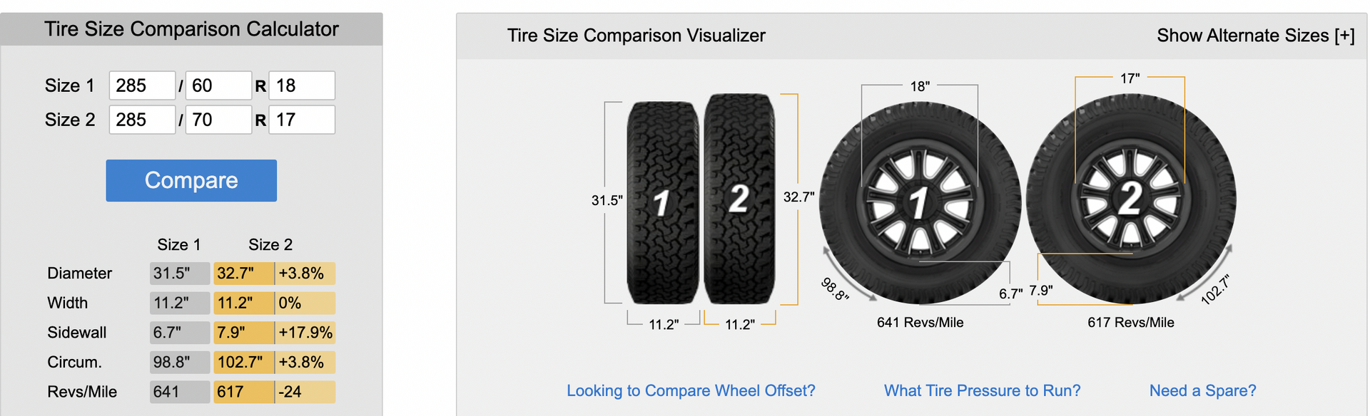

Here is how the tire size compares to stock - including additional side wall.

Curious approach. Downsizing brakes when upsizing tires seems like it's giving up on both ends for stopping capability. Different strokes and maybe useful for future rock crawlers. Wonder if they could get into a 16" wheel?
First time I've heard of someone downsizing brakes. There was likely a reason they increased the size in 2016. Most people go in the other direction.
Agree. It’s not the usual path. These brakes are made for 2016+. They just aren’t available on the USA model but are the brakes used in most 2016+ landcruisers worldwide.
Good question. The rotors are minimally smaller than the USA stock ones so I think the 17 is the smallest wheel that will fit. 17 is the smallest wheel they have available for the LC200 from Toyota worldwide (I think). There is only a few mm between the wheel and the rotors with the 17.

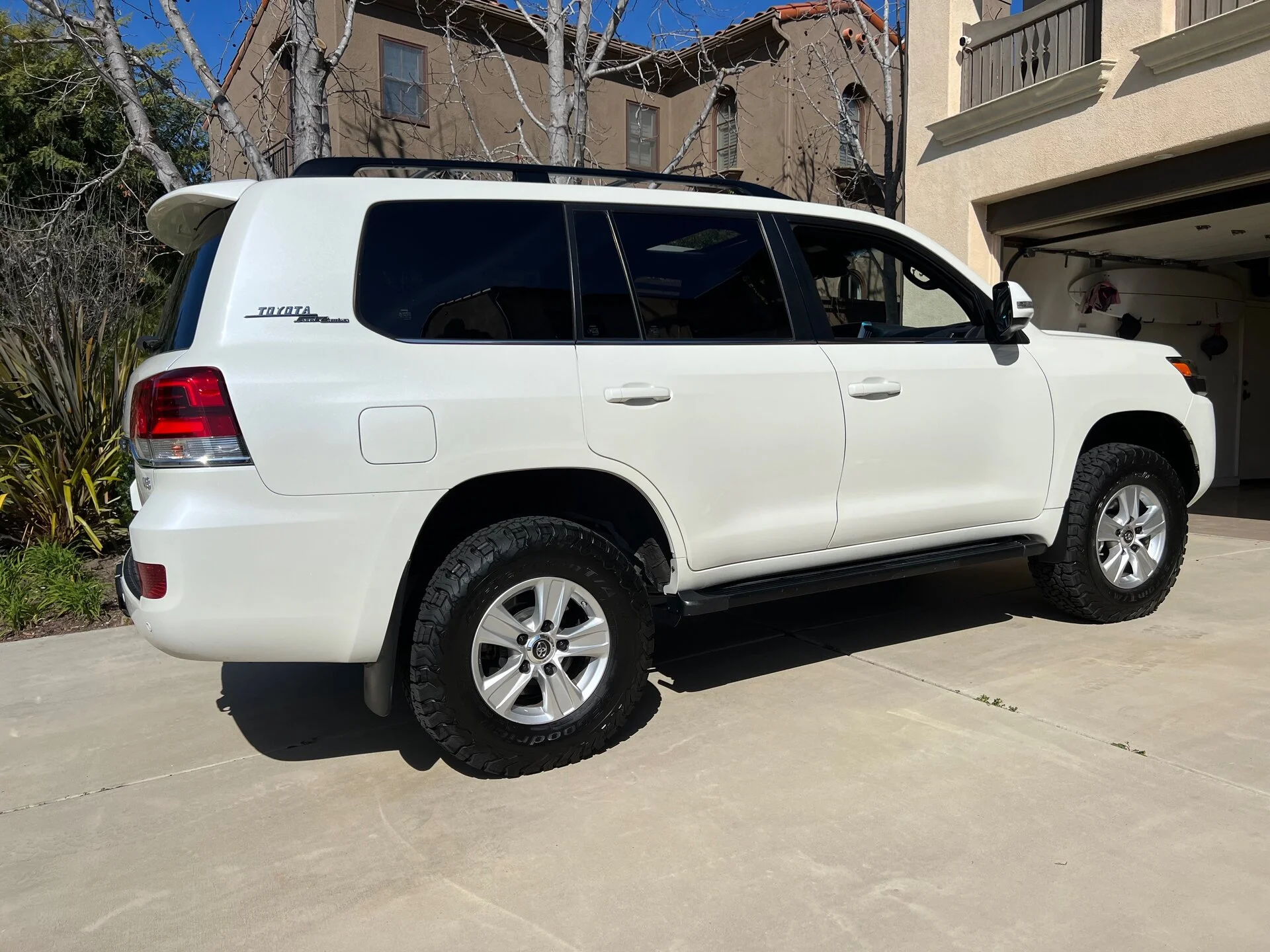

For those of you who have Pre-2016 and may want to buy 17 inch LC rims (without downsizing brakes like I did) from your local Toyota Dealer, here is the version they have in stock. I am using one as a spare. Here is the part number. 4261160641. They are 323 dollars from my local dealer. Your dealer may charge different prices so I would look around.
Here is what they look like.
