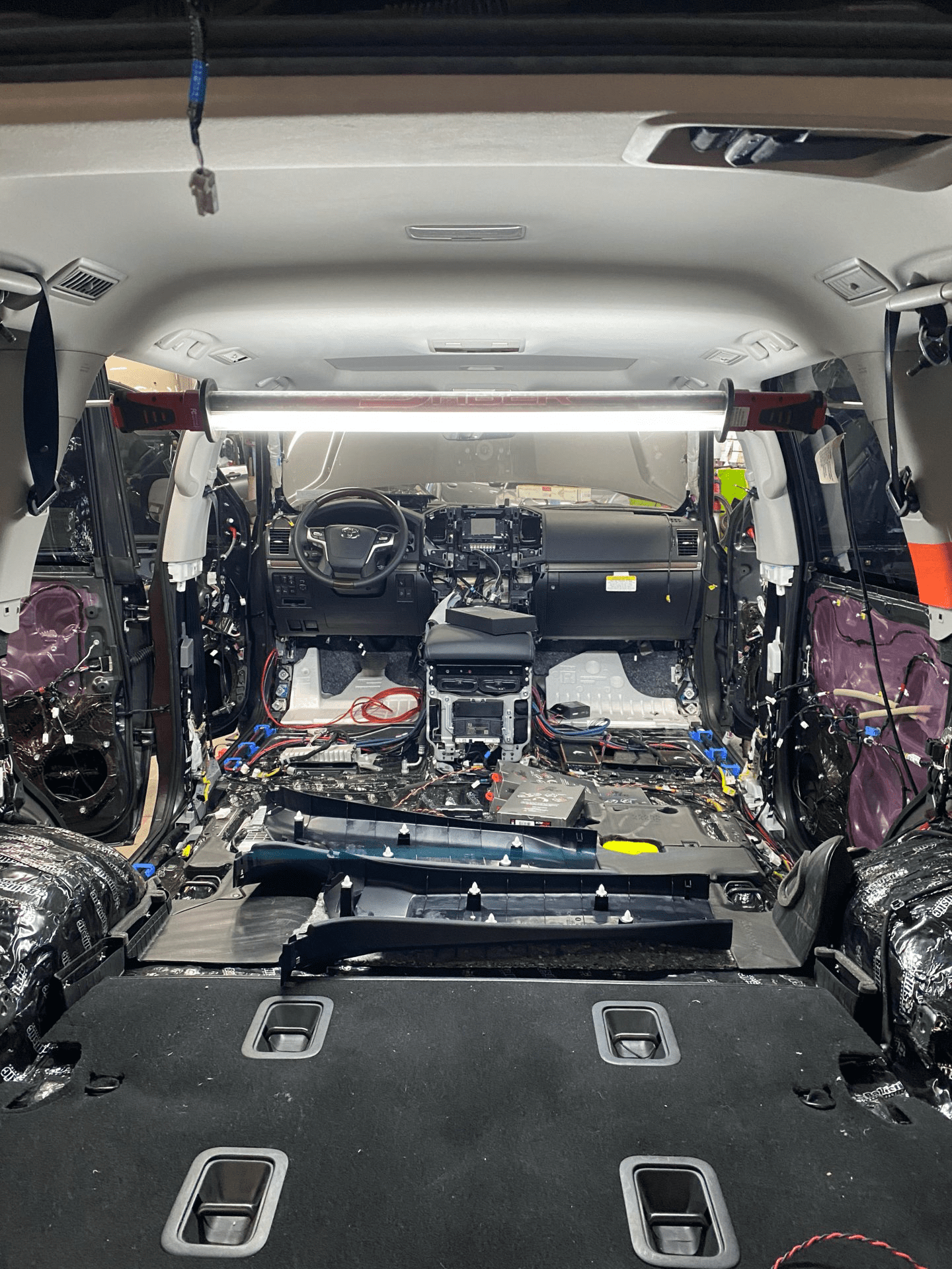

This is from an audio upgrade post by @Eric Sarjeant in another thread. Go for it........

Here is a GM specific MOST adapter. In the above pic it isn’t clear to me if an aftermarket HU was used or not, perhaps the integrator was able to source an adapter To feed signal directly to the aftermarket amps.
I am not a stranger in ripping apart my interior, just compounding informations so I don’t wreck my brand new LC.... LOL!! Can somebody point me to the thread of that @Eric Sarjeant audio open surgery? I saw some pics posted on that surgery but wasn’t able to find the full thread.

Here is the thread where Eric posted several photos. His posts start with #5.
Thanks for the link, I already read through the full thread, was just wondering if there a full build thread for the work.
