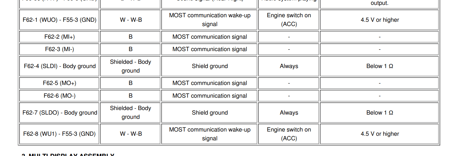

Most of the action is on F58 at the receiver and F55 at the amp. You also get two separate fused power pins at the Amp on the power ground/acc connector, so adding a DSP and one amp is pretty manageable, could reuse the factory wiring maybe.
I see that 6v MOST signal for power on and ACC, it's the newer 6v carrier wave type acc.
What is different is that instead of L and R (edit again, looks like L and R may be the MOST signals on F62, see a couple posts down) (F55 is speaker level outputs that are already filtered probably). Awkward. A competent DSP can mix these signals together (for example the Alpine PXE-850S I'm using can do it) to derive the full range, there is a shield ground in the mix, which will be no fun.
The telematics etc is also there as separate signals if you want to mess with it.

In version 3, I have the 'digital' output hooked up, as my dsp supports unlicensed (CD) digital content. It has a shield ground and it has a very very tiny buzz. If I unplug this line, which I'll be doing next I'm in there, there will be no buzz (verified in dry fit). I thought I'd give it a chance with the vehicle running to dissipate the potential difference; it didn't.
The shield grounds are not at the same potential as the chassis/body grounds and these are problematic because of this. If you see a shield ground in your wiring diagram plan to have to do something to manage it. Maybe replace it with a body ground and orphan it. Or put some resistance on it to drop the voltage difference.
The TLC wiring was bothering me last night. F55 is an "output" connector from the amp, with a bunch of speaker level signals. On my LX, these were all separate from F18, the "input" connector.
So F62 enters the fray.
I don't know what a MOST signal is, exactly, but it sure looks like a low level L and R (edit it isn't, it's a packeted, private protocol). Stick an RCA on these and go to town. Very similar setup to F18 on the LX. What is different is that F62 is the power connector as well, and this is a completely separate connector on the LX.

Hmmmmmmmmm. The Alpine PXE850 has an optic in . . . . but it's a pretty expensive gamble. Also there are two MOST lines, if they've gone to optics no reason to run multiple channels, it won't be bandwidth limited. Internet is being obstinate with me on MOST. I did find an AVC-LAN whitepaper, but this is different.

MOST (Media Oriented Systems Transport) is a high-speed multimedia network technology optimized by the automotive industry. It can be used for applications inside or outside the car. The serial MOST bus uses a daisy-chain topology or ring topology and synchronous data communication to transport audio, video, voice and data signals via plastic optical fiber (POF) (MOST25, MOST150) or electrical conductor (MOST50, MOST150) physical layers. (source MOST Bus - Wikipedia)
I read it as a Ring network which utilizes a continuous data feed to the devices in the network which feed back to the primary controller. This allows the head unit to know if the amp or any of the speakers are non-functioning, ie open load, as well as control voice from the phone input, HDD, CDs, DVDs, etc.
Finally, a reason to buy an LX over a TLC:)
"If you look into MOST, you'll find it's basically S/PDIF multiplexed onto a packet ring network, with a bit of additional control information and low speed side channels added."
