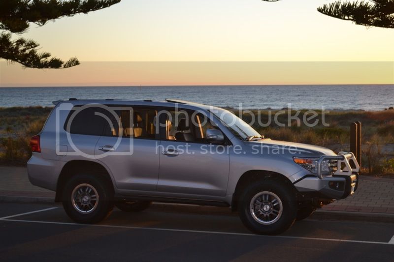

Hey - same look :D
Only I'm running some Local Bridgestone D694 AT's in 285 70 R17.
Cheers
Steve
Adelaide, Australia.
Very nice, Steve!
:cheers:
