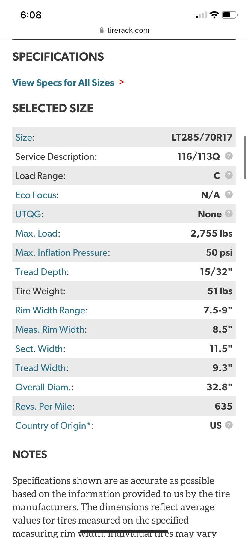

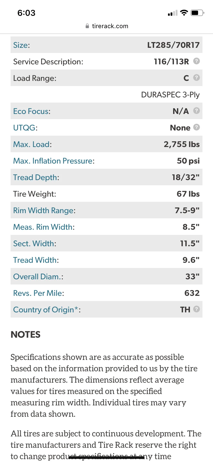

Might anyone be able to explain the difference in these tires?
With falken both seem to have a 50 psi max with similar load ratings…with one being markedly heavier.
I assume this would indicate the load c adds a bit of sidewall toughness…
But by the same token the lt285 70 load c k02’s weigh about the same as the euro metric falkens…
Is this an indicator that the sidewalls on the eurometric falken might be comparable to the light truck load c k02…and markedly thinner/weaker than the load c falken’s?
Does this mean that the load c k02’s are markedly weaker than the load c falkens?
falken load c
Falken euro metric
K02 load c
Duraspec 3-ply and 18/32 tread depth vs 2-ply 14/32. It's going to be a tougher and more aggressive setup and getting a lot more tire with 28% more rubber.
Depends what you're looking for. Me personally as an avid off roader, Id choose Duraspec. It's pretty dramatic in person as I had the previous AT3Ws in a couple sizes with a narrower spare. Way deeper treads and side lugs.
It's why I don't fault Falkens weights when compared to a typically smaller and lower profile KOs.
Trade is probably longer tread life, tougher, likely similar ride with 3ply offset by more tread depth, some fuel efficiency loss
I don’t mean to be argumentative…but
The passenger tires hit the load carrying minimums for our vehicles at very very low psi’s (like 26)…whereas the light truck tires need like 40+ psi I think.
33 psi in the passenger tire would likely be dramatically more damped than the 42 that is recommended on the light truck, correct?

if I remember correctly, the lt285 70 17 load e k02’s that came as a standard option on the lc200 had mixed information regarding their recommended tire pressures, with the highest being 42+ (the rock warrior tundra, I think, had a recommendation of 46).
In your off-roading experience, have k02’s been subject to more sidewall damage than other, heavier load range c tires?
My understanding is that some load e tires, for example the michelin defender, are extraordinarily lightweight compared to others (42 lbs vs 58 lbs for the k02 version iirc) because the k02’s have thicker sidewalls specifically for Offroad durability rather than load carrying capacity as is the case in the defender.
My suspicion is that some passenger oriented tires, too, have thicker sidewalls for Offroad purposes…as many of the 285 70 17 passenger tires fall in the mid 45 lb range with the falken being an outlier at like 53 (comparable to a k02 load c)…
falken passenger 285 70 17 also offers a 50 psi max, comparable to the load c k02.
In your off-roading experience, have k02’s been subject to more sidewall damage than other, heavier load range c tires (many in the high 50-mid 60lb range)?
Or, similarly, any particular PASSENGER tires being quite strong in the sidewall?
There doesn’t seem to be a lot of tests/data on the actual carcass/sidewall strength of passenger vs light truck tires of various construction/application…we basically just go on vague manufacturer descriptions and anecdote/experience…
My goal would likely be a k02 load c grade passenger tire…essentially looking for maximum road comfort/damping/handling/rain traction in a tire that’s not paper thin in the sidewall and will pop easily if I hit an odd root Offroad…a load c that doesn’t necessitate, possibly, 40 psi…I’ve run 35 psi and 40 psi in load d 35” tire and load e 33” (on 20” rim)…
The 35” lod on 35 psi is acceptable…33 psi on it feels pretty good though on the highway it is a bit more wallowy than I’d like (better than my wrangler on stock tires though). The 35-40 psi in load e 33” 20’s was unacceptably harsh.
33” passenger tires on 20’s was reasonable at oem 33 psi but felt best damped at 28-29 psi.
Across all these tires, each experiment chasing the perfect tire is kind of expensive-$600-$1200…I guess I’m trying to do as much thinking, research, and discussion with others to get their experience so I get it right.
Supposedly I could run 26-50 psi in these falkens…they’re relatively lightweight…I suppose I’m wondering about sidewall durability mostly.
KO2s are tough tires and will put up with good abuse. Any tire can be damaged and punctured, with usage and driver being a factor in this. To answer your question, I've firsthand seen 4 KO2s taken out, but they are also the most represented tire in the groups I run with. I still trust them as robust tires.
KO2s are also stiff and known to not have the best NVH. It is this quality as experienced on my previous LX470 that my brother now owns and installed KO2s on, and not robustness, that turns me away from them.
Long way to say the same pressure on different model tires is going to result in different experiences. More rubber and deeper tread can contribute to smoother rides. Different sidewalls may need different pressures to tune for ride quality and sidewall stability.
More reasons why RCTIP is misleading and should serve as a starting point to tune from.
For tire robustness, tire construction and number of plys is a big part of it. But there are nuances too. Deeper tread, rubber compound, cord and ply material, type of surface. What works for one person in one situation may not work for another so it would be hard to answer if a solid AT tire in SL passenger car size is enough.
this seems key. I found a video comparing an sl variant of the Nitto recon grappler against its light truck variant of the same size…and the tires flex was significantly different at the same pressures…as well as its compliance (damping I assume).
It’s too bad there isn’t a repository of tire deconstructions on YouTube…it would probably get a reasonable amount of views…I’d like to see a cutaway of whatever the extra falken “turn up” ply looks like compared to the 2 ply competition in standard load…as well as how hard it is to tear the material…it SEEMS like they’re trying to market a “tougher” sidewall’d SL tire than the competition for people that want a max durability SL tire but don’t want a light truck tire.
