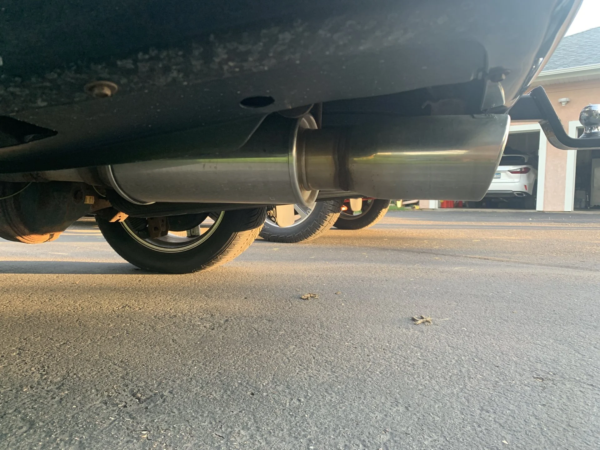

Installed a Dual in Single Out MagnaFlow #12288 today along with a Vibrant #1142 Ulta Quiet Resonator & DC Sport 4 inch Resonated Exhaust Tip.
Bought the parts off Amazon for $260 total. Had it installed today at the shop for $240 since it was 3 new parts welded. $500 total.
I gotta say, I love it. Just enough roar when you want it but quiet on cruise control on the highway. The new resonator and tip help kill the drone so it’s very light at 1500 rpm but no where else.

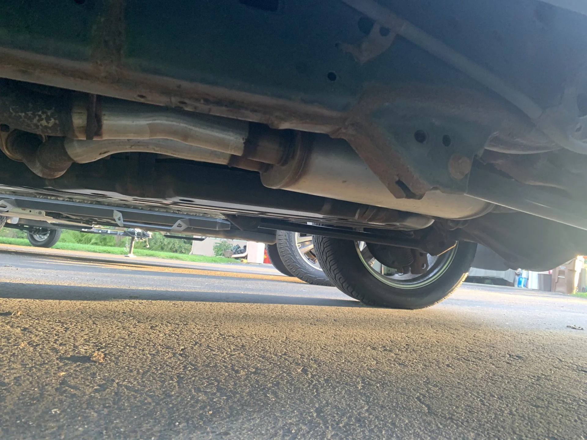

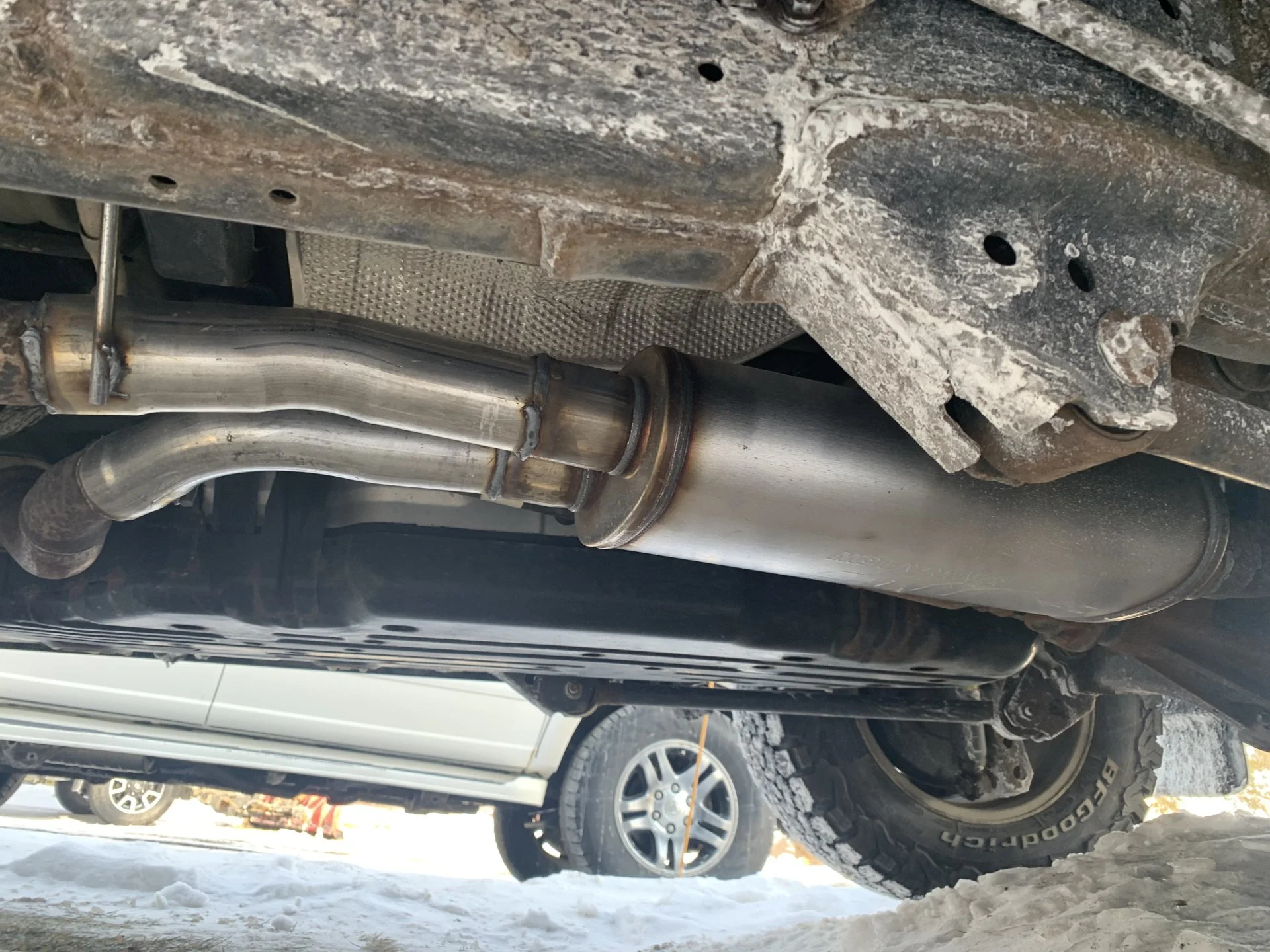

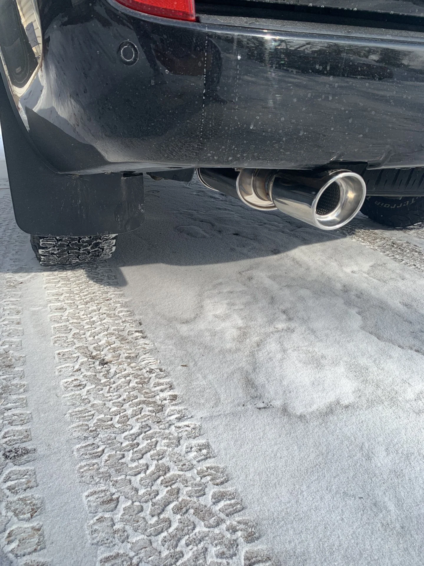

Here’s some pics of the new muffler in the middle, new rear resonator and exhaust tip.

Outside view of the new muffler and exhaust system. Feel and hear the power of extra 10 HP 🙌🏼😉

Magnaflow in the middle
Resonator and resonator tip at the end
