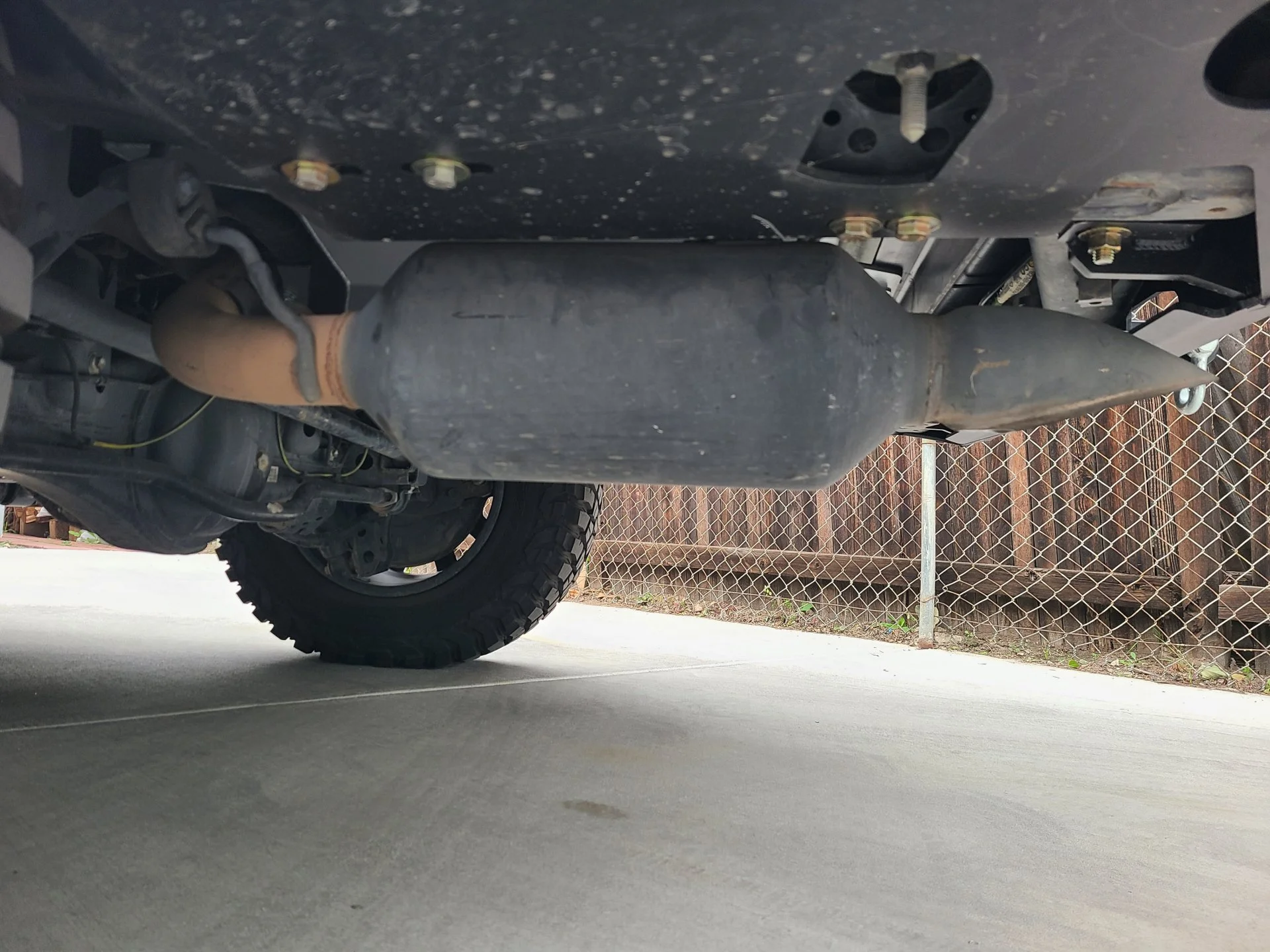

People cut off the rear resonator (the part past the axle). The muffler is in front of the axle. Most people say there is no difference with or without the resonator.

Not removing cats or muffler! Just the rear bulb.

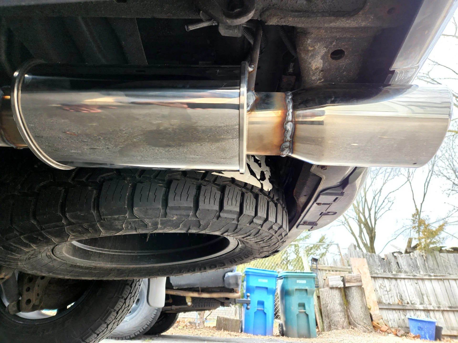

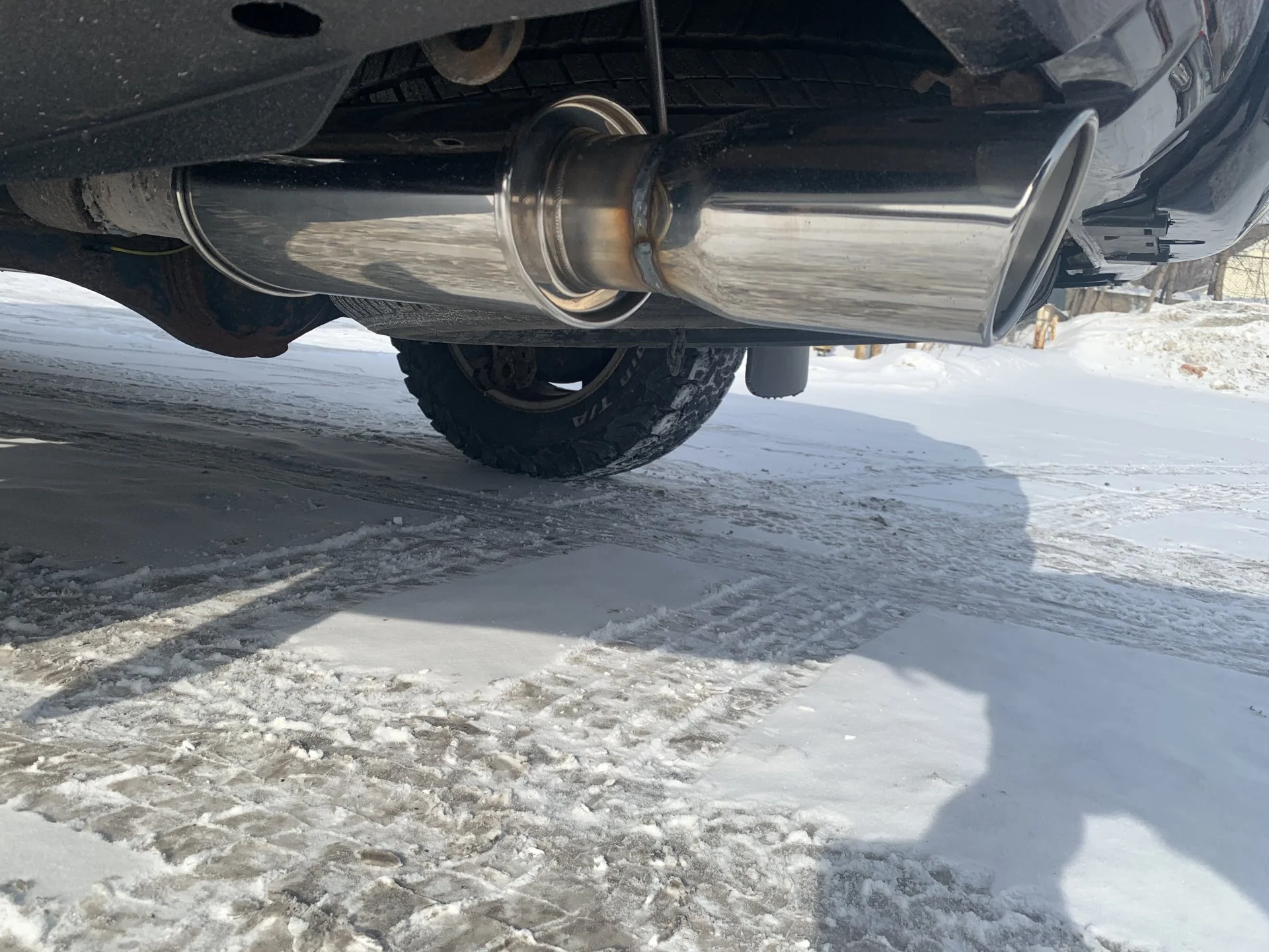

Stock OEM
Vs
Vibrant 1142 Ultra Quet Resonator & DC 1013 Resonatored Exhaust Tip
The two parts helped stop the drone from the Magnaflow and also made it get even deeper/cleaner sound.
And 10 more horsepower

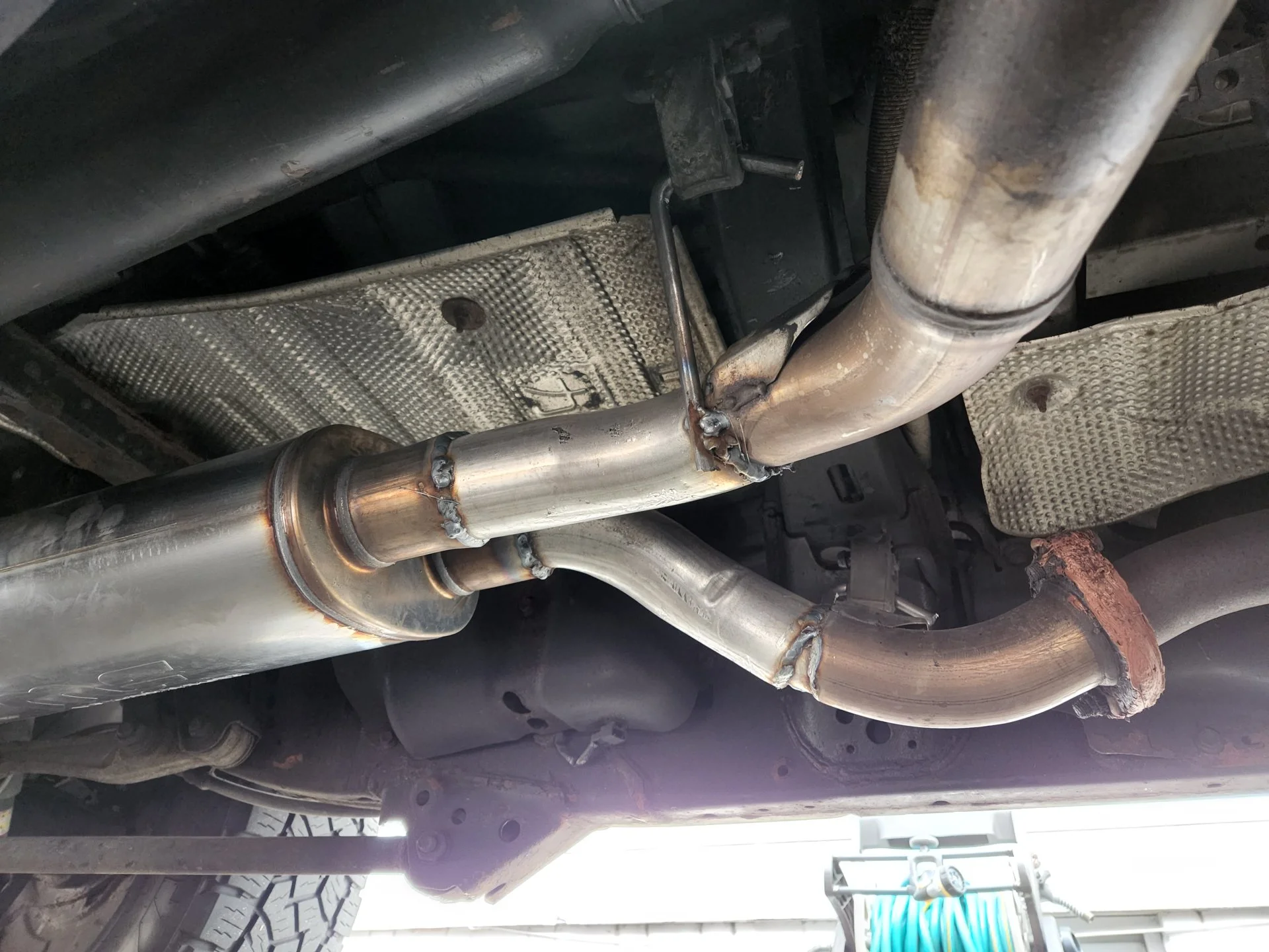

Well got it all installed today. How did you figure out that combo of muffler and resonator w/ tip? Sound is identical to yours( had issues posting video). Hell I hear my Gobi roof rack more then anything on the highway. Welds could of been better but it's all solid, not leaking, and unseen. Sounds good paired up with the k&n intake. Is it helping out the mpg? Probably not but it's all about the miles of smiles right? My shell gas card can handle the rest. Now to the lift.... Thanks again. 2008 LC 215k

I just thought that the resonator with the resonated tip would help kill the drone the Magnaflow gives you. But I love the sound bro! I’m glad you like it as well. It looks great as well.
Once again thanks for posting up the part #'s. I can definitely vouch it sounds great and not overwhelming and very tolerable. Sweet and subtle. Cheers
