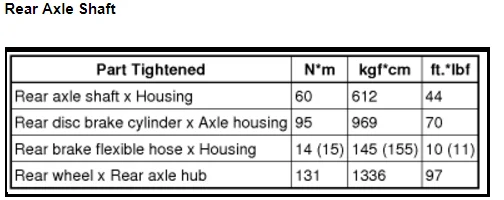

Here are specification to check the runout.
