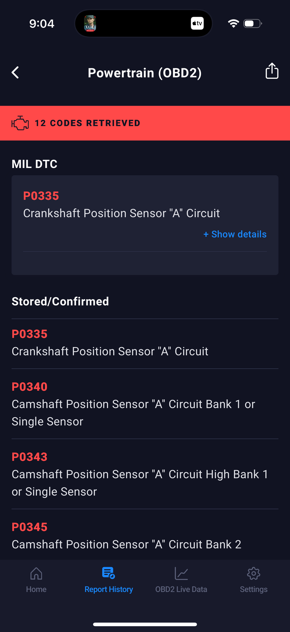

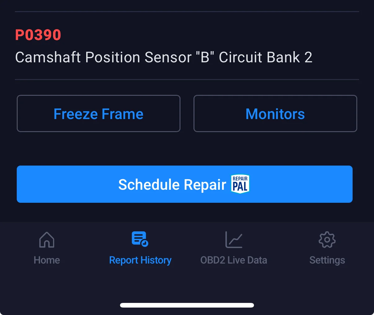

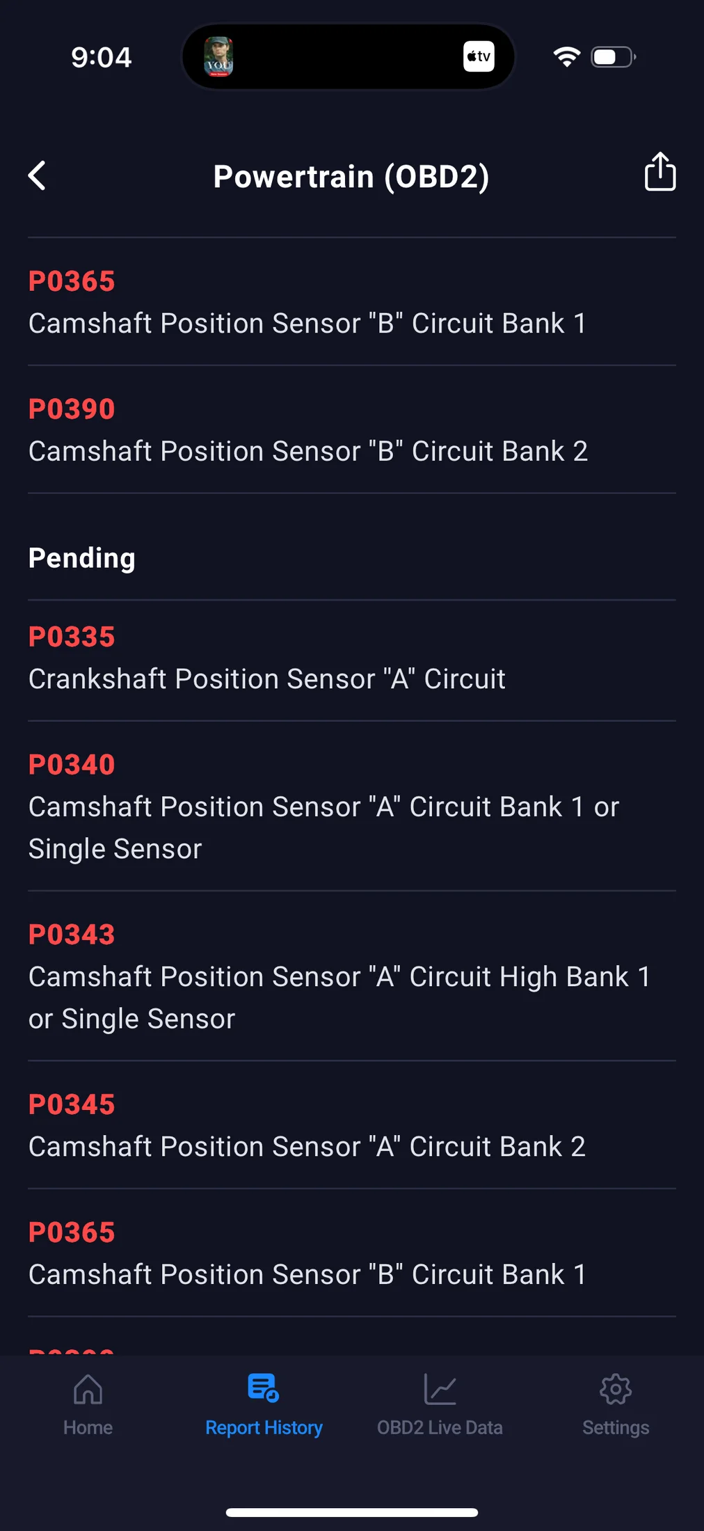

Help 2008 Land Cruiser Crankshaft and Camshaft sensors all went out at the same time?
May 7, 2025
1
9
NC
Not sure how it’s possible for all sensors to go out at the same time - truck not running. I’m thinking this might be a timing chain or starter issue? Anyone have experience with this issue? How did you resolve the problem? Any recommendations greatly appreciated.

I had been driving with P2714 codes for months without issues. Then one day when I started her up she didn’t sound the same, like dragging a steel plate over another steel plate. She started four time like this before dying.

Well, don’t go throwing a starter at it until you have a known good battery, connections are tight, and your power to the starter is good.
Those sensors did not all fail at the same time. You either have an electrical issue, or the engine has jumped time.
Pull the engine cover and check for rodent damage to the wiring engine wiring harness. Check the whole length of the harness from the sensors to the ECM.
Get under the truck and take a 22mm socket and 1/2” ratchet and turn the engine over 2 revolutions via the crank pulley bolt. Does it turn?
Final update: LC is back! New OEM starter in (new starter was smaller than original which was strange but made putting it in more easy). Battery was tested and charged up. All electrical wires checked and terminals cleaned. Next project is to change valve cover gaskets, spark plugs, tube seals and some brittle hoses. :doh: Thank you all for the tips and comments. This was my first time posting and I learned a lot. Until next time. :flush:
