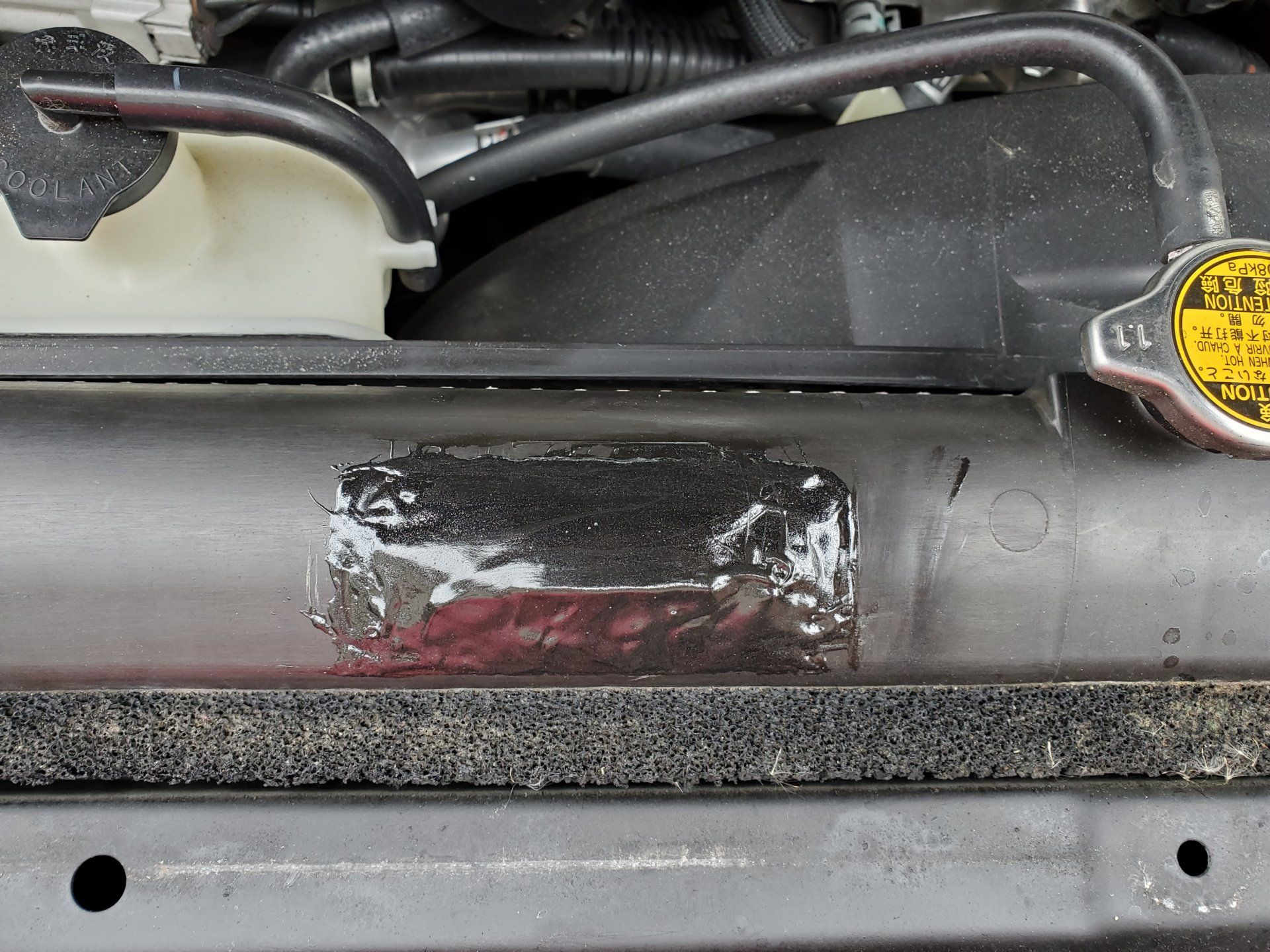

Just bought a 2018 LC, wanted to add another data point to this thread. Here's my radiator @ 52,000 miles. Looks like old design. No crack yet.
Not pretty but its reinforced before any cracking occurred. We'll see if it lasts.
I might try to clean it up or add another, smoother coat tomorrow. If I had it to do again, I'd let the epoxy (JB Plastic Bonder) set a while before applying it so it wouldnt run and drip.
3 months and a few thousand miles since my sloppy, pre-emptive reinforcement and its holding.

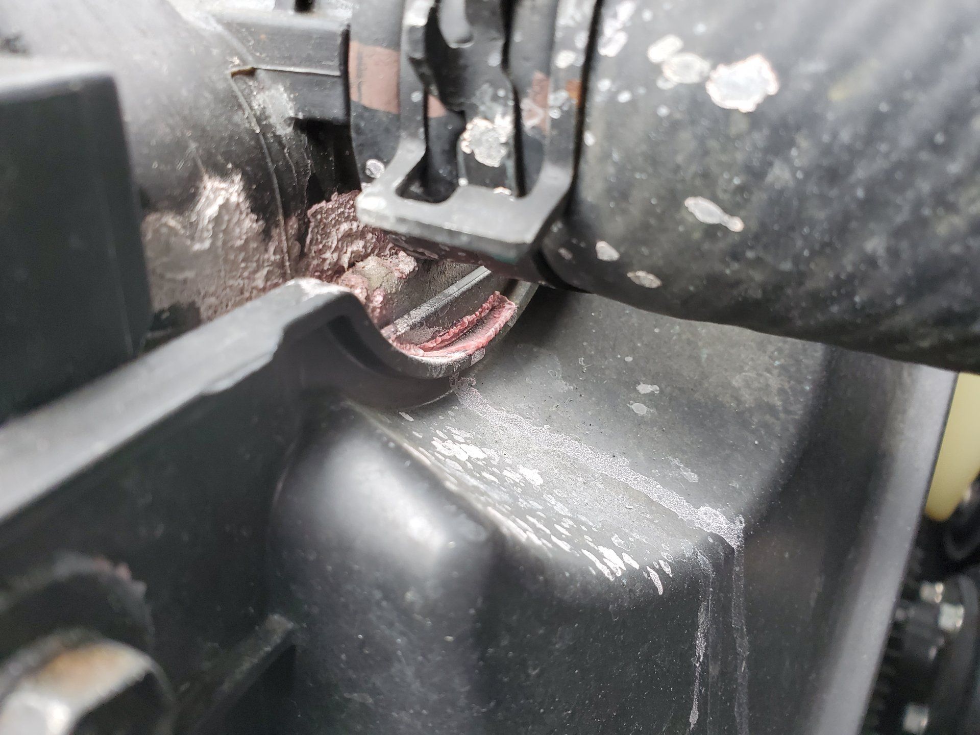

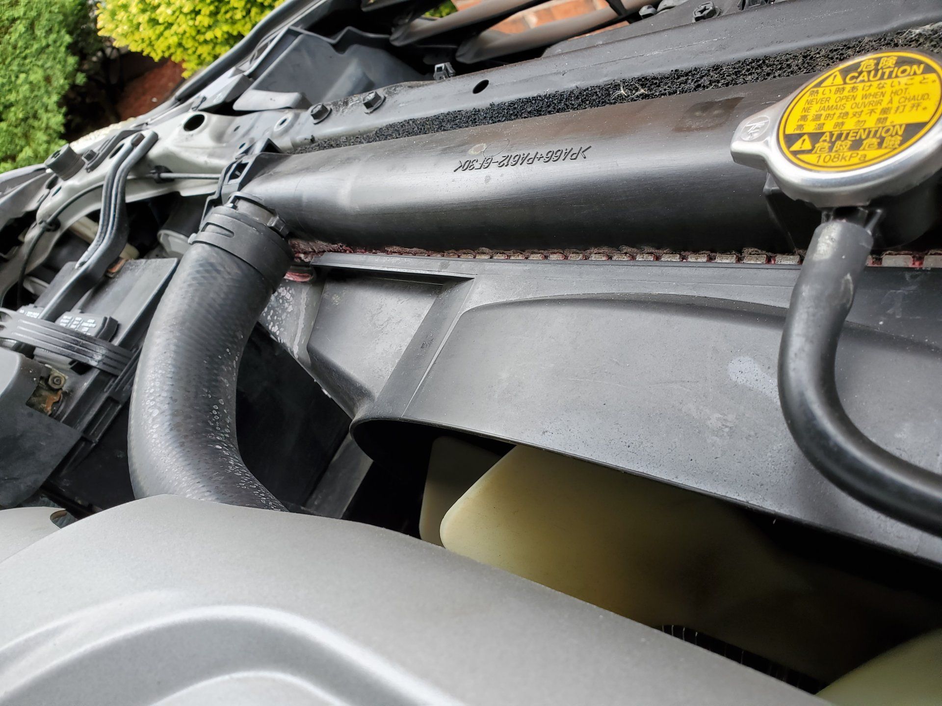

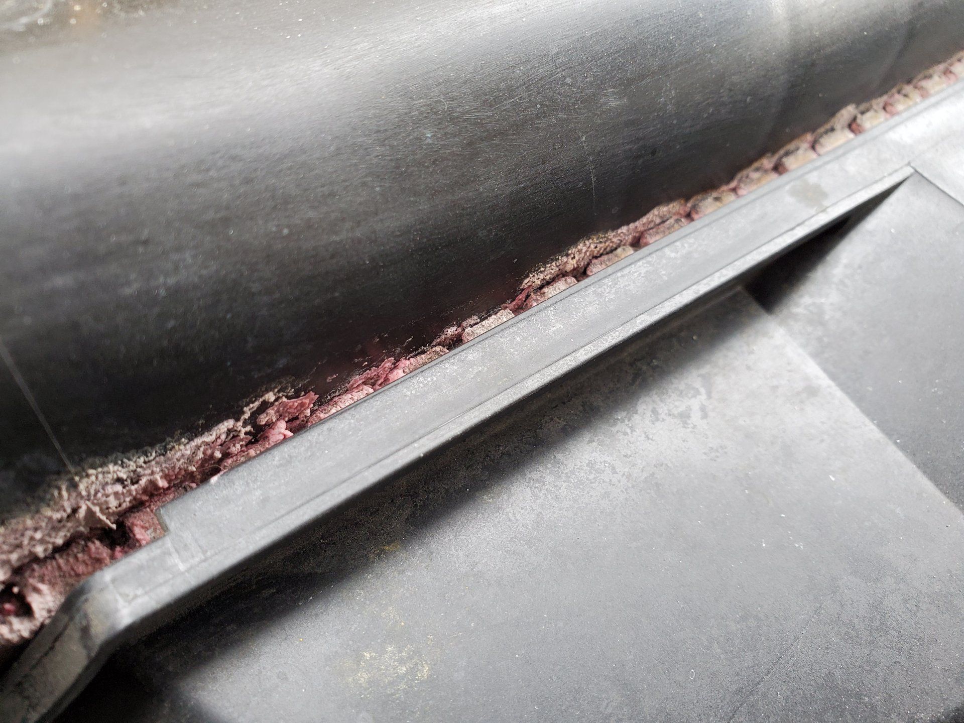

Well I just joined the club of the owners who did their own replacement.
Initially I did the epoxy repair about 2k ago and it held up beautifully, however... I found pink crusty stuff while looking for something else right at the upper edge of the aluminum / plastic junction (from the engine bay side) and decided that my experiment was over and not worth waiting for things to go south.
New radiator it was.

A couple pics of the situation below:

How many miles? That radiator was due to go, based on both the crust and the color of the top outlet. Most of them posted here don’t get that bad..

Isn’t that just a leak at the hose? Which then ran down the length of the Fins?
142k - truck spend 99% of its time near Dallas Texas so I'm sure it worked some overtime with A/C on.
The inside of the radiator was very nice and clean.
No the hose was perfect and no sign of leak - most likely air forced the pink stuff up the plastic neck from the edge below.
