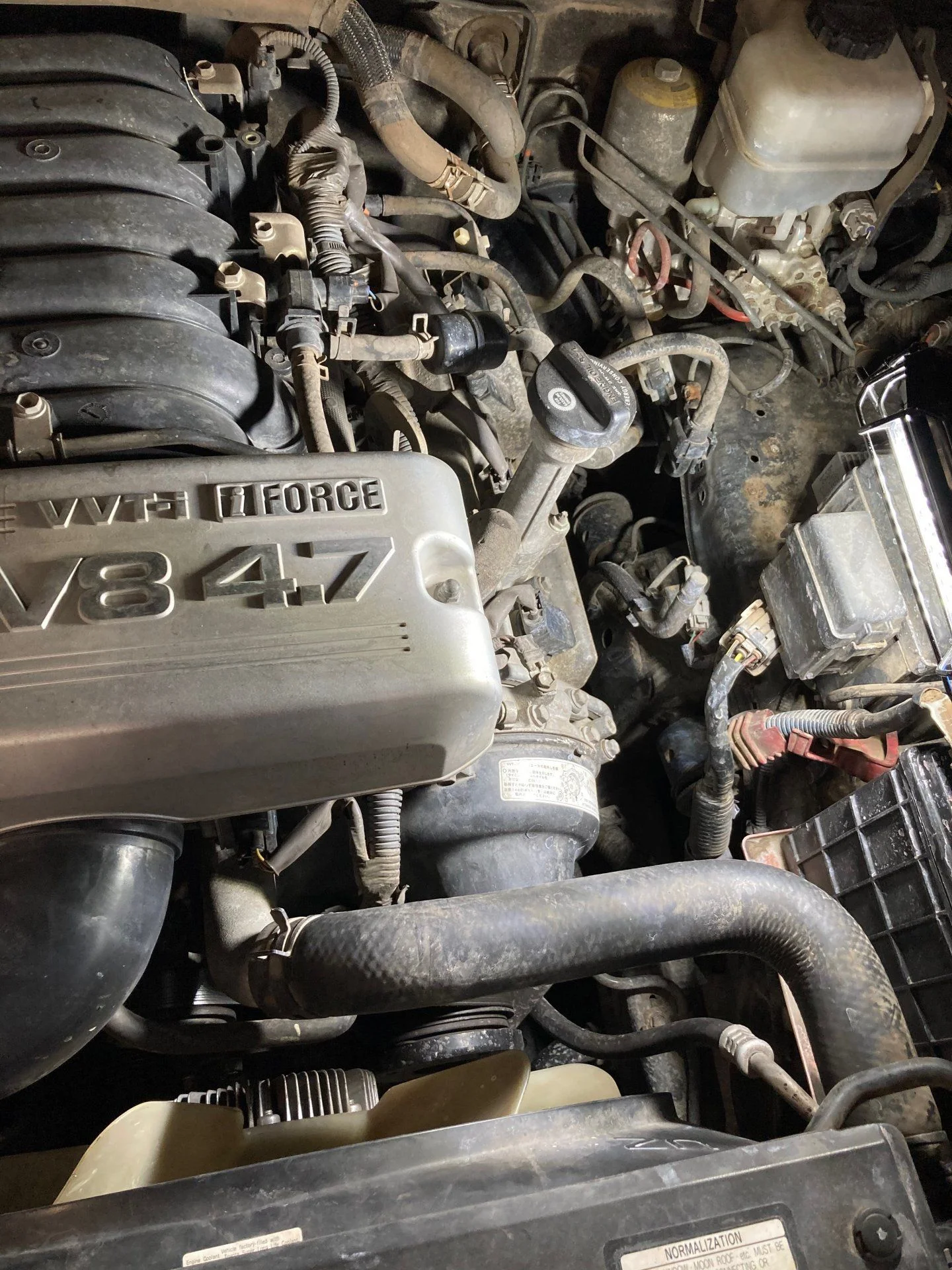

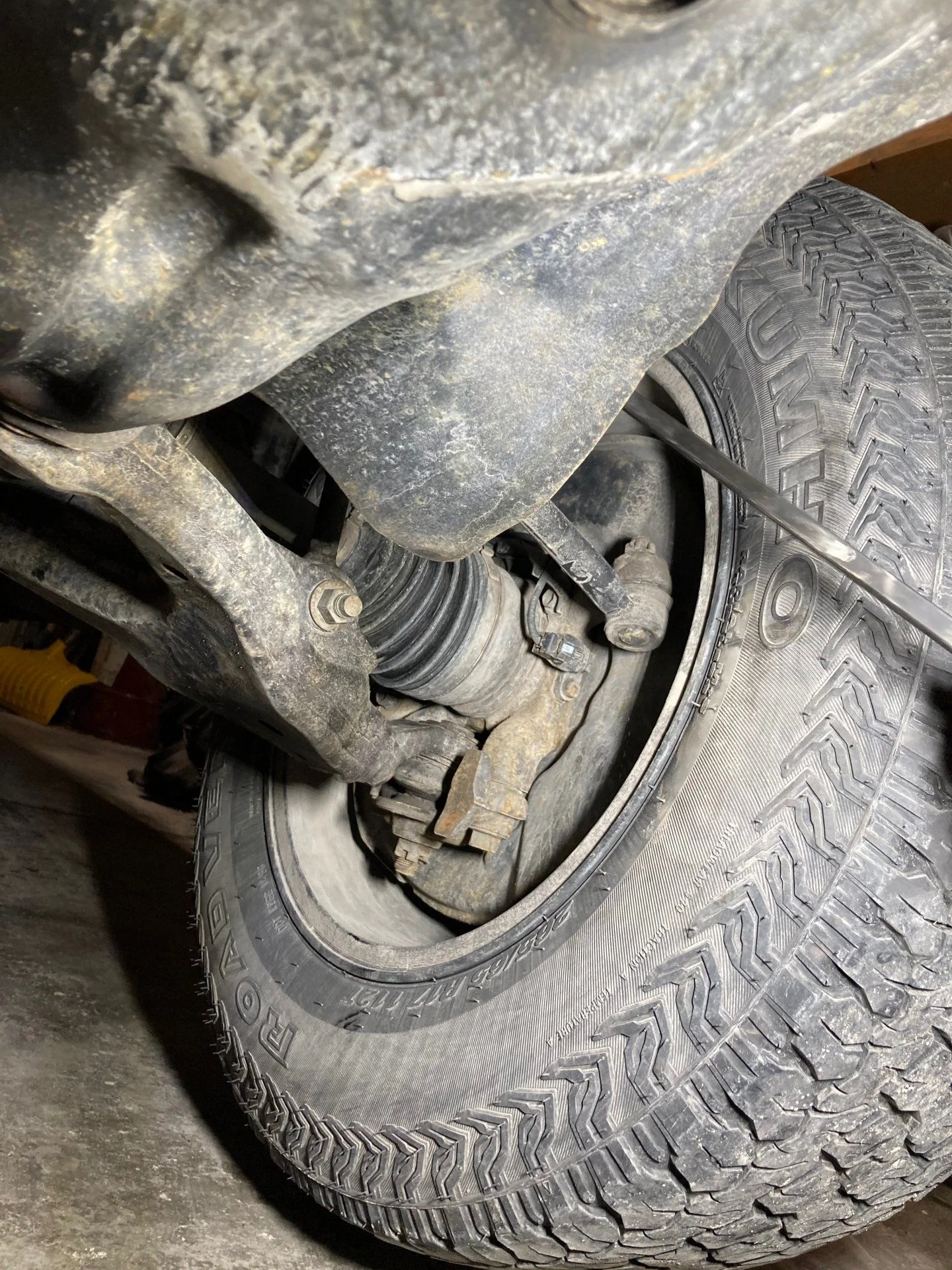

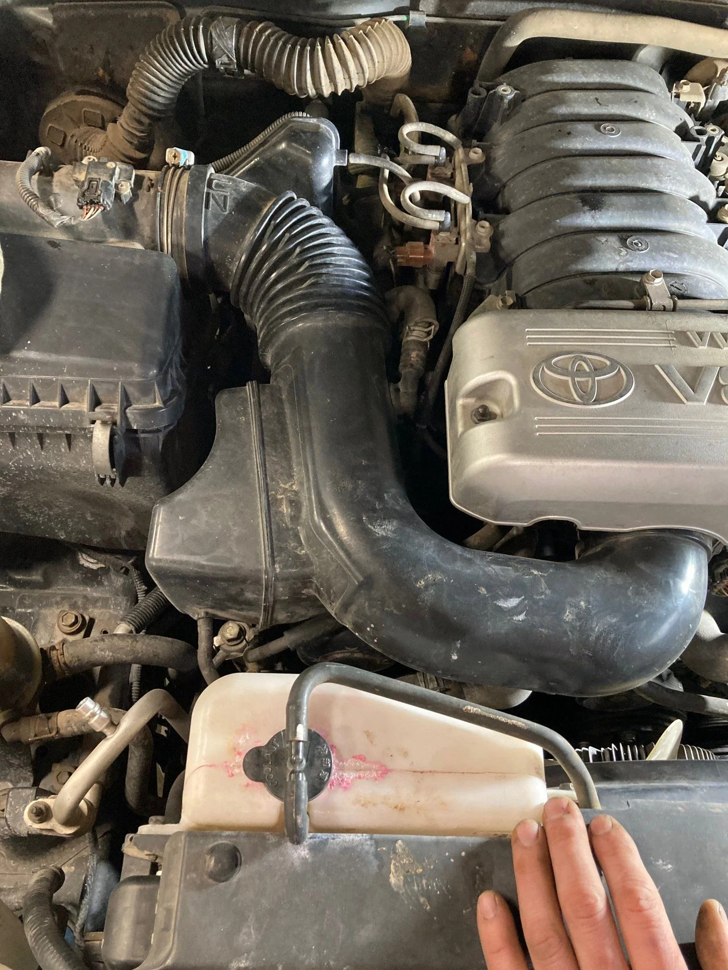

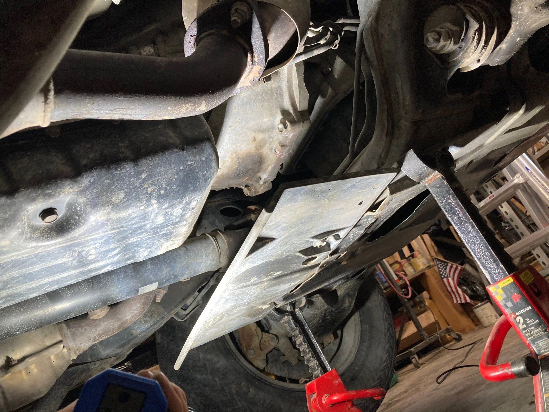

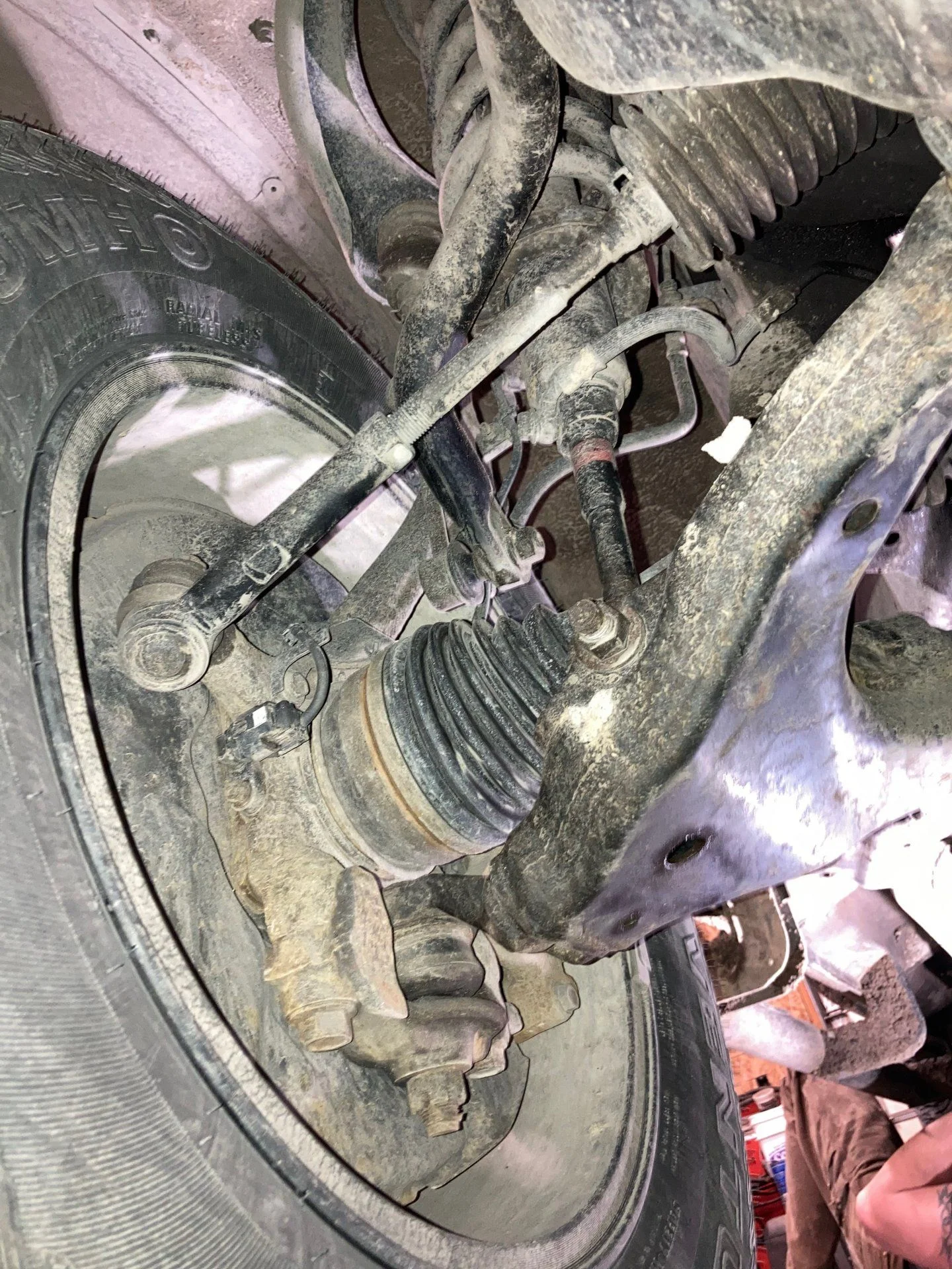

Show us a picture of the undercarriage and the engine bay.
sorry for delay, computer issues among other things.
Had my mechanic inspect the front suspension, wheel bearings, tie rod ends and ball joints. He said it all looked good and no issues at all. Did some digging and found the engine air filter looked recently replaced and the drive shafts also seemed to be recently lubricated. Took some pictures, not the best quality but I will attach them. Seems like it's in good shape so pretty happy with it.
Let me know if there is anything else that springs to mind to keep an eye on as miles get up there. Appreciate it!
