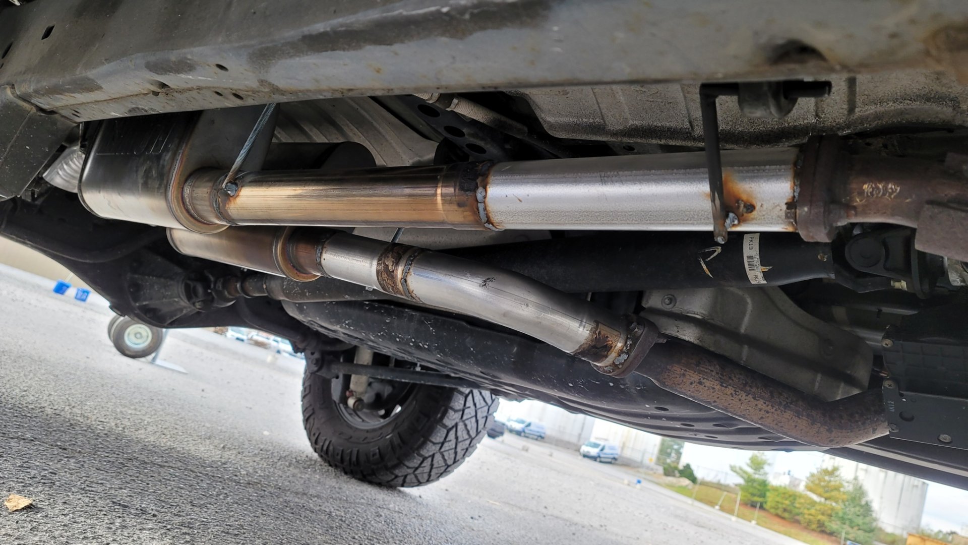

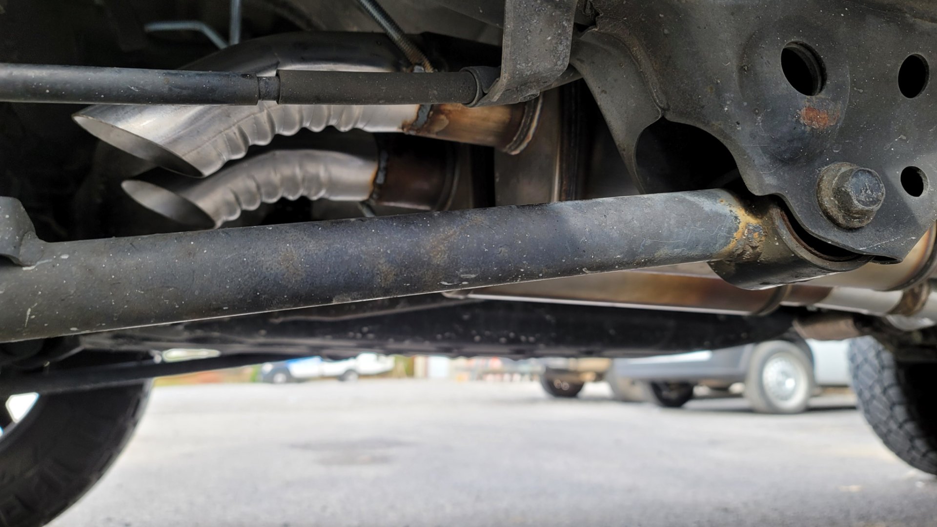

Got bored again and redid the exhaust. 2 Flowmaster FX turned down before the rear axle. Welded to the original flanges for easy removal. unfortunatly they didn't have enough stainless so had to use some crap that will probably rust, but will give me something to do again in a few years.
Looks good... Last time I did dumps before rear axle was for a 91 Coupe Foxbody - ha, ha.. are you getting any of that annoying droning noise?
Yeah there's some drone for sure, but nothing terrible. I had it straight piped for a week or so and then y piped into one muffler with the stock resinator and now this. One muffler with resinator was the quietest of the 3, but it felt like I lost power with forcing into one muffler, feels more free now. It's not a daily driver so I don't mind the noise.
