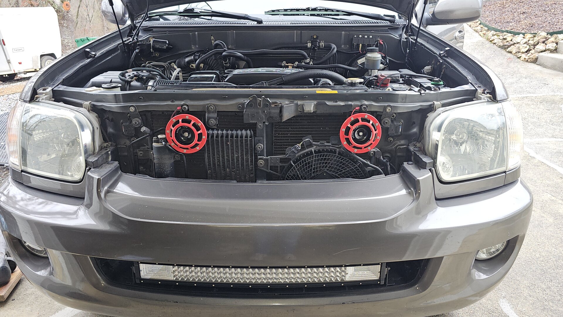

Going to harbor freight tomorrow to pick up their Hella knock of horns to try them out.
Do NOT stand in front of the truck and tell your son to test the horn.... These are loud, seriously, don't do that
Didn't know HF had those and they are so cheap! I'll have to pick up a set. The OEM horns of most Japanese cars suck in both tone/volume, including Toyota/Lexus SUVs.
Did you wire in the relay or just connect them to the OEM horn wires and ground them? Looks like these draw ~5-6 amps and the OEM horn circuit (at least in my GX) has a 10A fuse. I'd like to skip the relay if possible.
Just grounded them to the mounting screw and used the stock wiring harness, it's just a glorified female spade connector. There are 2 male spades in the horns, neither is labeled
Great! I'll pick up a set. Still have bad memories of nearly getting ran off the road by a Cummins while my weak OEM horns were trying to blare...

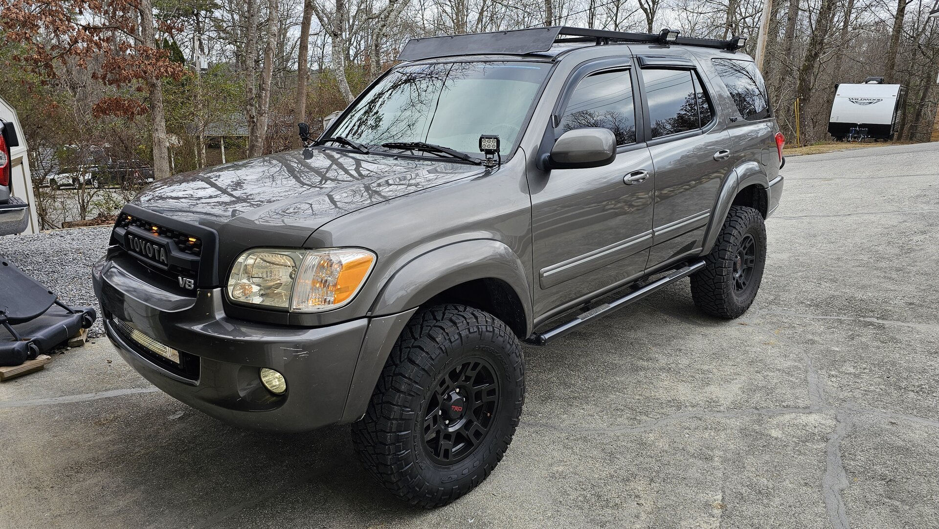

What size are the tires? I know they are 34s, but are they 285/75-17s or what? I’m going to ditch the Falken (phuh-king) AT3s asap and go back to Toyo MTs. I’m sort of stuck with 18s as the PO decided to put 18” Methods on mine. Likely go 285/70-18, but if someone were to offer me enough, I’d get a set of the TRD 17s like you’re running…
Yes, 285/75/17
Are you running spacers? Looks good man....really good. I am adding hood lights to mine as well as soon as my brackets come in.
I must be getting old. I don’t get the point of the lights in the grill.:meh:
Yes, you must be getting old, probably tell kids to get off your lawn too. 😂
I don't see the point in doing anything to any of the vehicles that I have owned, but I do them because I enjoy working with my hands and customizing vehicles to my liking. 🧑‍🔧

Built a new rack over the holidays while home. Took the factory rack off and welded a quick unistrut frame with a plate fairing and moved the expanded sheet over. Used the 10 factory locations with some 10.5 hardware. Sits a half inch off the roof at the highest part in the middle. About 3 inches more clearance now going into the garage. I found an 8' awning on marketplace for $100 new, think I will try and make some mounts for that. Not sure if I'll keep it permanently on there or not
