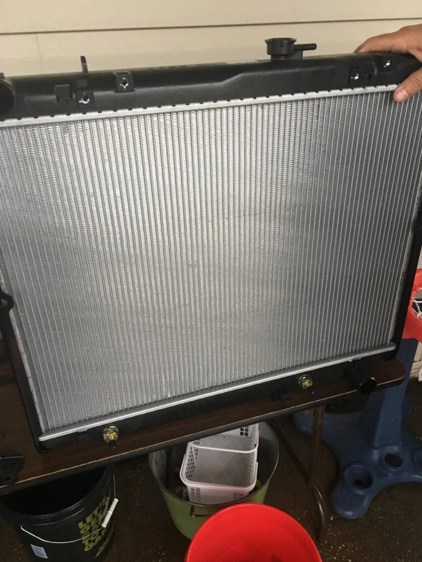

I put the Denso in mine last month and it fit perfect. Even better than the Koyo I used before. The shroud slides back over the fan. When you pull the rad up the lower hose nipple and the trans cooler stubs like to grab on everything. And sometimes when I put it back in I find if I leave the side bolts loose it's easier to get the lower bolts to thread in place.
Take your airbox out for more room too.
i suggest taking off and keeping the brass tranny line connectors from the bottom of old radiator. Just loosen the nut and comes right off. If you happen to crack one on the new radiator you can replace connector and not radiator. Ask me how I know.
I just did mine a week or two ago with the same Denso unit off of Amazon.
There are four bolts that hold the radiator in place. Two on the each side of the top, two on the lower sides (IIRC, the two on the sides are attached via brackets you will have to swap to the new radiator). Each bolt goes through a large (1.5-2" OD) rubber dampener/bushing. There are four bolts at the top that hold the lines and reservoir to radiator. You have two large coolant lines, one top, one bottom, and two smaller tranny lines (unless this was changed with the 5 speed, I have a 2000 with the 4 speed).
I took the skid plate off, but didn't remove anything else like battery, fan, or airbox. It's really an easy job.

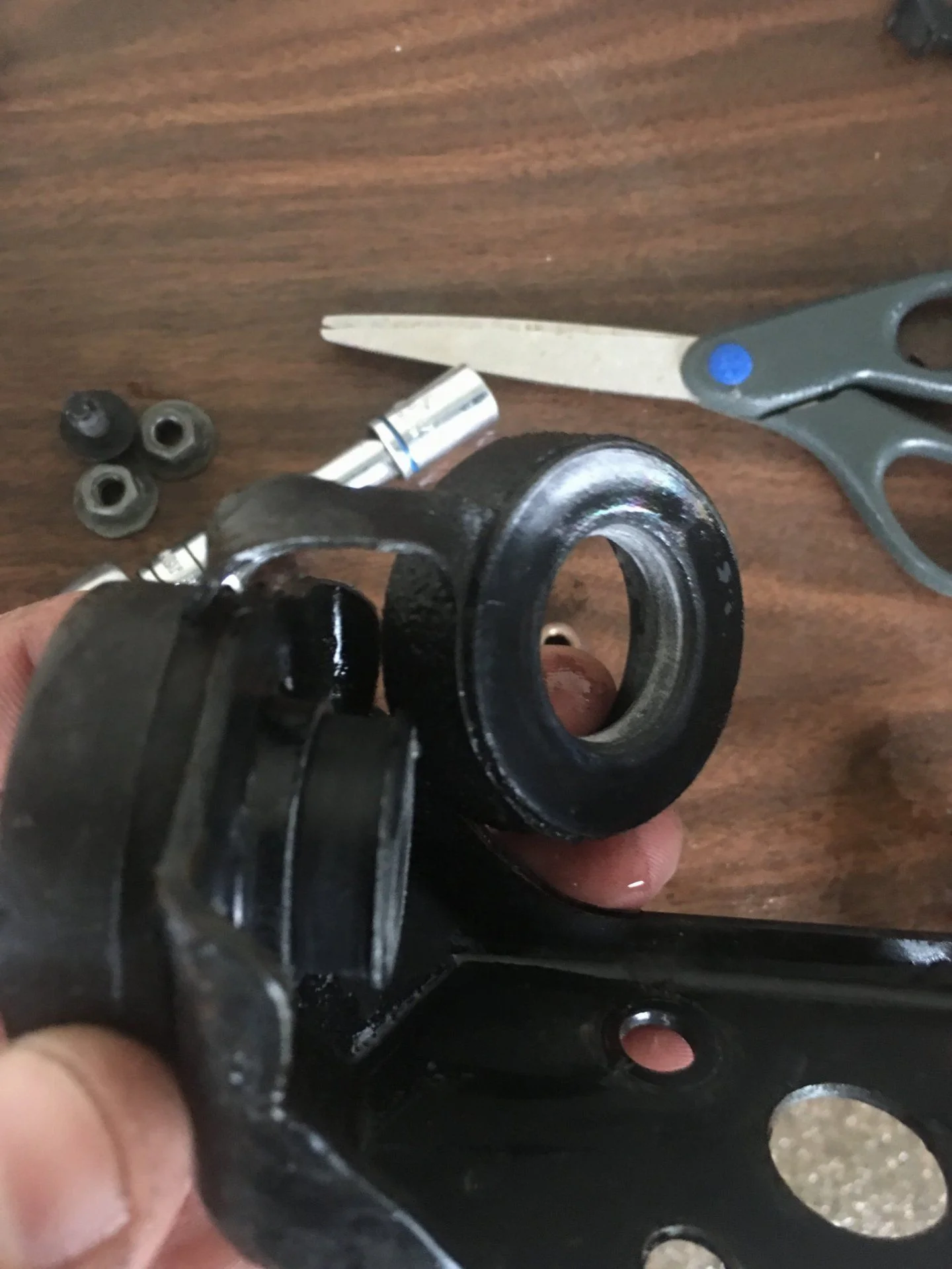

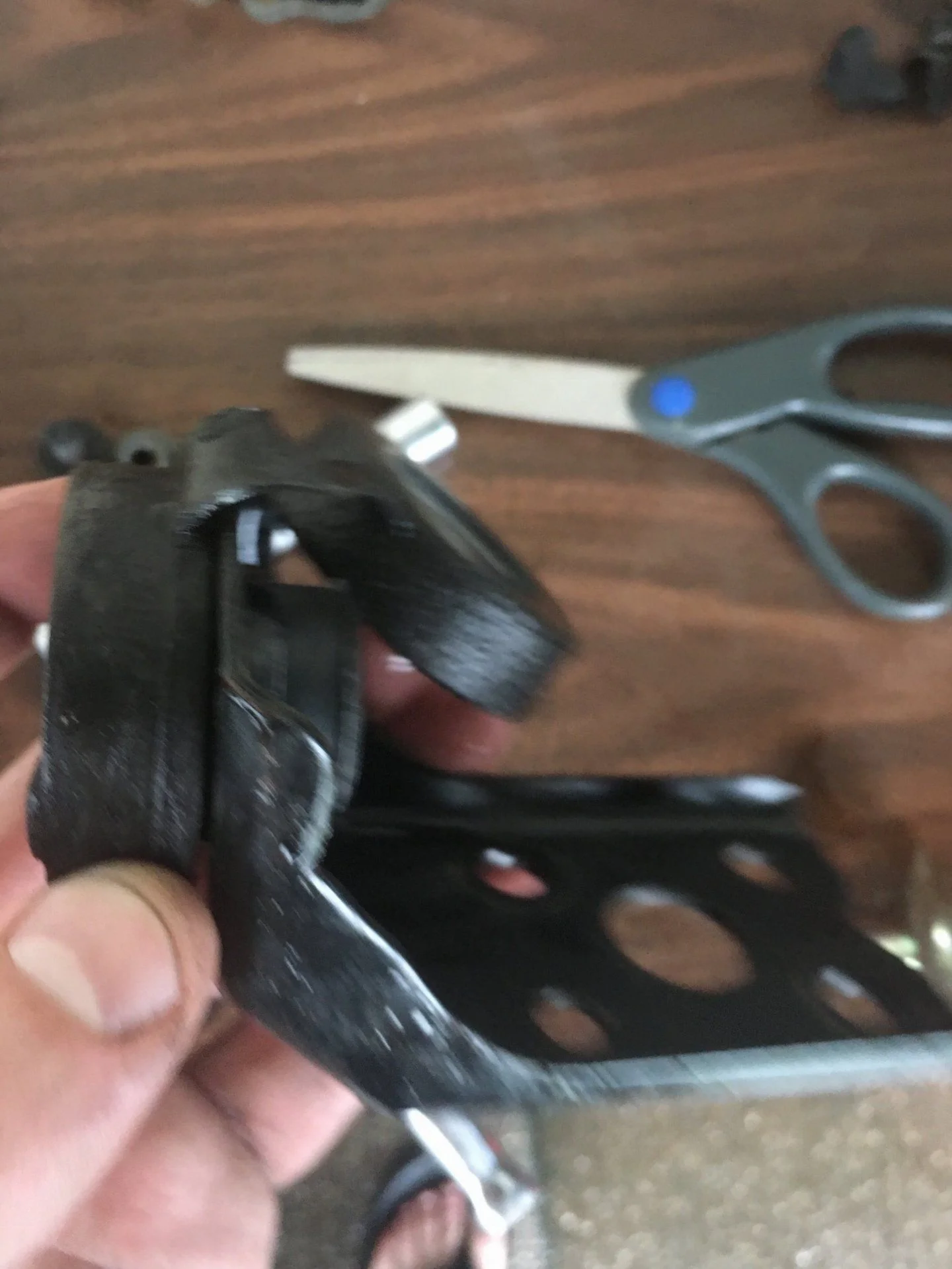

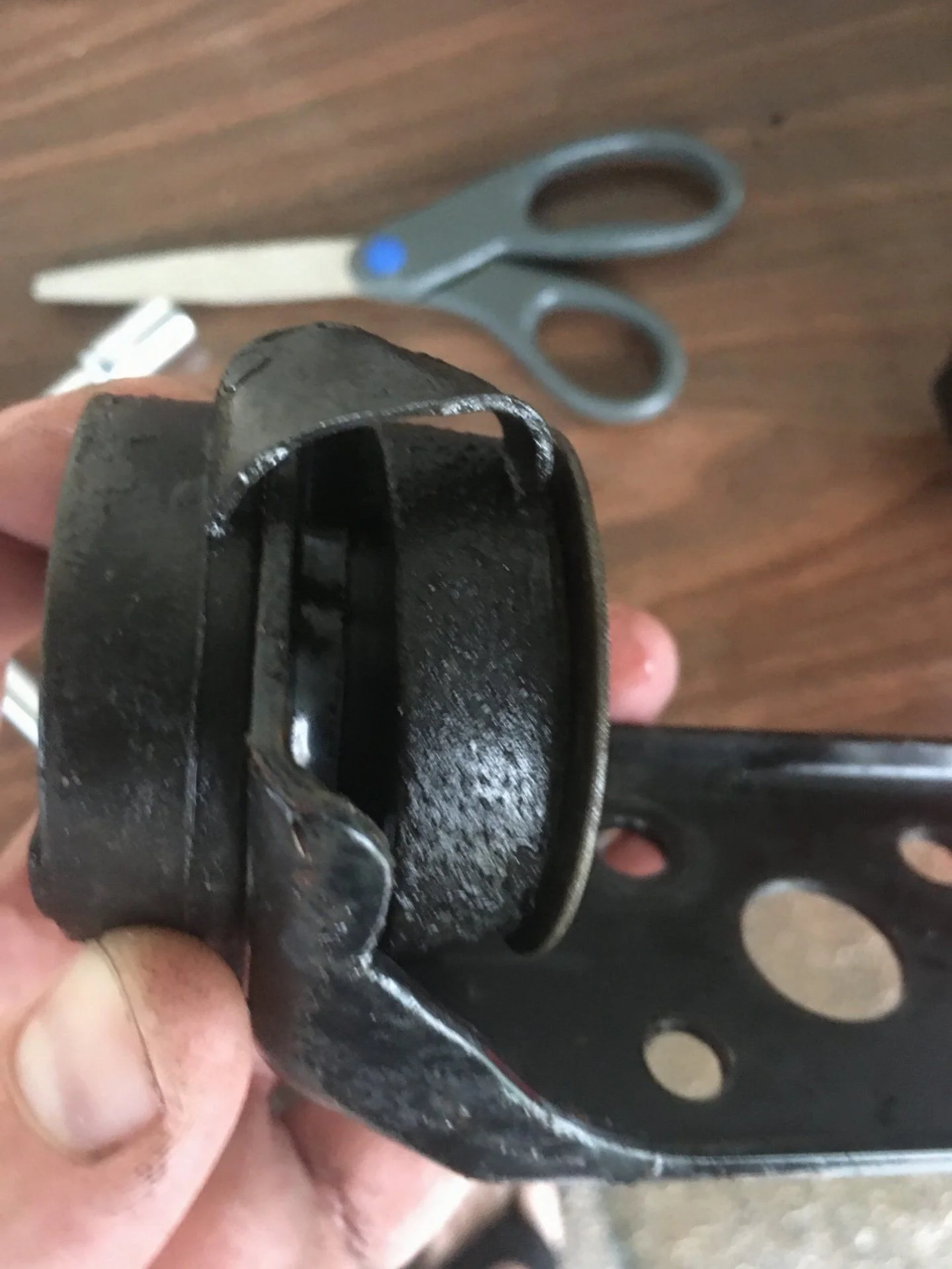

Request: When you remove the radiator, can you take a pic of the bolt/rubber damper combo?
Apparently, the top 2 dampers are missing from my rig, thus the top of the radiator "floats".
I'm sorry I didn't get exactly what you wanted now that I'm coming back to this thread. I hope these can help some. There's a grommet that goes through them and then the boot goes through that.
Thanks for the help. I had my dad come over and help me with this. It's a one person job, but I found it helpful to give him a beer and help remove the old radiator and put the new one in.
I got underneath and moved the shroud around and out of the way of the transmission nipples.
Also, I used about 4 extensions and was able to remove the 2 lower bolts easily.
When reinstalling I'd recommend doing the lower drivers side first and keeping it fairly loose. The passenger side is a bit harder to find the hole due to AC lines that are in the way.
All in all I removed the battery, fan shroud, and overflow tank. Very easy.
+1 on leaving the side bracket bolts loose until the end. Makes lining up the rubber-isolated bolts much easier.
