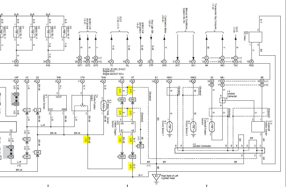

QUESTION: Now I'm in search of the ECU PINOUT for a FZJ100 A/T. I can find the ones for the 80-series, the UZ also, but not the one for the 1HZ-FE with automatic transmission (A/T). Someone?

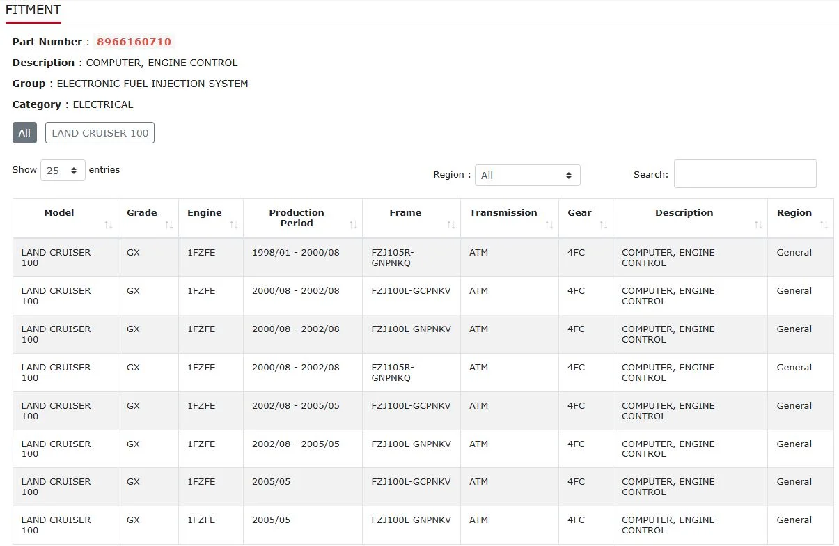

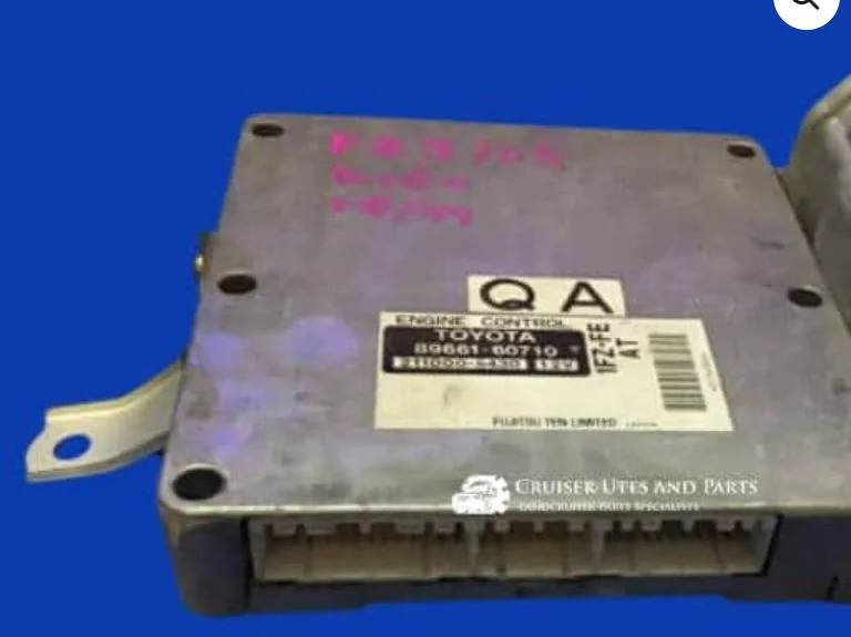

* the standard ECU 89661-60710

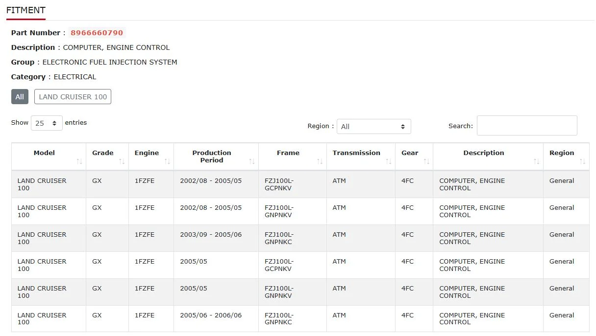

* ECU's per model

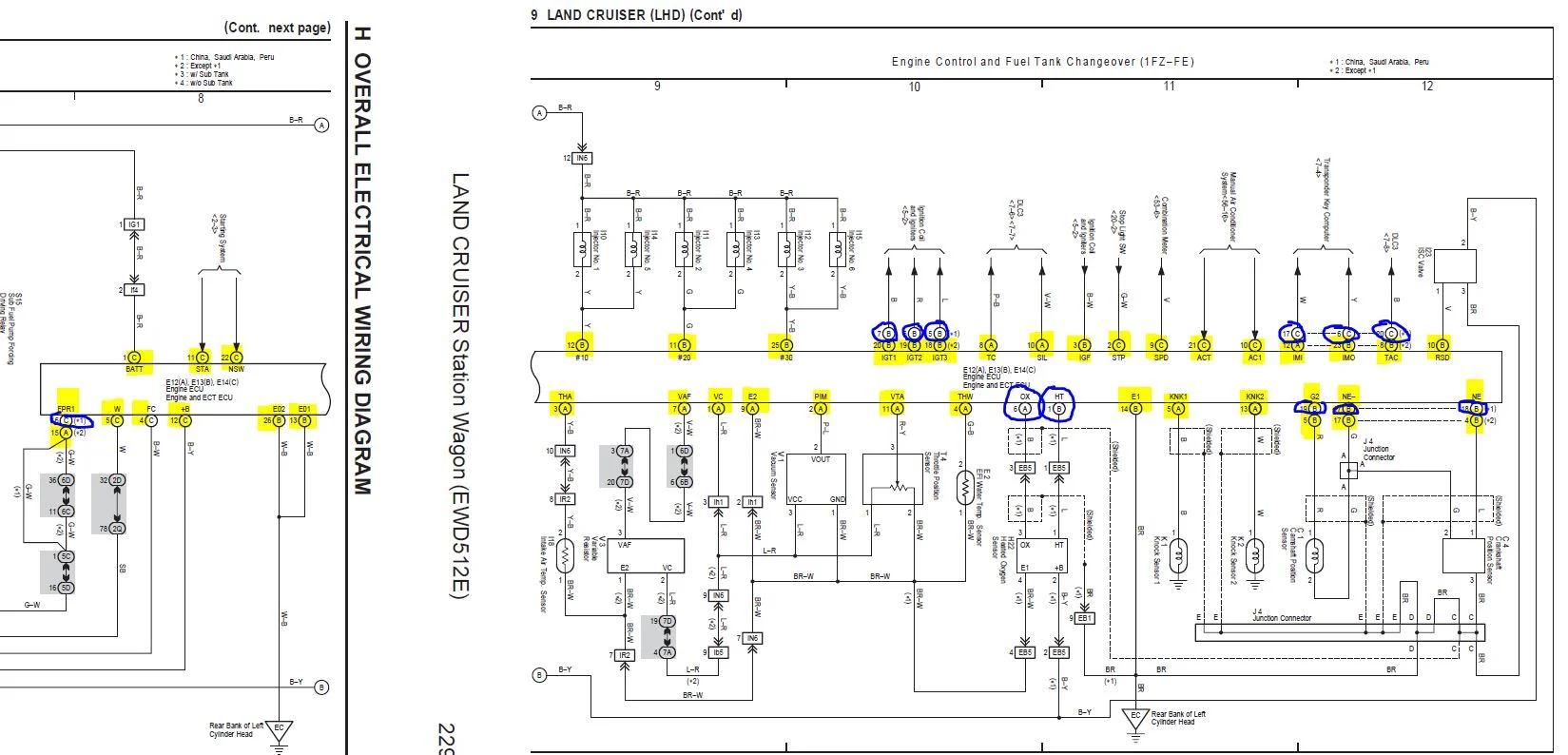

The main differences with the #89661-60710 and #89666-60790 is that:
#89661-60710 has the fuel pump(s) relay etc. connected via the ECU and a separate Fuel pump ECU whereby the #89666-60790 ECU doesn't.
In order to exchange these ECU's the fuel wiring needs some re-directions...
