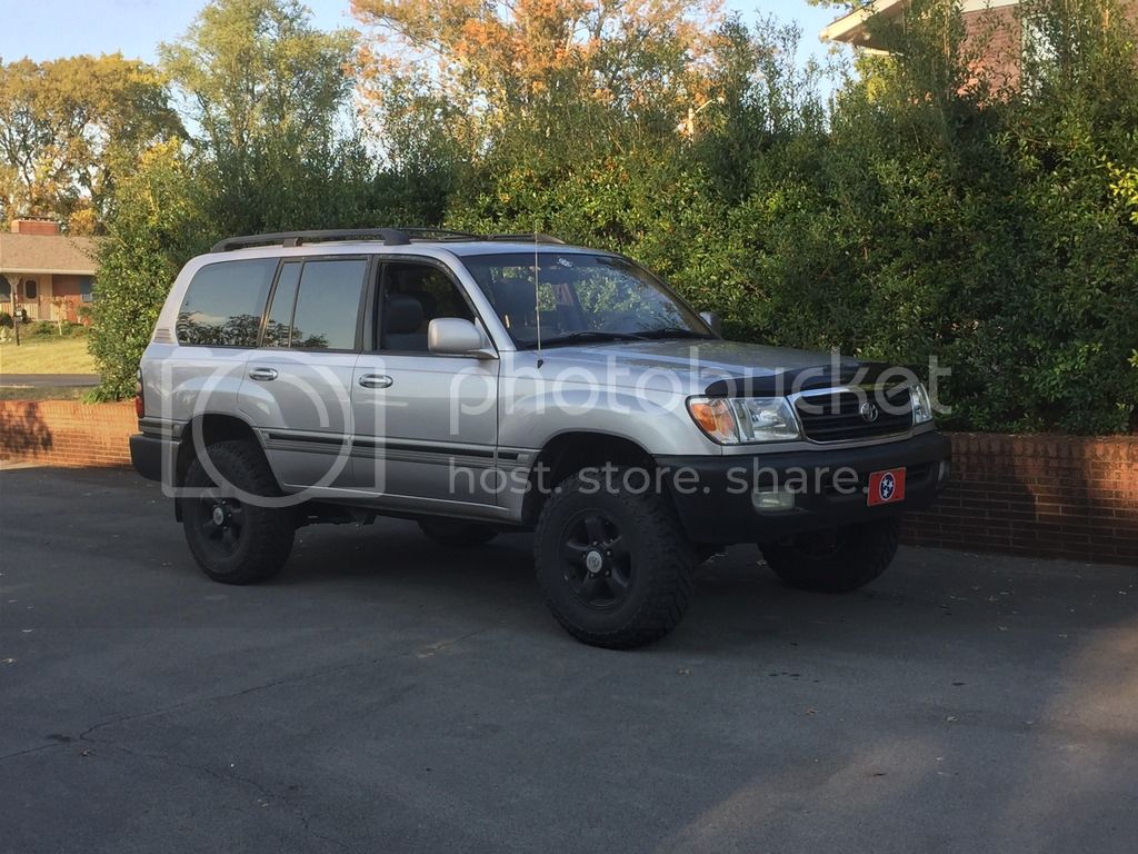

but here are a few pictures of my project. I plan to start building sliders, rear bumper, and front bumper in the next month or so once I get some free time. I could not be any happier with the way it drives and rides now with all of the new parts. Originally it felt like an old war wagon going down the highway and you were afraid the steering wheel was going to vibrate out of your hands.

One observation:
The proper stance is stink bug (front end lower). Helps keep steering from wondering side to side while driving down the HWY.
the front end sits about 1" lower than the front. after driving it to work this morning im going to bring it down a hair more. Once i put my toolbox in the back it will probably sit about level after that. I gave a guy $3500 for it and it has 186k miles. the interior is surprisingly in good shape. I have already done a full coolant flush when i did timing belt and water pump and power steering fluid flush and filter/screen cleaned. i have the fluids (mobil 1) to do the differentials. I havent decided what to do on the trans. I am not a firm believer in flushing a trans. never done it on a toyota. every other car I have ever done tends to have issues if you do it with high miles. any input? and i didnt include it, but yes, it was dry as a bone.... no lube anywhere so several tubes of grease and a sore arm later everything is greased.

The wheels are the stock 16's with the rustoleum truck bed liner sprayed on them unfortunately. and the tires are the tall skinny's. 255/75/16 Cooper ST Maxx. very pleased with them, run them on my work truck as well. they have great road manners and stick like glue in the fields.

Is that the 2.5" OME lift?
Great price.
Oh, stance looked level in pictures.

2" OME from rocky road outfitters. and SPC Upper control arms from Cruiser Outfitters. both had great customer service.

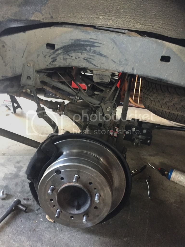

Time to add to the list. I replaced my steering rack about a month ago. I was driving the truck last night and turned into a parking spot and the bushing completely failed and the boot let go slinging power steering fluid all over the fender well and everything else under the car. (both sides have leaked since day 1.)
It made my monday complete.
I called Toyota and they told me to bring them that one and they will replace it no cost. If only they would replace my labor time for no cost also. maybe at least the beer it took me to complete the job. So if anyone needs pictures of anything during a rack replacement let me know. Ill be taking it apart tonight or tomorrow and hopefully have it back together by the weekend for the camping trip.

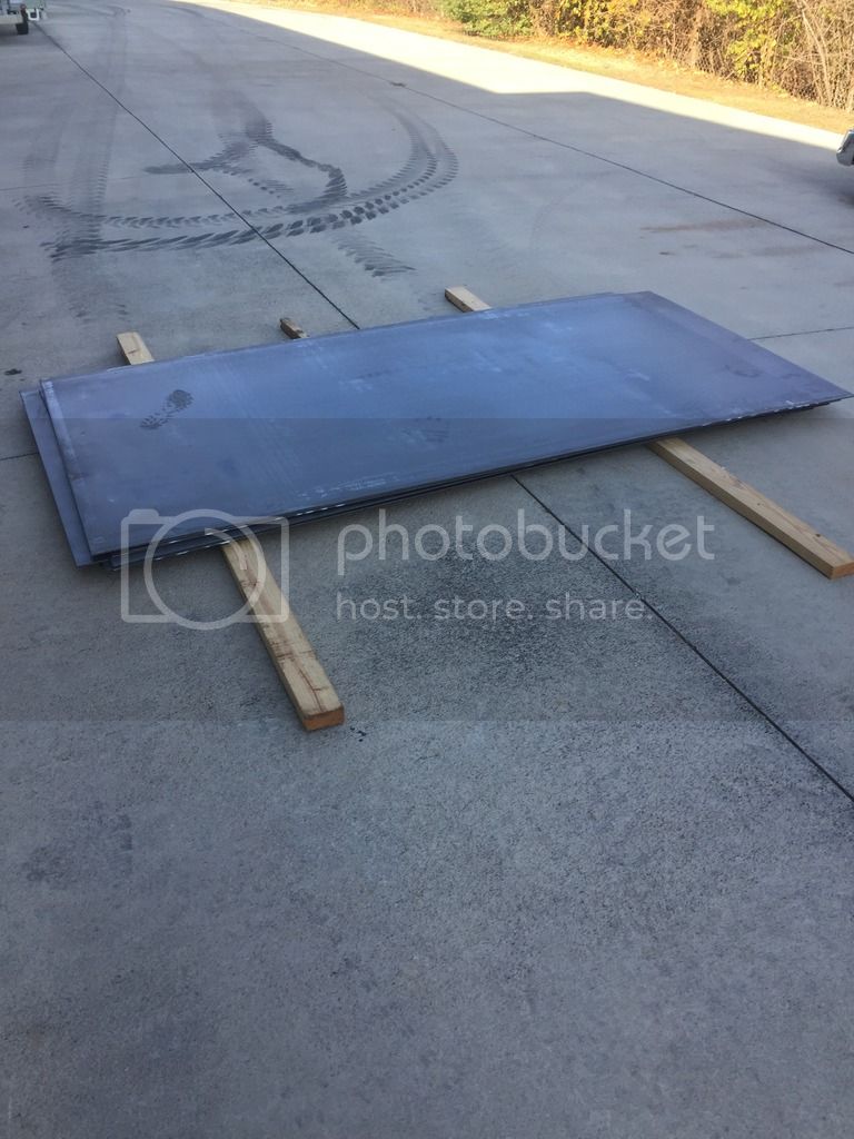

10 sheets of 3/16. always good to have extra on the rack. i forgot how heavy this stuff is.
