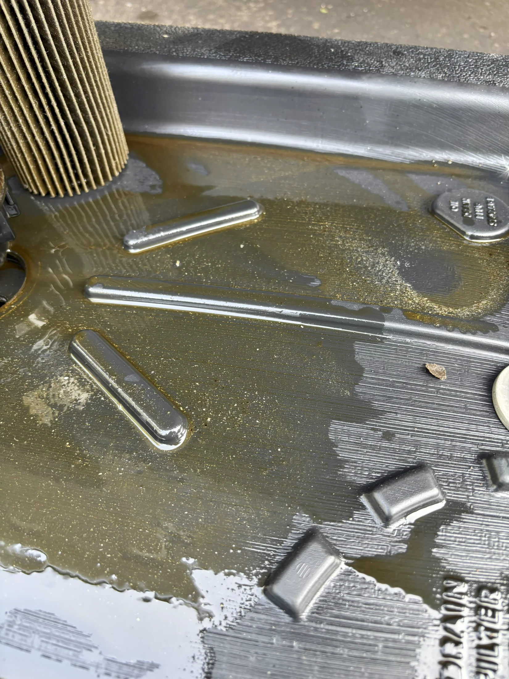

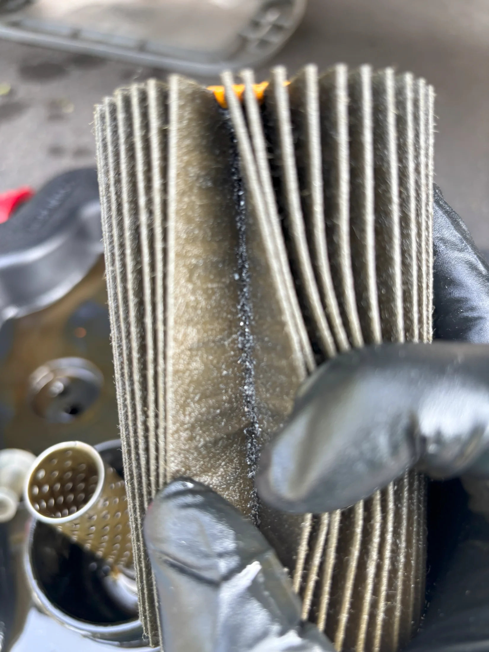

I think I can forgo the oil analysis. Safe to say its got some engine wear issues.
So a now more informed guess is the seller quickly realized the issue, covered it best he could and duped me into buying it. There was a few shreds of an old oil filter in with the metal shavings, visible center right of the first image (with the installed one having no rips) so maybe that points to the cause. Multiple other red flags in hindsight like all communication through the craigslist alias email.
Pretty amazing it drives as well as it still does and only outward symptom is a crankseal leak that actually takes awhile to notice on the dipstick.
Also amazing it was into a dealership mechanic three times, another more general mechanic, and finally the toyota specialist and nobody mentioned this pretty obvious one (Toyota Master Tech seemed to have figured it out regardless).
View attachment 3987040View attachment 3987039
