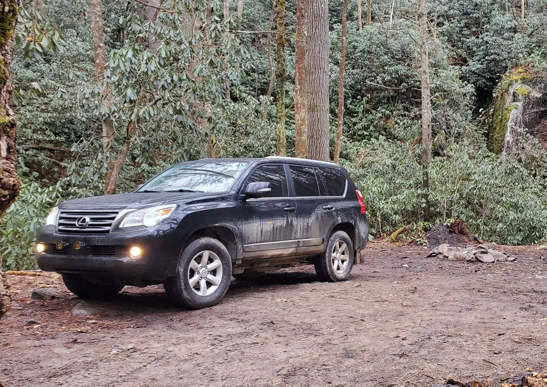

I have the 275/65/18 on my stock wheels on my 2012 with stock suspension. I have wheeled it and did a lot of fast maneuvers and probably only rubbed once. I think you should be fine with the 2" lift to account for the backspacing. worst case scenario, a tad bit of plastic massaging is needed. Here is how mine looks with those tires.

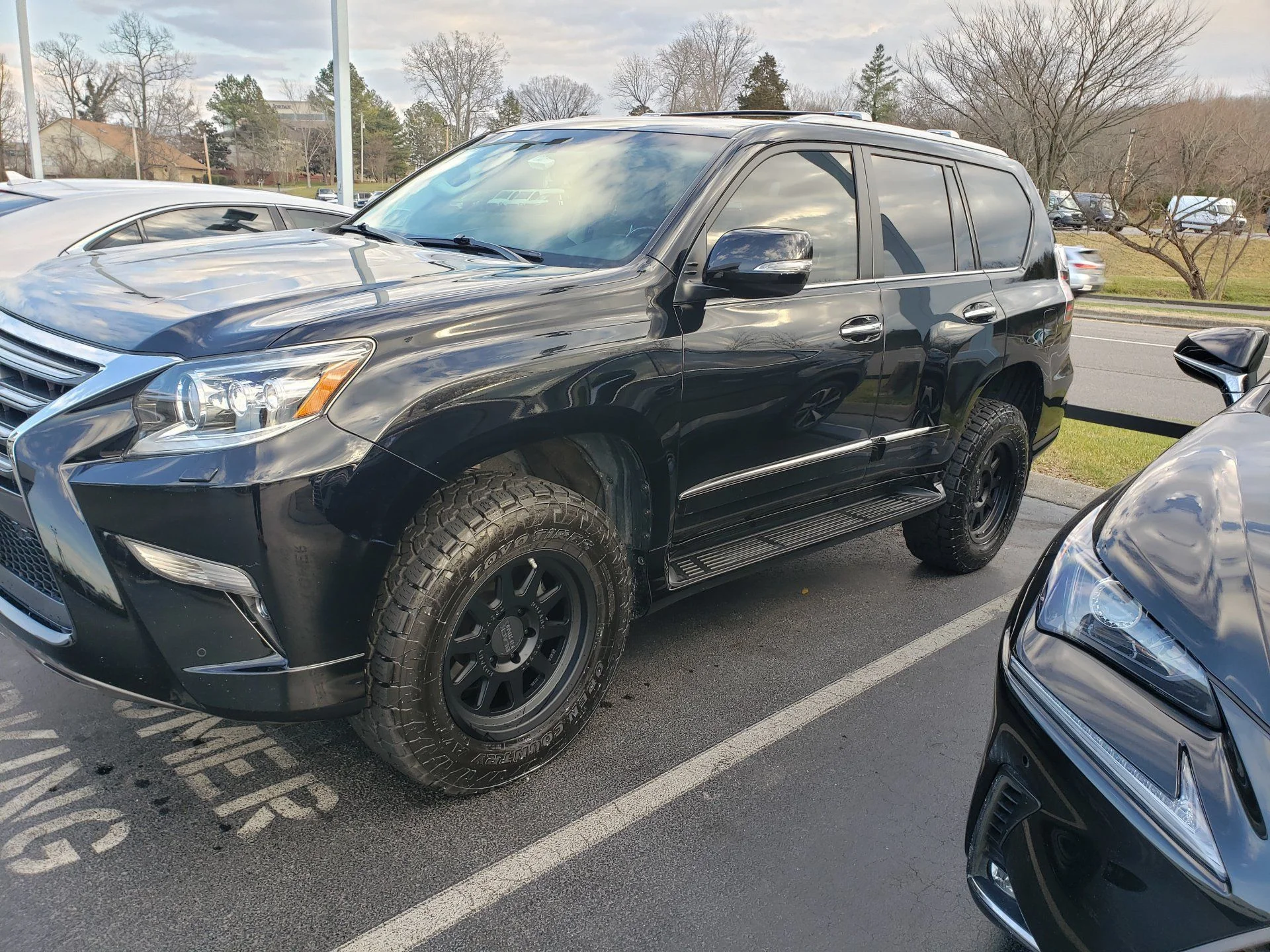

I have the Dobinson's lift, SPC UCA's, 275 65 18 AT3's on Black Rhino wheels with zero offset. Yes, it does still rub but I have not done anything to further modify at this point.
2015 GX premium
What’s the offset on the wheels? How bad is the rubbing?
2015 GX premium
Can you post a pic? This is similar to what I want to do. Thanks
