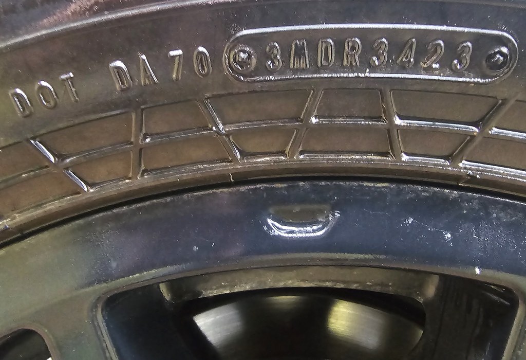

Hate to quote myself but mystery\question solved.
Hard to believe that I would be the only one to have a sidewall puncture with the Wildpeaks even the SL so did a google and first thing that came up in AI is from a year ago:
Sumitomo Rubber USA LLC is recalling 1,900 Falken WildPeak tires due to a manufacturing error which may have resulted in a puncture in the tire’s sidewall. The tires include Falken WildPeak AT3W in size 265/70R17 115T
Plant ID: DA
Size code: 70
Optional code: 3MDR
M codes: 3023-3423
My 4 remaining tires date codes:
3423
3423
2422
2923
So 2 of my mounted tires have been recalled, guessing that the flat was also a 3423 but last I seen it was on the floor of a shop on the North Shore of Lake Superior next to a pile of moose antler sheds.
Will be spending some time on the phone tomorrow with Sumitomo customer service to see how they want to handle the 2 recalled tires and if anything can be done about the one that alerted me that there might be a problem because of sidewall failure. Be interesting to see how they handle this. Like I tell software vendors that call on me at work I just want your stuff to work. And when it doesn't I want great customer support.
Given that you probably have some miles on the remaining tires and they would be quite a bit different in wear than a new set, I really hope they just give you all four! The AT3W is discontinued anyway and it would be somewhat suprising if there were a few in your size left sitting around that hadn't been installed. I'll also be curious in terms of how the handle this.
