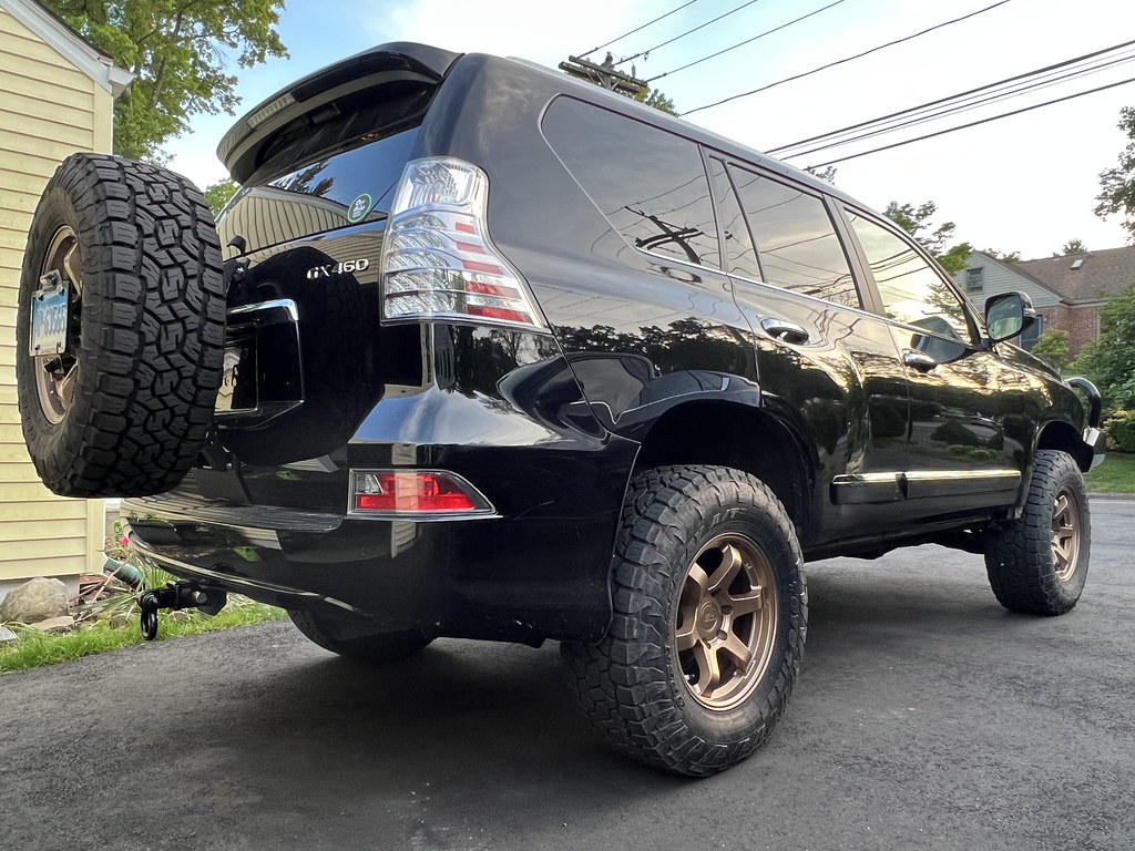

Anybody got pics of wildpeaks or Toyo AT3’s on their rig to share?
These are Toyos at 285 70 R17
285/70/17 Toyo Open Country A/T IIIs in Load Range E

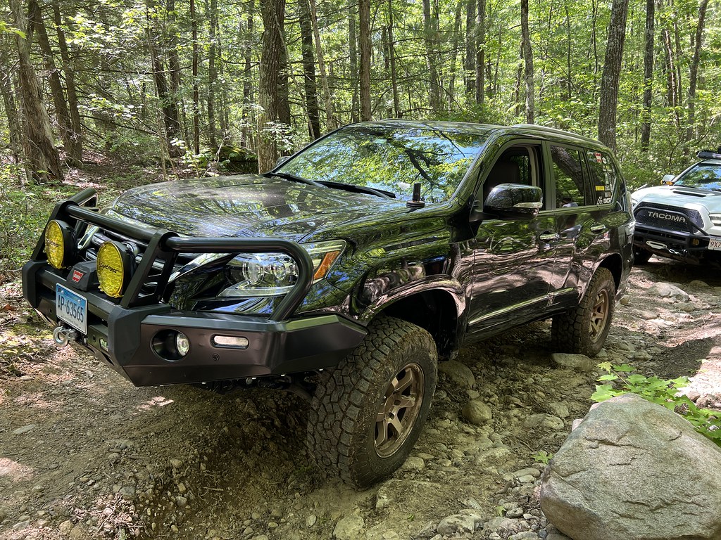

This is on a 470 but shows a close-up view of the SL-rated 287/70R17 Wildpeaks. On my recent trip to CO my rig made it up stuff that my buddy's JK could only make it up with both lockers engaged and 33" mud tires. I just had the Wildpeaks and ATRAC. These things have crazy traction on rocks when aired down.
