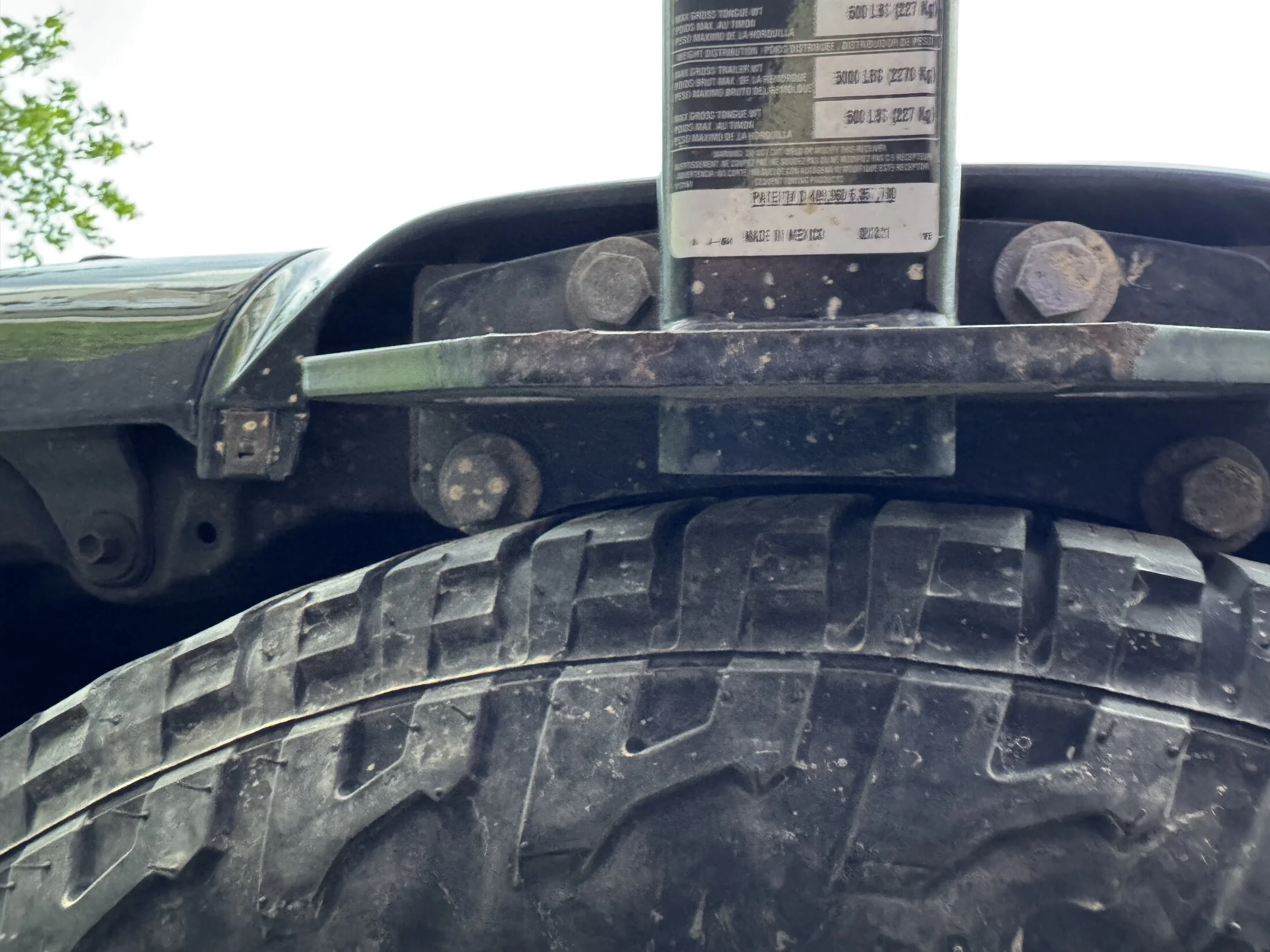

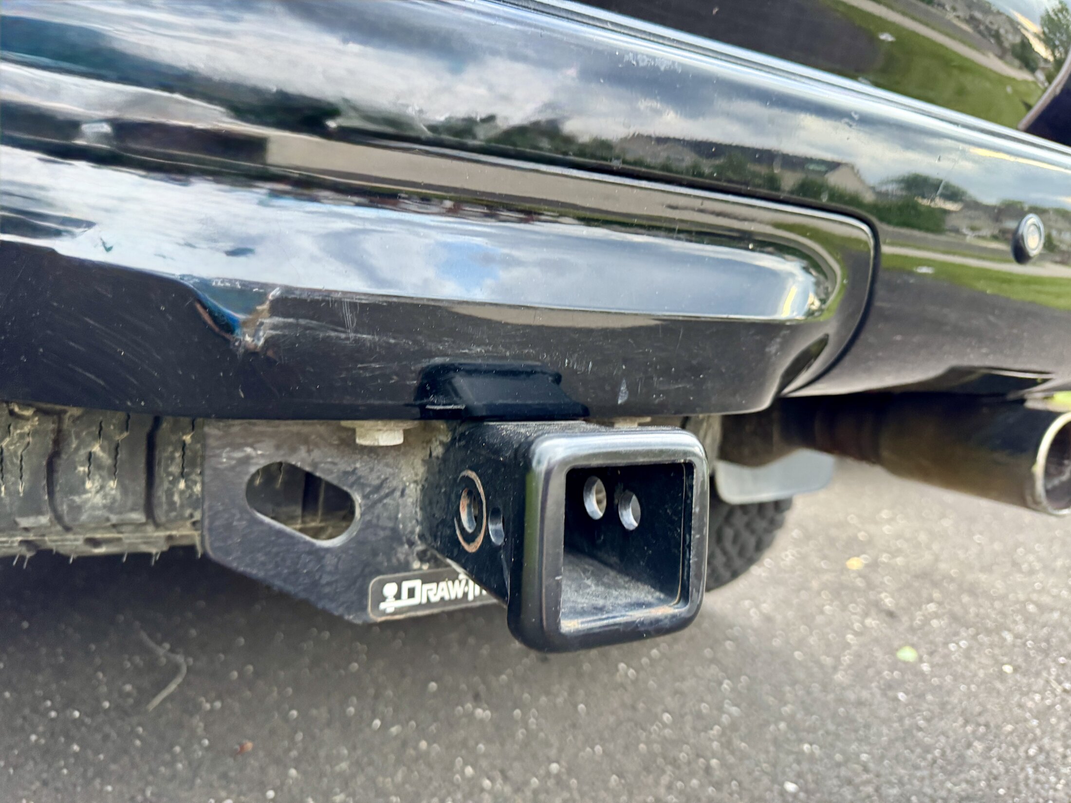

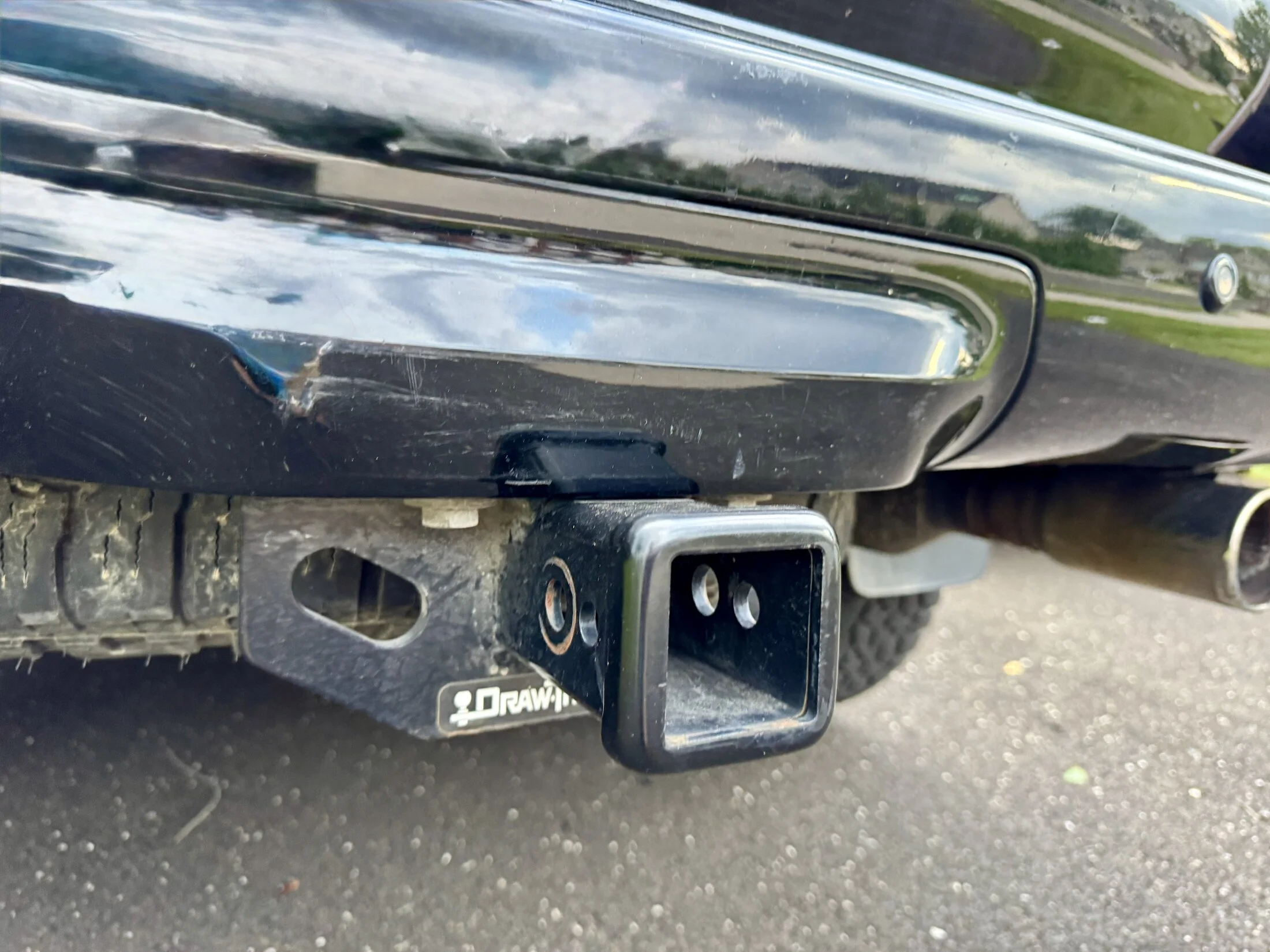

I've been using the Curt class 3 hitch receiver for a few years and have had zero issues. I've used it with a thule 4 bike carrier and kuat swingout on mild trails and with typical US highway driving (60mph+). The install was easy using the pre-threaded holes already in the bumper.
Thanks mudmoose; that’s really interesting! Could you elaborate if it is only the hitch receiver (like this https://www.etrailer.com/Trailer-Hitch/Lexus/GX+460/2012/C13043.html?vehicleid=2012303084) or the full bumper you installed (like this https://leonardusa.com/product/bkdk-13282/)?
Did you have to cut out plastic from the rear bumper? Thanks for sharing 🍀

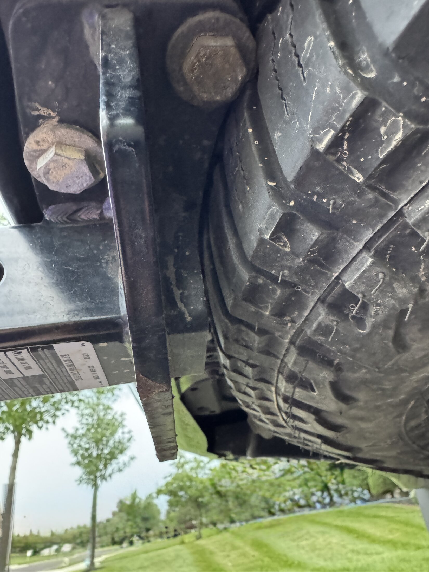

I have the NYTOP hybrid rear hitch. I did have to trim the lower rear valence slightly, but it really isn’t noticeable even up close. The powder coat on NYTOP is poor, though.
It’s the hitch receiver like the one in your first link. Bolts on to the underside of the rear bumper. No cutting required. Allows for a 265/70r17 falken wild peak at3w to be stored in the factory spare carrier.
You are going to give up a few degrees of departure angle. I’d rather skid off my $150 hitch receiver than the more expensive bumper.

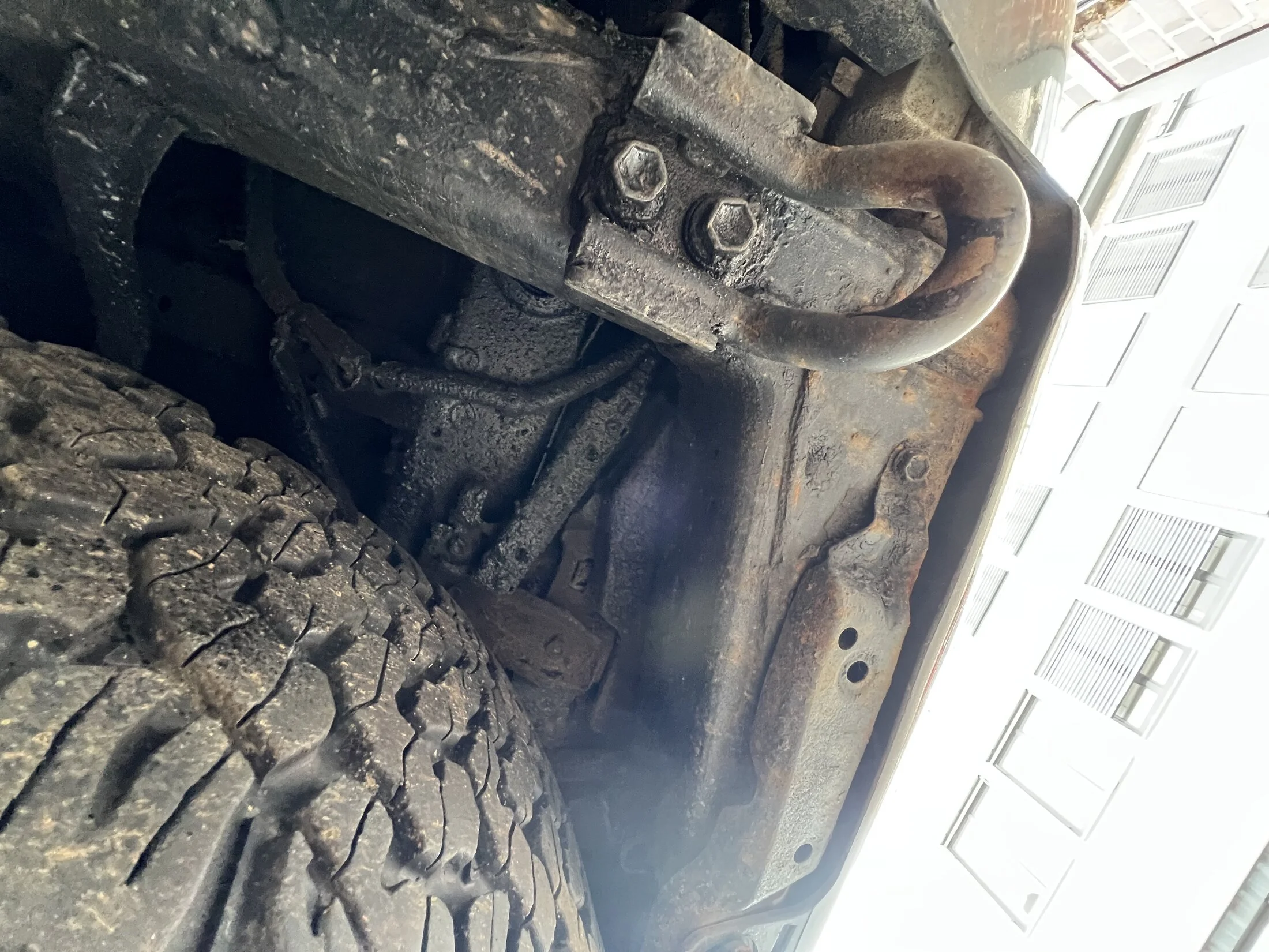

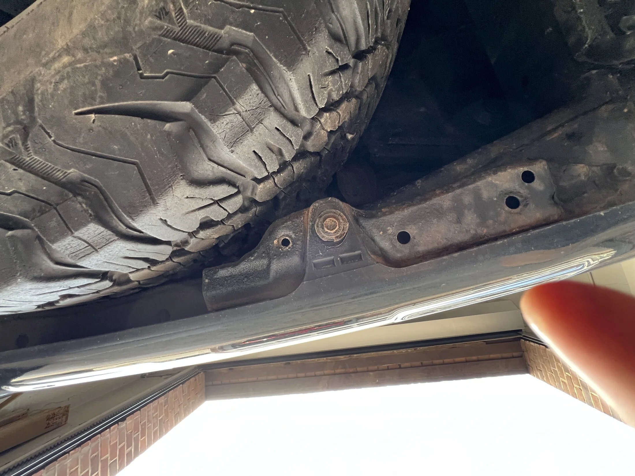

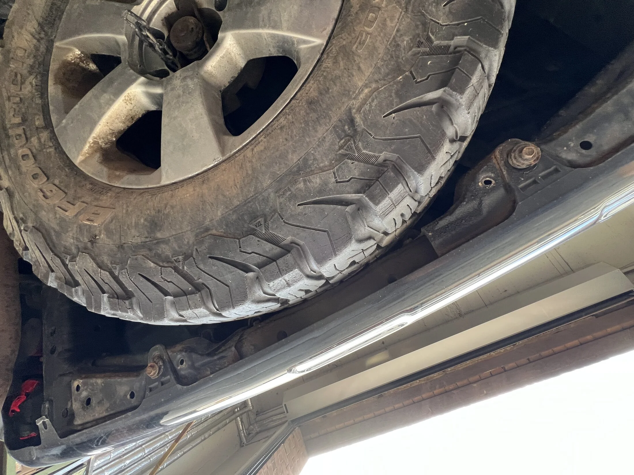

Amazing thanks for sharing. With my Toyota LC 150 Prado I see no way to install this under my bumper. Tried to take a picture underneath and see no screw options plus the spare carrier would leave no space imho.
I gave the vehicle to professional garage for installation as I could not find the signal button for deactivating the parking buzzer.
I am excited to see if they managed to install everything. For the documentation I will post it here. And would be nice if Mudmoose would share his thoughts on the above. Cheers
