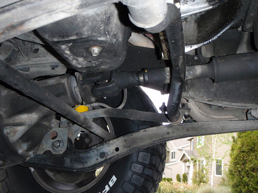

Yesterday the 2.5 heavy OME suspension was installed on my 95FZJ80 by a local shop for a very reasonable price. The 45 minute ride home on the interstate in the rain at night was a white knuckle drive. The steering is now light and the vehichle is prone to overreact to changes in the road. Apparently the OME caster correction bushings were improperly installed or I need a little more, possibly the slee 3 degree bushings or totally new arms.

It looks like your bushings are installed wrong. The bushing at the front of the arm should have the hole offset up, the rear bushing offset down.

The bushing outer sleeve compresses when you press them in. Once that is done, they are no longer the same size. Re-using them may or may not work. They will loosen up over time if you re-use them. If you gave them the instructions, they should have done it correct. They are an ARB dealer and either should know better, or have found out how to do it from ARB if they did not know how to install them.

I'm not going to name names, let's just say it was a large chain store. Yesterday they pressed in the new caster bushings correctly and now the problem is resolved. On the ride home it handled much like before the lift and I'm now satisfied that any change in the road won't send me darting into traffic. If I remember right from the alignment sheet the caster is now +0.8 degrees. I can't tell you what is was before since the alignment was only done after the bushings were installed correctly.
