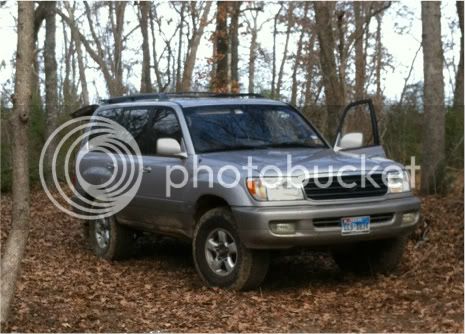

For example, in this shot:
I had the Slee medium kit with 30mm spacers, my fridge, recovery gear, and 10 gal of gas. The rear wheel was stuffing up into the wheel well and rubbing like crazy. It was just too soft even with a 2.5" lift. I dont see the OEM doing any better. I would personally do a lift first. The rear is nice, and I love my BOIR. but the lift got me going further and more technical then the bumper ever has. I cant remember if you still have the oem roof rack in storage or not ( I remember it isnt on), but I used to throw my spare on the roof when hitting trails. You could do the same easy. For me the final choice to get a rear bumper came after a long week and a half trip into Baja when I had to carry 10 gal of fuel inside the truck because I didnt have a rear bumper and the roof was loaded with surfboards and camping gear.
