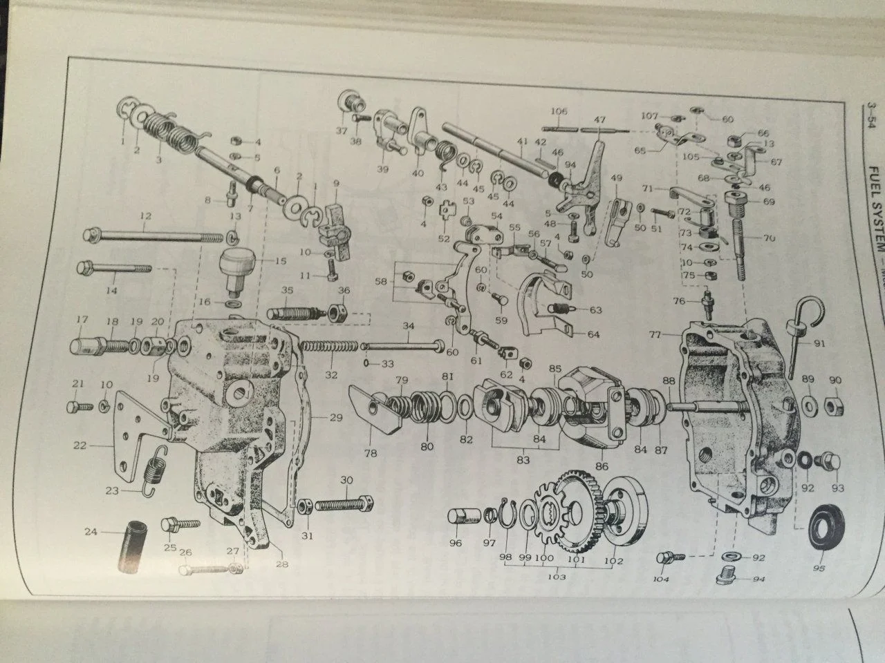

This may help
That's a really early pump where the pump oil is filled, level-checked, and changed completely separately from the engine's oil. (And that drain plug #1 is used for the for draining the IP's oil.)

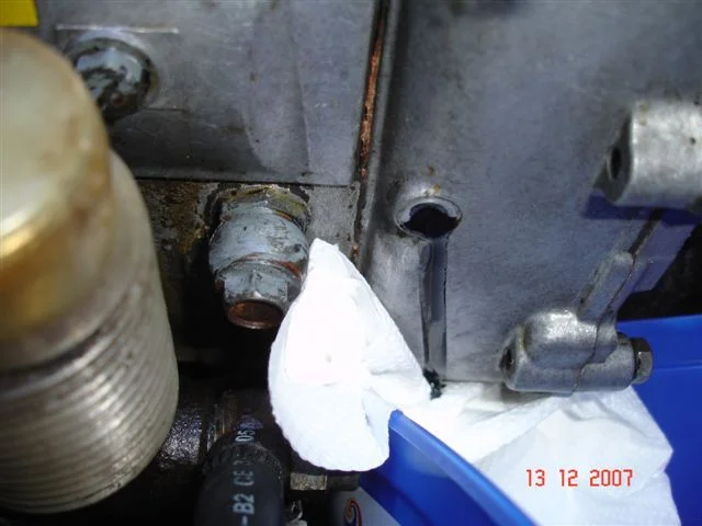

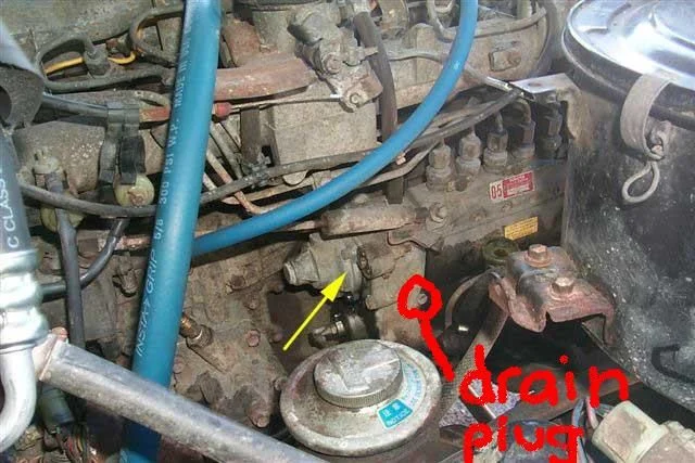

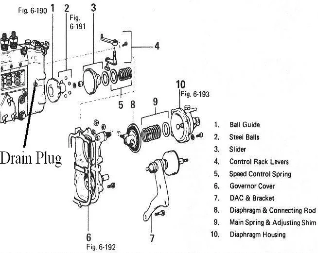

Well I'm fussy about maintenance and I read "Owners Manuals" and even "Workshop Manuals". Yet until a recent thread on MUD, I was completely unaware that this plug on my BJ40s injector pump was there for draining engine oil that leaks through internal seals into the diaphragm enclosure (into the governor housing).
I have never found any mention of this maintenance task in any Toyota literature that I have (and I have more than most people).
So after 28yrs, I just removed this plug (10mm spanner) and watched between 5 and 10ml of dirty old engine oil drain out.
Don't ya just love MUD!
:cheers:
View attachment 195674View attachment 195675
