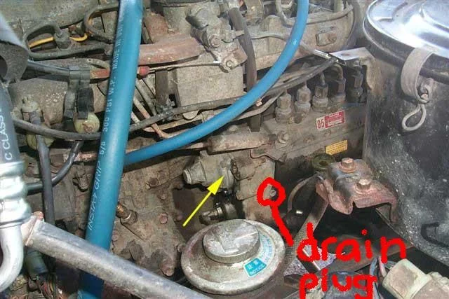

Well I'm fussy about maintenance and I read "Owners Manuals" and even "Workshop Manuals". Yet until a recent thread on MUD, I was completely unaware that this plug on my BJ40s injector pump was there for draining engine oil that leaks through internal seals into the diaphragm enclosure (into the governor housing).
I have never found any mention of this maintenance task in any Toyota literature that I have (and I have more than most people).
So after 28yrs, I just removed this plug (10mm spanner) and watched between 5 and 10ml of dirty old engine oil drain out.

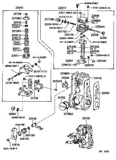

Could be this one just at left of the primer ..
I will check today in Techa .. maybe after 20 years the first one also ..
I'm pretty sure it is the one I've circled in red.
(PS. Your pump is on the wrong side of the motor.)

I'm not expecting any difference Joe. But if a lot of oil was allowed to collect in there and it reached the leather diaphragm, it would certainly hasten its deterioration.

2H autos don't control the fuel with vacuum like the manuals and 3Bs do. No diaphragm might mean no concern about leakage? Then no drain plug is required.
It'll be messier but I imagine you can take the whole access cover off and drain what is in there.
Likewise, I can't see why you should ever need to drain oil from the mechanical governor (used in cruisers with automatic transmissions).
While accumulated oil can damage the leather diaphragm in a pneumatic governor - I can't see anything able to be damaged in a mechanical governor.
For inquisitive folk I see there is a big inspection plug there ... But access may be difficult and personally I doubt I'd bother trying to look inside unless I had IP troubles.
