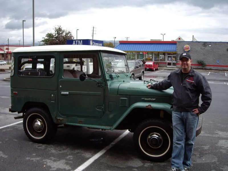

Ok, she is not much to look at yet, little rust here and there, but that will be taken care of eventually. Neat things are, still has the owners handbook, tool kit, and service light in the glove box. The frame is not anywhere what I was expecting, it looks like mainly surface stuff, but we'll see when we get to rust wheeling it. I think it looks cool stock, but we'll see how long that lasts. All in all I would say I am overall impressed, even the :princess: likes it.
1975, one owner 93k original miles on the clock.....
Congrats! Looks great. Love the whitewalls!
Great lookin cruiser. x2 on the whitewalls :grinpimp:
Nice find, I hope you get a slow station and can pull into the bay and work at work:) Keep it as stock as possible you'll be surprised at what it will do!

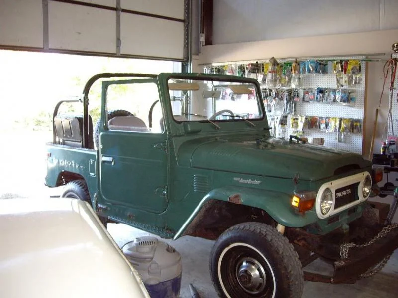

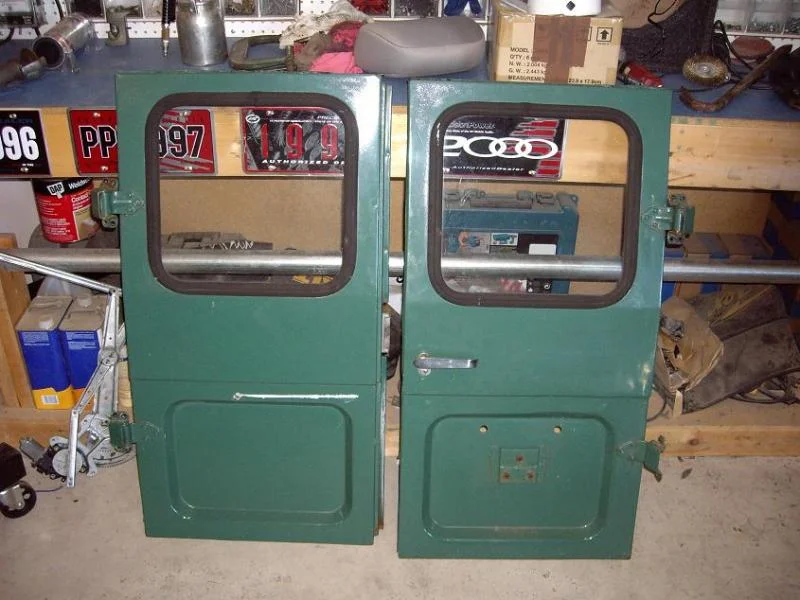

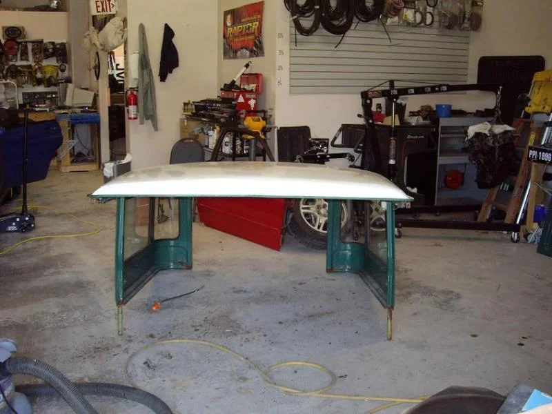

Man, I tried to call you David the day we brought it home, we had to stop in Weavervegas, and I was gonna get ya to come down and look at it with your perfect 40 series:D Anyway, we got the top off with some elbow grease and shearing off some old bolts.... Ambulance doors are not the easiest thing to get off once they have been painted on ( the screws that is) however a 9mm 16pt socket hammered on will take them out. Tomorrow I think we are going to band aid the tub where the driver's seat is, as that looks as though it is going to fall through. But here are some pics of it with the top off. Also, a little paint in the engine bay goes a long way for making it look better!!!
More.... I figure the neighbors are going to start calling me the crazy land cruiser guy, kind of like the crazy cat lady on the Simpsons after seeing the last picture.....
Very cool. Looks like it's all there.
Let me know if you have any part needs. I have a few.
As far as the sheetmetal. If you don't have the funds to buy new reproductions I would suggest you find a local sheetmetal shop. Make some templates of what you need and have them bend some stuff up for you. It's usually cheap. And looks a heck of a lot better than what you or I can do with a hammer. You can have them bend up some 14 ga for the floors. That is thick enough to not need the ribs.
