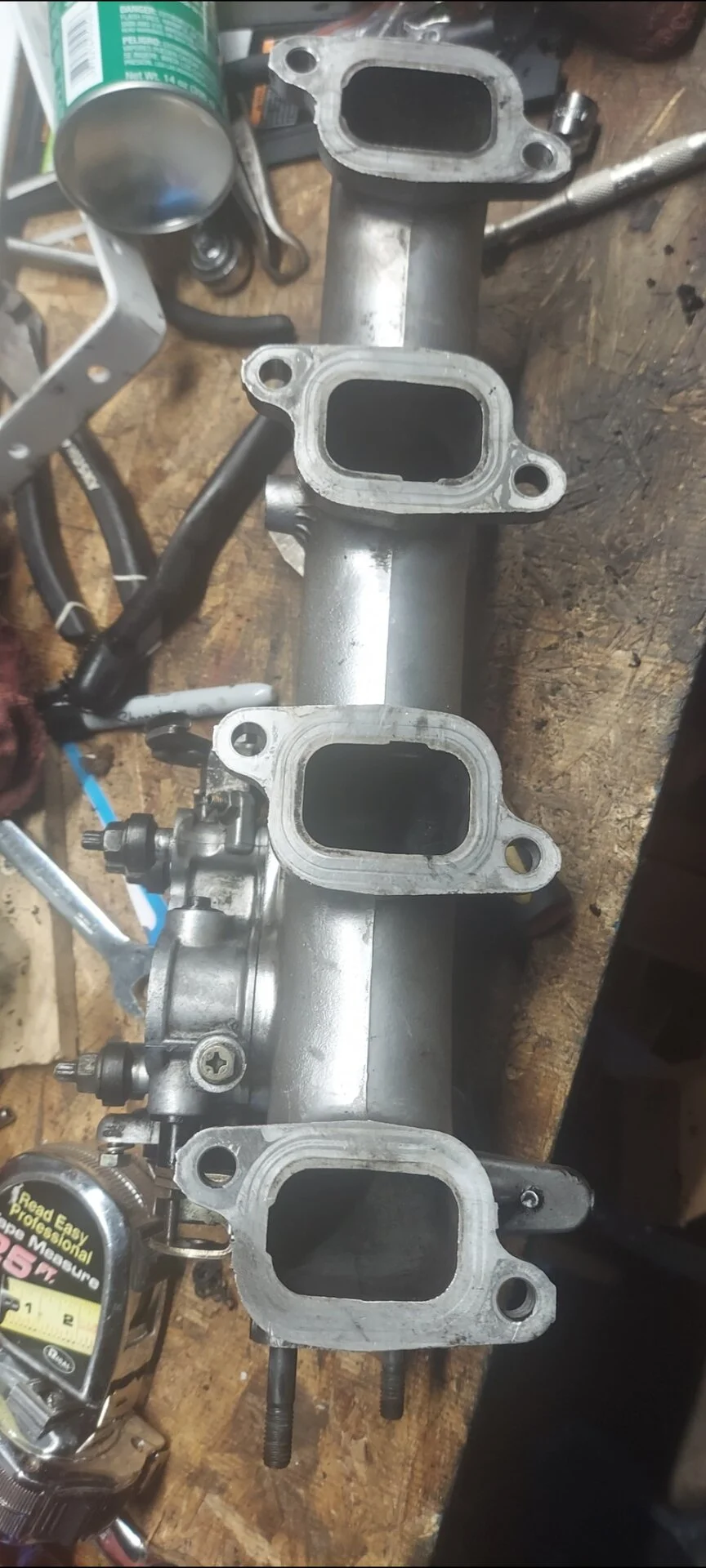

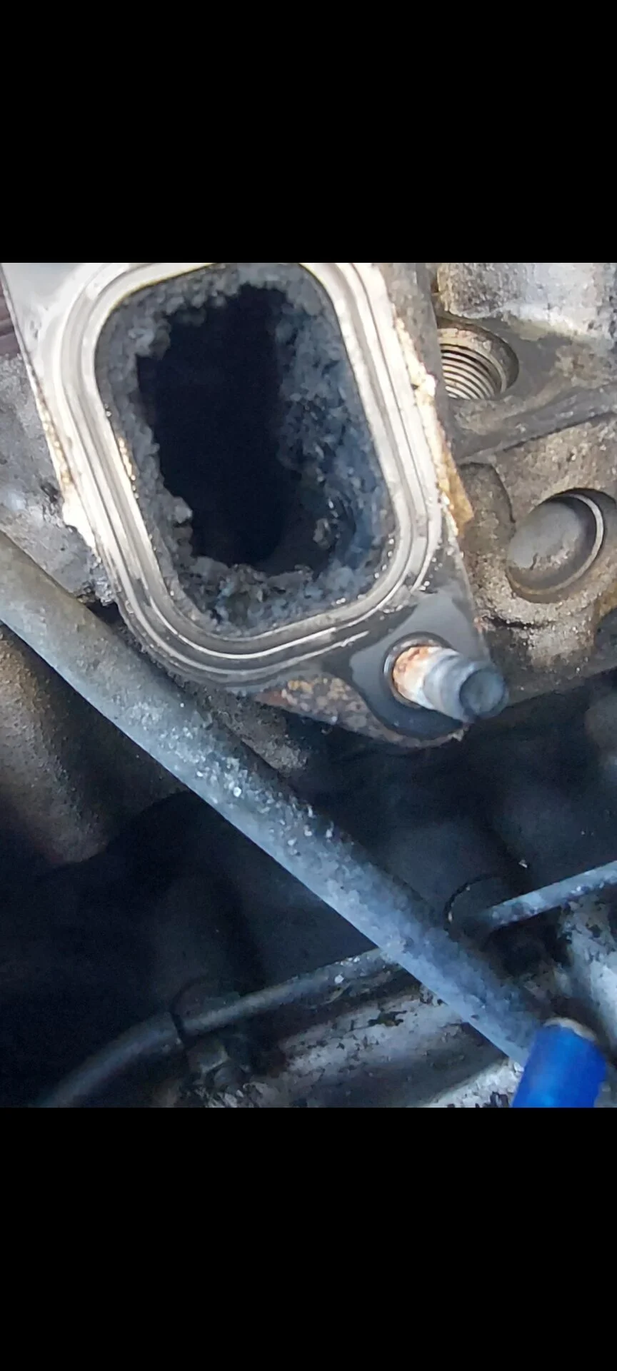

Have you cleaned the intake manifold since the EGR delete? If that's coked up with soot, that will certainly cause a loss of power and other dramas! You might be able to see down the throttle body but best to remove the throttle body altogether and have a squizz.
Both intakes soaked in diesel for 15 hours and scrubbed -

I did a thorough soaking and scrub of both intakes - i carefully scouped out what i could from the intake ports also using a shop vac to keep any bits f4om falling into the cylinders -
