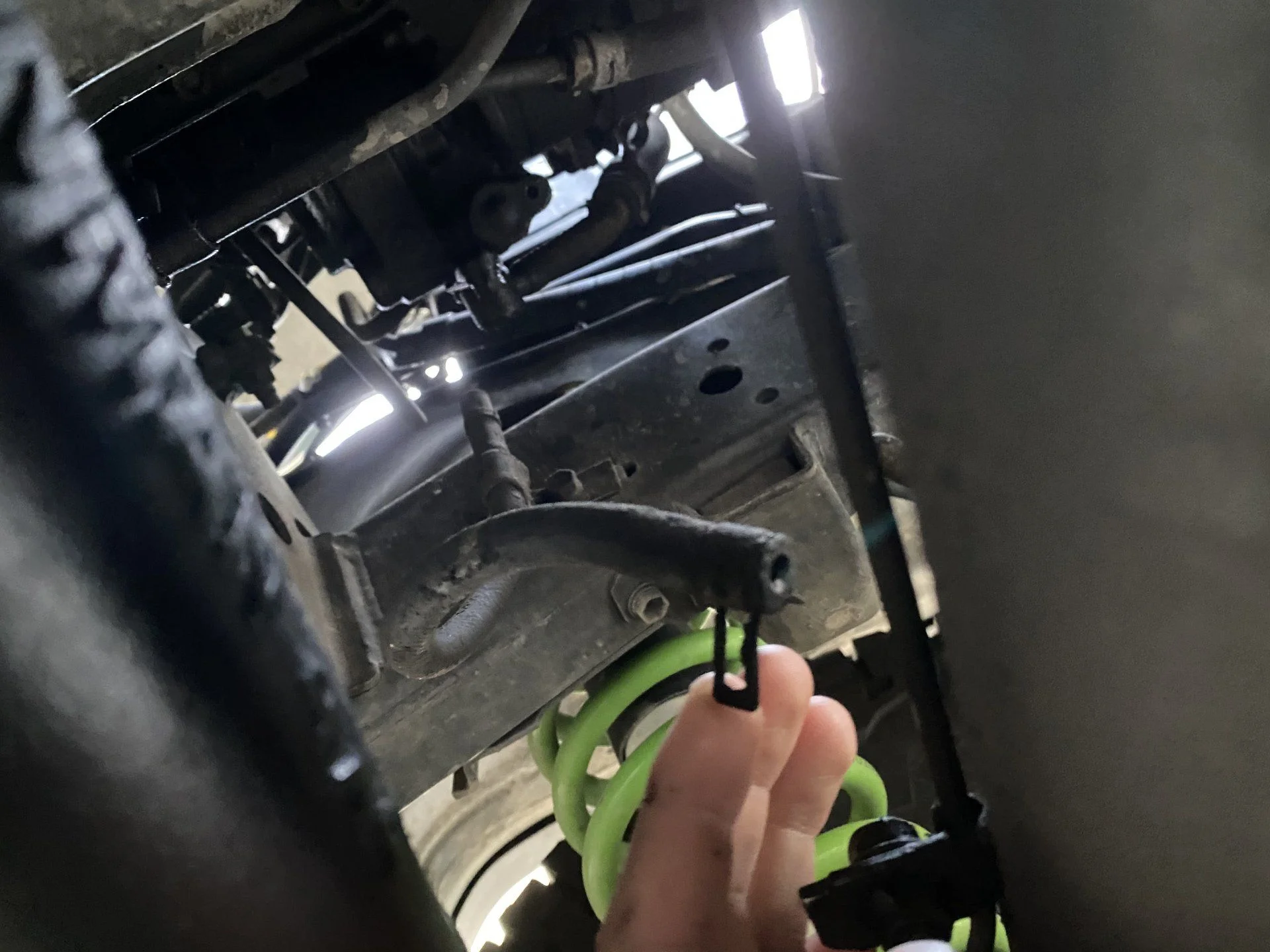

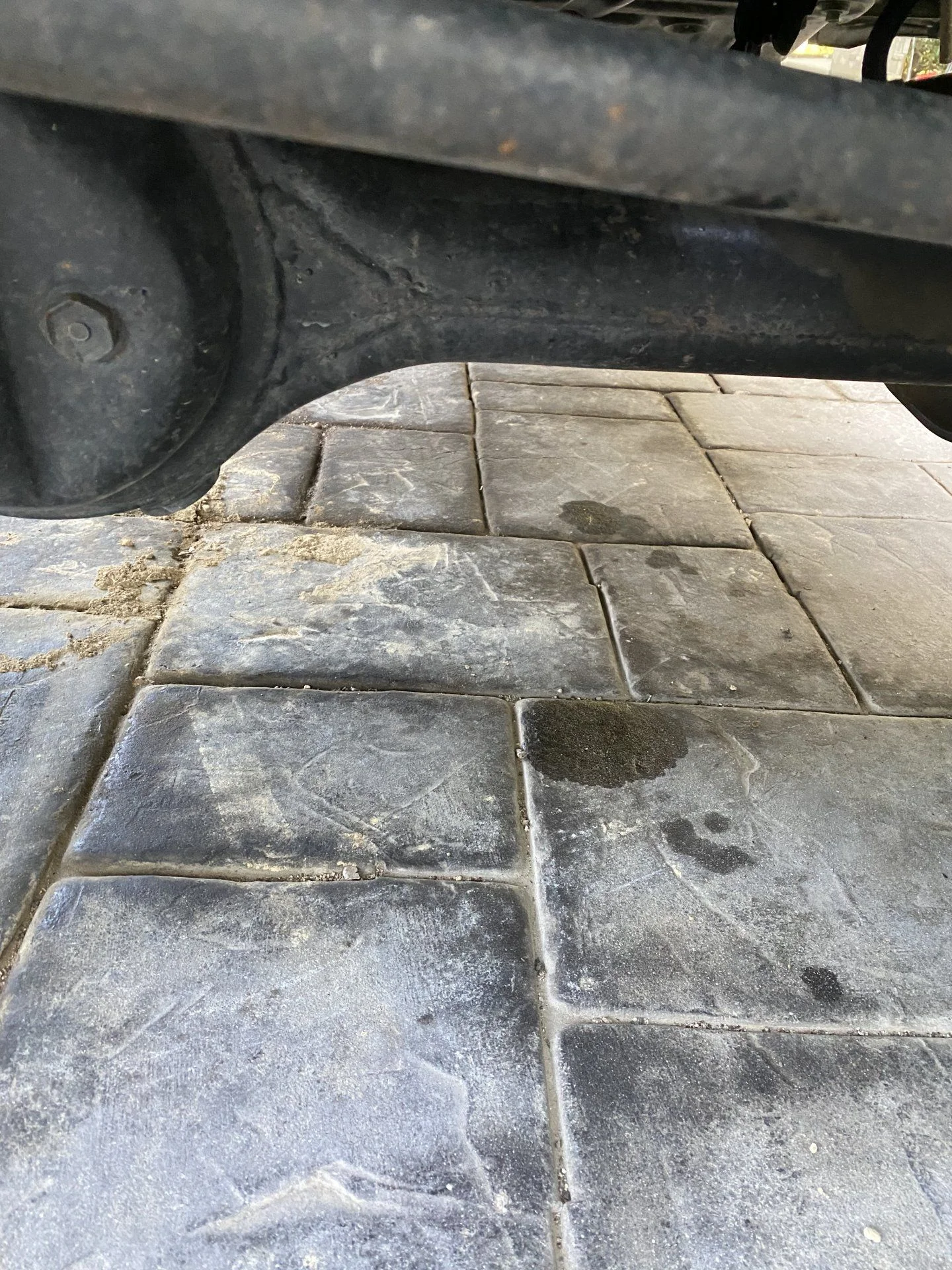

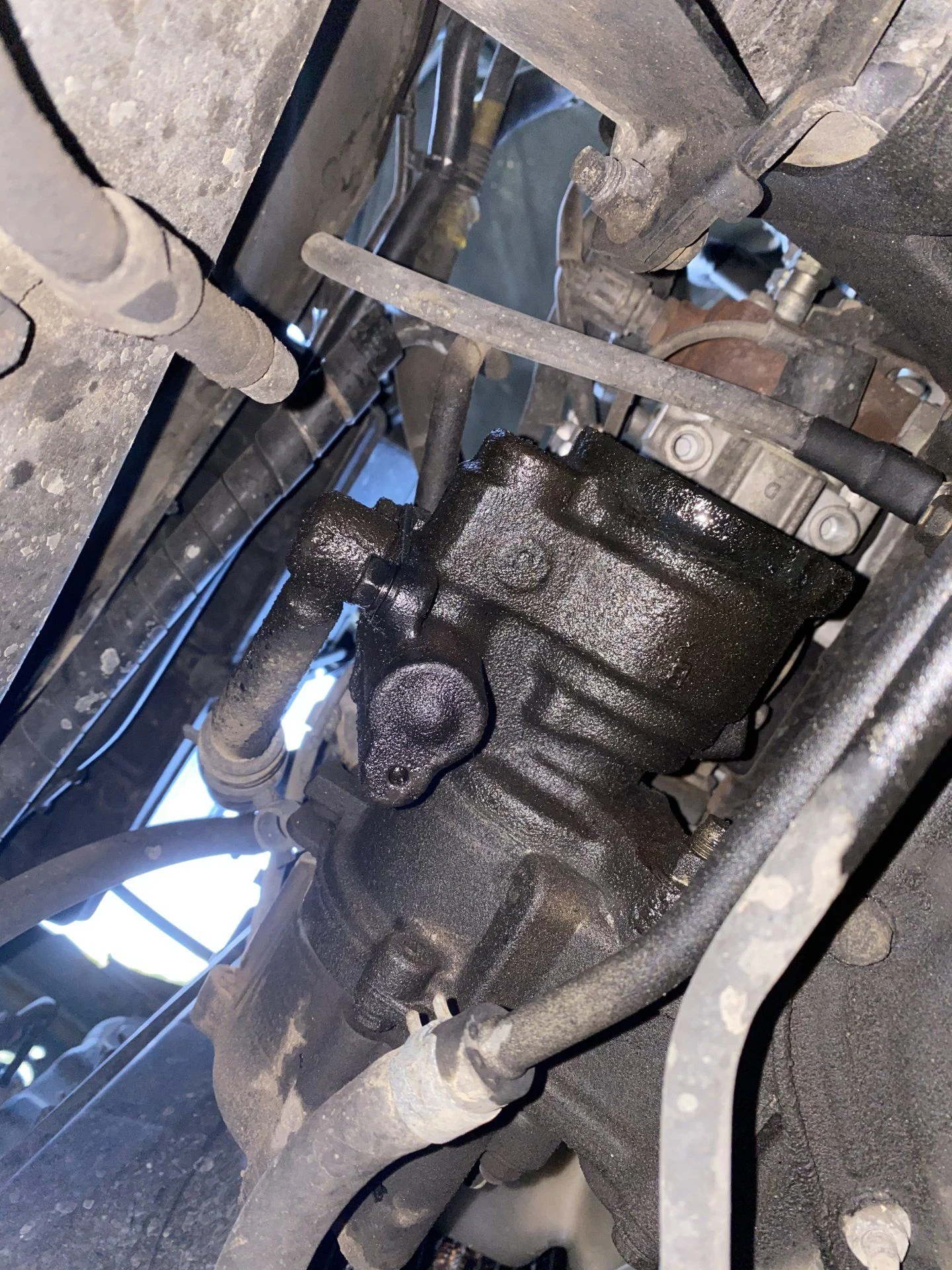

Anyone know what this leak is coming from on my land cruiser? Coming from the front left side, looks like it’s from whatever that is right in front of my left motor mount. Also any idea why I have this tube that’s attached to the frame but isn’t going to anything on either side? Thanks-

That hose is from your front axle breather.
Check your front axle on the left. There should be an elbow fitting. The hose should be attached there.
The clamp is still there.
You may want to change your front differential oil.
