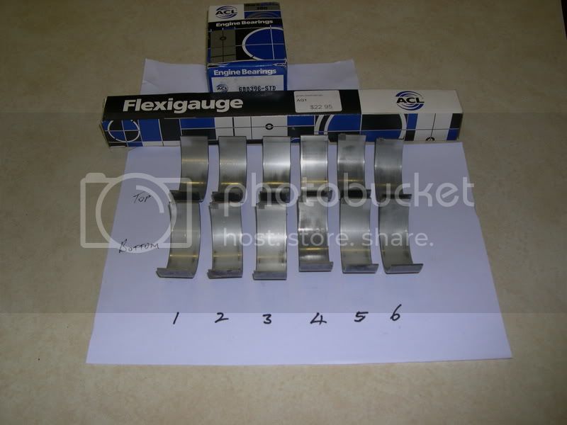

I don't understand why people like you come on here and write crap like you have done:rolleyes:. So get your facts right before posting rubbish. The ACL bigend bearings [part no, 6B8396std] have no known faults like the original bearings supplied by Toyota. There is also quite a different idle vibration between the indirect injection of the 1Hz and the direct injected 1HDT. And as Rosco pointed out compare the bearing load from the piston on a 1HDT at 10 lb boost and a 1hz at atmosphere at the same revs, lol, perhaps that is why the 1HDT develops a lot more power.
These bearings came out of a 1HDT that has done near 300,000Ks so it seems good oil plays a part also.
