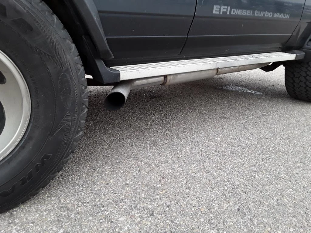

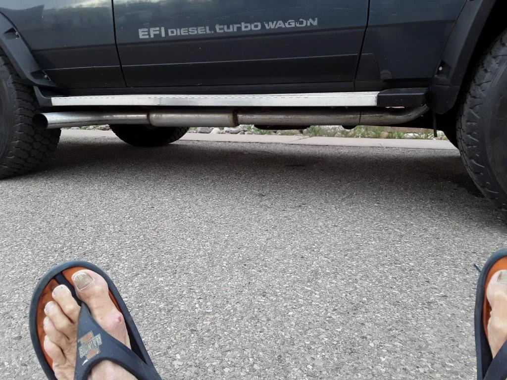

Does anybody know if I can get a whole exhaust system for HZJ73? Mechanic is saying the whole thing needs to be replaced. Cruiser outfitters is recommending I go with a custom fabricated option and the mechanic is offering that but they don’t recommend it since it’s so expensive.
You can still get these parts new OEM from Toyota, overseas.
But, the cost of shipping will be 3-4 times the actual cost of the parts.
Custom fabricated was quoted around $1500.
I don't know about stainless, but I just had an entire custom exhaust fabbed up for me at a muffler shop in 2.25" aluminized steel for the 3B Troopy.
All new from the exhaust manifold flange back to the LR corner.
$500.
That included a new flow master muffler.
$500.
Nothing wrong with that, aluminized exhaust tubing is much cheaper, typically mig welded (faster). Good economical option, especially for a non-turbo application.
That’s a good price, 304 stainless will last forever if done right.
thanks for bringing up the stainless, didn’t even think to ask. Their solution was aluminum so I reached out to a custom shop that is doing it in stainless. Plus they’re saving me money because the mechanic was saying I needed more than I did.
