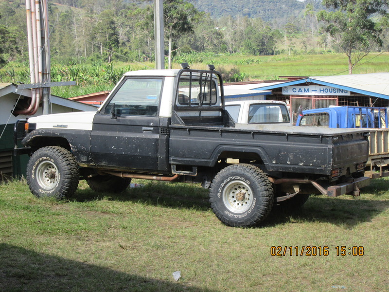

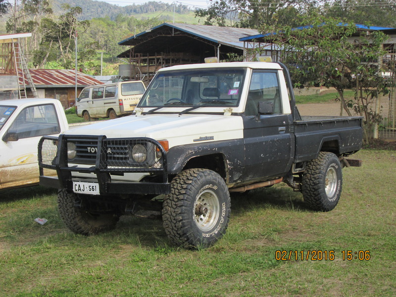

We borrowed the wheels and 33" tires off of my very possibly dead FJ45 project:
Also we had a chance to get it muddy today--I hear that there was video taken, I'm trying to get ahold of it.
video was pretty much worthless, though the man driving the truck in the mud says it wasn't any harder to drive than the diesel was. We also got the chance to load it down with a heavy load of lumber and it didn't even seem to know it was there. There's something to be said for doubling your hp and adding 33% to your torque...

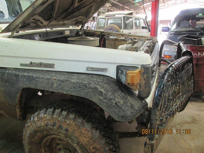

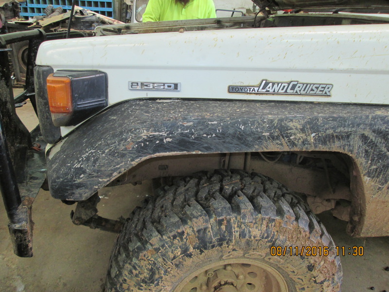

Finishing touches--I picked up a set of "8/350" badges off of eBay for cheap. I think they were originally on a late '60's early '70's Chevy pick-up:
Engine break-in is nearly done, we still need to take it for a long-ish drive. Had it in the mud yesterday after work, just playing around with it, trying to find the flaws. Seems to work every bit as well as it did with the diesel in it. Working on uploading a video, but it's not going well.
Nice touch. Used on the fenders up to 72 and then in the grille 73 and up.
