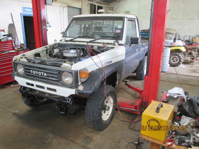

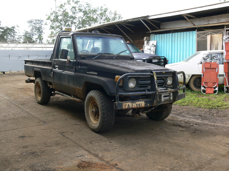

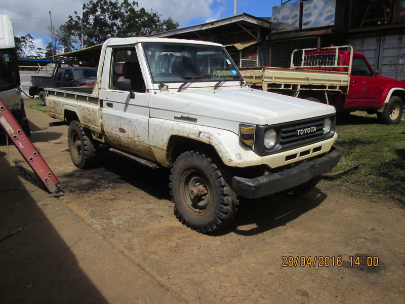

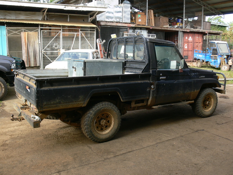

Here is the truck we started with:

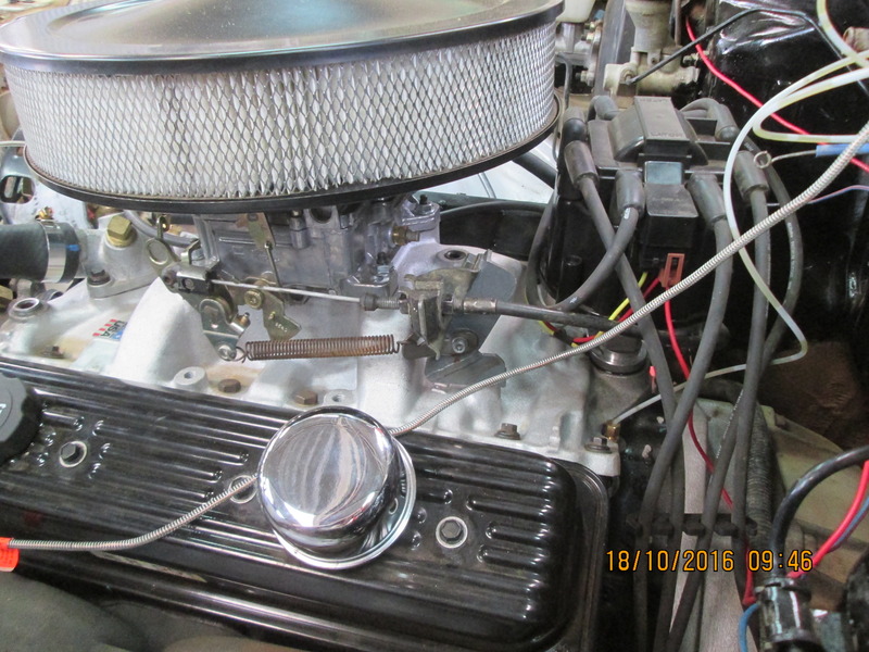

Yup. We went with an Edelbrock 1405, (600 CFM, 4 bbl, mechanical secondaries, manual choke) it's a remanufactured one that cost a lot less than a new one and so far we've got no complaints. We also went with a simple HEI, all self-contained, no external computers. Outside of the ones inside the distributor, the only sensors on our whole engine are the sending units for the water temperature and oil pressure, and those are old school gauges--the only wires going to them are the ones that power the backlights.

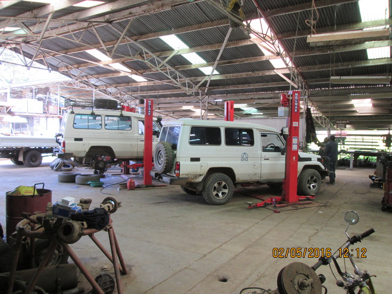

For the curious, here's a pic of a pretty typical day in our shop; we see a lot of Land Cruisers:
At one time the organisation I work for had three of these HZJ75 utes, a black one, a white one and grey one. The white one was the oldest, but had the fewest miles on it. They were hard miles though, as that truck got used mostly for driving out in the bush. Anyway, we retired it and stripped it down for parts to support the black one and the grey one:
As this thread unfolds, you'll see bits and pieces of this white truck popping up here and there.

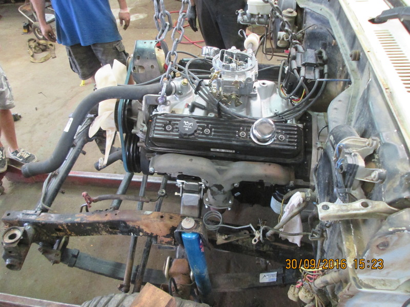

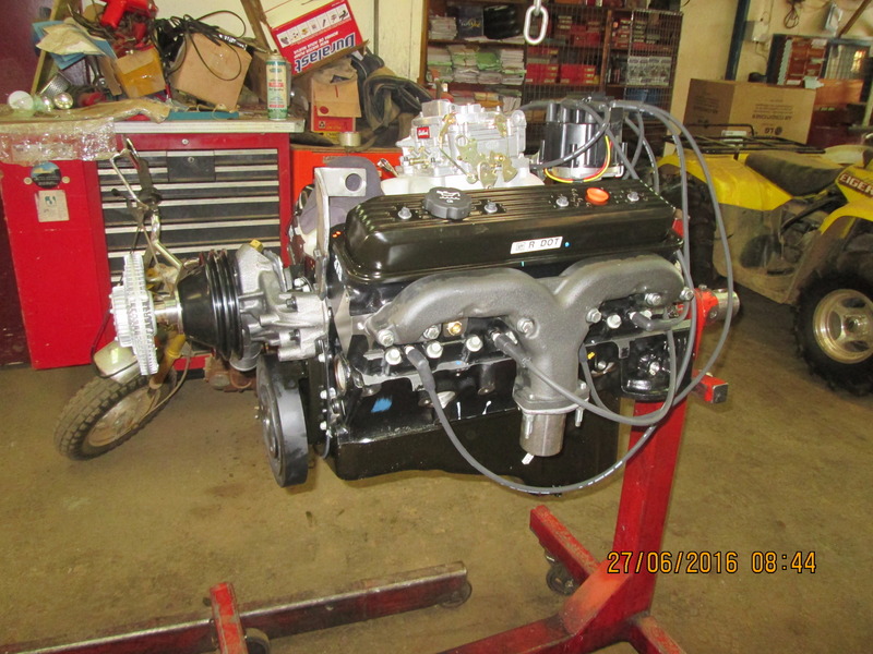

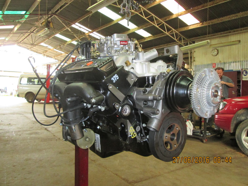

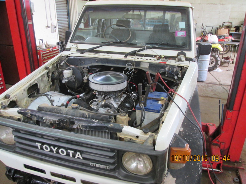

Here's our engine:
Never mind that fan clutch--we discovered that with minimal modification a NOS Mitsubishi fan clutch we had laying around the shop actually fit on the Chevy, but we felt that it was too long to actually use, so we took it back off.

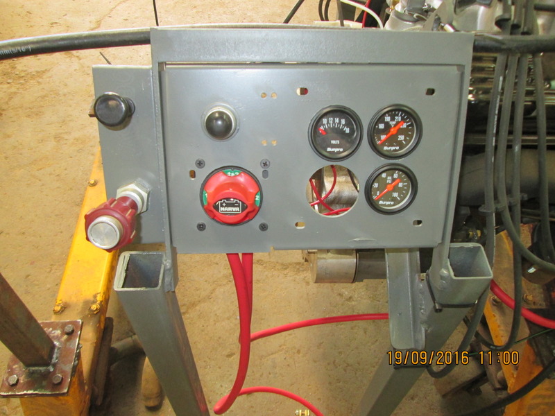

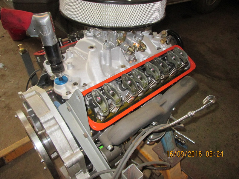

Oil system primed:

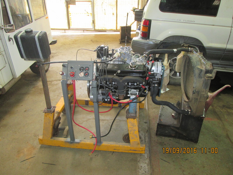

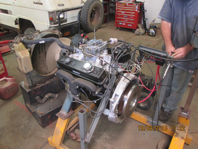

Ready for breaking in the camshaft--the engine stand is one that was originally made for running in Continental TSIO-520 engines for Cessna 206 aircraft, but we modified it for the Chevy, since the guys who used to use have switched to turbine powered aircraft and didn't need it anymore:
My co-worker, Ben (he's also on MUD but I forget his handle on here--he shows up in the background of a lot of these pictures and in truth he did most of the work on this project, I just helped out here and there, and perhaps more importantly I was the boss who approved the Chevy conversion), anyway, among many many other things, Ben built this instrument panel for the run-up stand--the aircraft throttle was a nice touch:
Breaking in the cam--there was a miss in the engine at this point that took us a little while to figure out--turned out to be a timing issue, but I suspect that the open exhaust manifolds didn't help either--certainly once we got the timing right it smoothed out and just got smoother once we got a complete exhaust system on it:

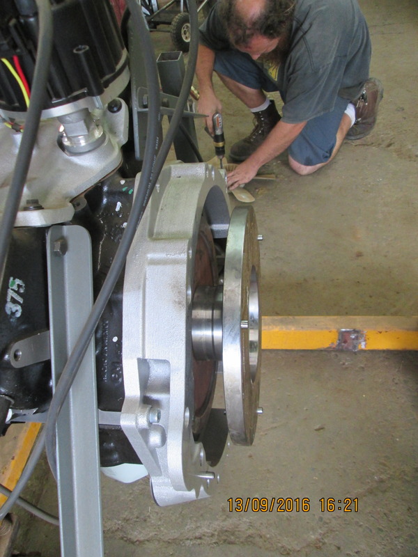

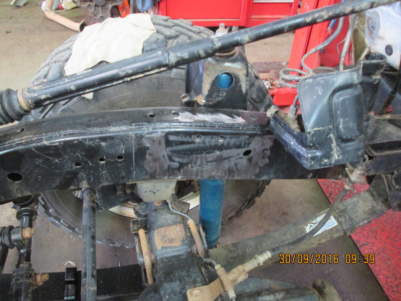

HAd to remove the original engine mounts to install the ones from Mark's:

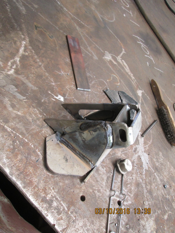

Trial fitting. At this point we discovered that those nice looking motor mounts from Mark's didn't actually fit! This was probably the biggest surprise/curve ball that we experienced during the conversion. The engine sat way too high in the frame and in fact when Ben experimentally tried fitting the prop shafts/drive shafts he found that they simply wouldn't line up. Kudos to Ben for even thinking to try that, I admit I might not have thought to try that:
Once we had the engine lowered to where the driveshafts actually would line up properly, about 1-2 inches of the engine mounts were hanging off of the bottom of the frame. Clearly that wasn't going to work, thankfully we are also a fabrication shop, so we just modified them to work. Here's one in the process of being modified, you can see the original mount with our new gussets welded to the outside of it, later the bits of the original mount that hung off of the bottom were trimmed off:
And here's what it looked like finished--we tried to keep the slotted holes that Mark's had engineered into the mount at the same angle that Mark's intended, though I have seen others here on MUD who have taken different approaches:

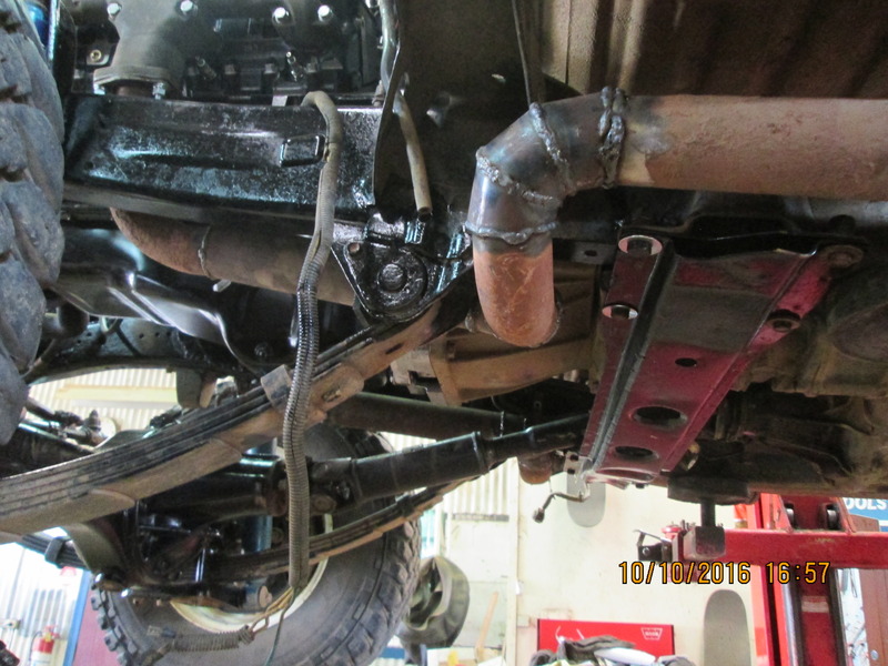

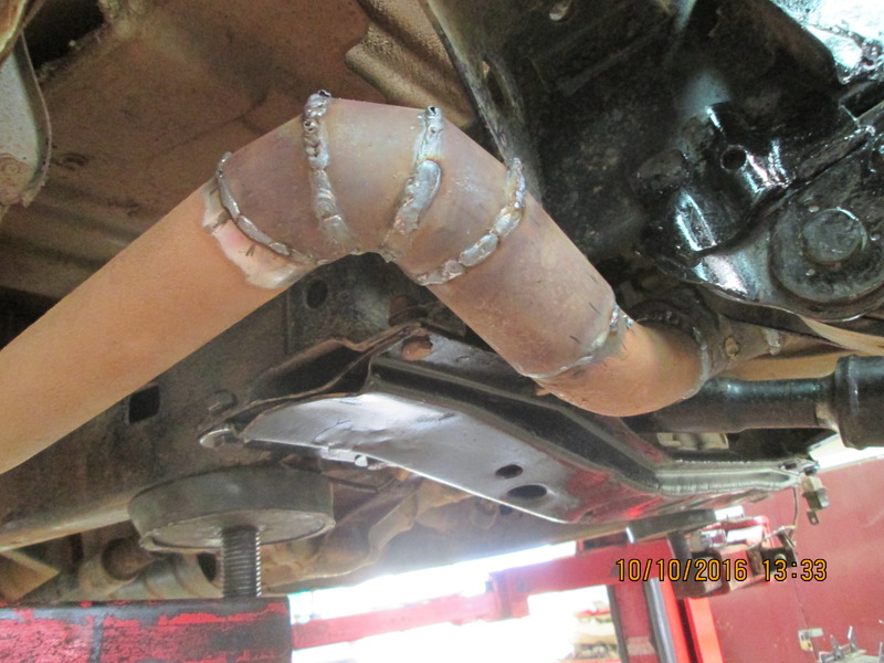

Then came the exhaust. Ugh. Would you believe that we could find no supplier of exhaust pipe here in PNG? Our options were:
--to spend a ton of money having some shipped in from the US or AUS by DHL (that'd still take a month to get here)
--get them cheaper if we had them shipped here by sea freight but then it'd take 3-4 months to get here, OR

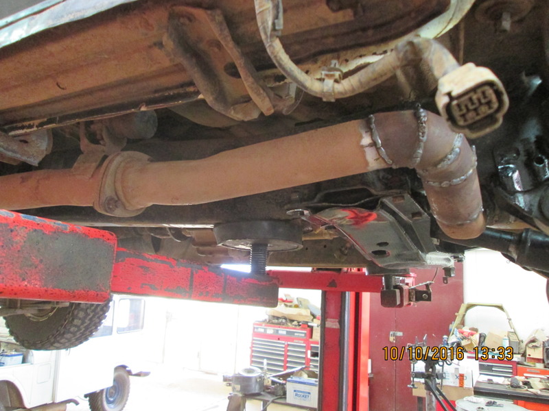

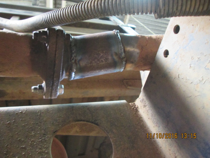

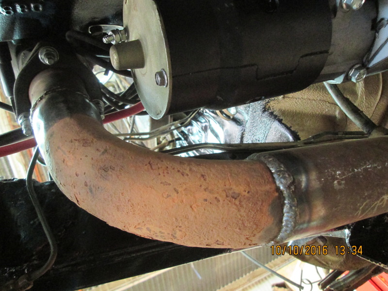

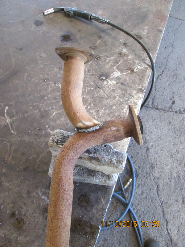

--chop up a piece of 2.5" straight pipe that we had and make bends out of it. Ugly? YOU BET! But it will do for now. There are maybe half a dozen of these really hideous bends in the system, and yes, I could have made them nicer looking, but at this point in the project we were just wanting to get the truck done, since we need it running for work:
Since we had 2 complete HZJ75 exhaust systems in good condition, we were also able to salvage a lot of bends from those. On the right side we only had to get from the manifold to the already existing exhaust pipe that runs outside the frame under the right side door:

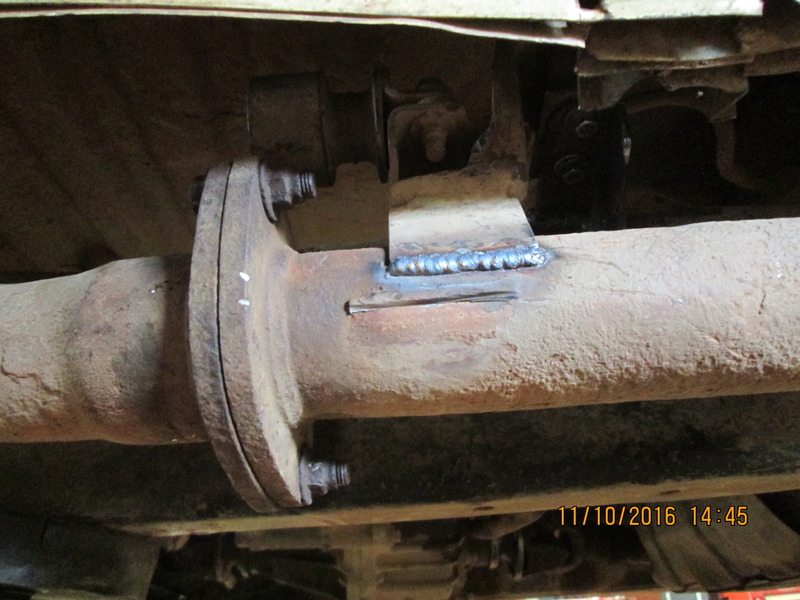

Starter can still be removed without having to remove the exhaust, same is true of the front rear spring pins:

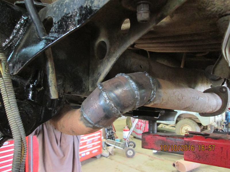

But on the left side we ended up using our "spare" exhaust system (salvaged from the white ute) to try to make a mirror image of the right side. We even went ahead and engineered in those goofy rubber dampener things that Toyota seems to be so fond of. I mean, why not? We had them, the right side had one, may as well build one into the left side, too:
Was there a better way to route the exhaust? Probably. But this is what we came up with and what we figure will work for us.

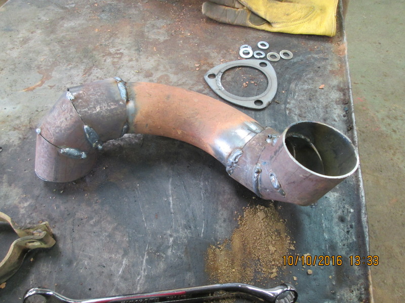

So it's basically dual exhaust all the way back to the back of the cab. At that point I made this Y pipe, and went ahead and built in the flange so that we would have a place to be able to take it apart. The finished exhaust can be separated into 5 or 6 big pieces, with 2 or 3 bolt flanges at all the joints:
Unfortunately I screwed up in one of my measurements and ended up with this funny little jog that I'm not real happy with, though honestly I don't think it's a problem, it just bugs me:
We stuck with the original 1HZ muffler, it is HUGE and so we figured it'd probably be alright. Turns out it works just fine, we were all very surprised by how quiet it is, especially considering how noisy the old 1HZ was.
GEtting closer! And wow, look how much of that ratty old white ute made it on to the black truck:
I really like the old style grille better and happily it was in better shape than the original one. While we were working on it, we went ahead and replaced the cab mounts, since some of the cab mounts needed repair, it worked out for us to make up our patches out of 8mm steel, in effect giving us an 8mm body lift kit. :) The whole truck looks somehow "happier" now, certainly it is standing up higher in the front, maybe because it just lost 200 pounds switching from the 1HZ to the 350? Or maybe it's just all the white body panels:

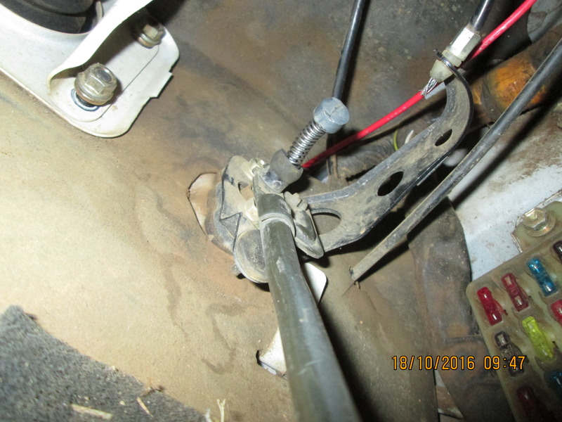

I made up a bracket that adapted the original HZJ75 throttle cable and throttle cable mount to the 350. I also made up a way to mount the LC cable to the Edelbrock carb by cutting up a broken motorcycle front brake lever (cable operated brake) and using the part that the brake cable used to fit into to mount the end of the HZJ75 throttle cable. The return spring was too stiff at first, I ended up having to lengthen the anchor point:
Somehow in the process of making this bracket, I goofed again--I set everything up just so so that there would be a correct amount of slack in the cable, but somehow when I installed it all I ended up with too much slack, like an inch too much(!). Then I tried to take up the slack by adding this stiff little spring to the pedal end of the cable, (admittedly not one of my better ideas):
Anyway, that didn't work, it made the throttle feel really weird, so I took it back out and then discovered that I had enough adjustment in the cable to take out most of the slack anyway.
