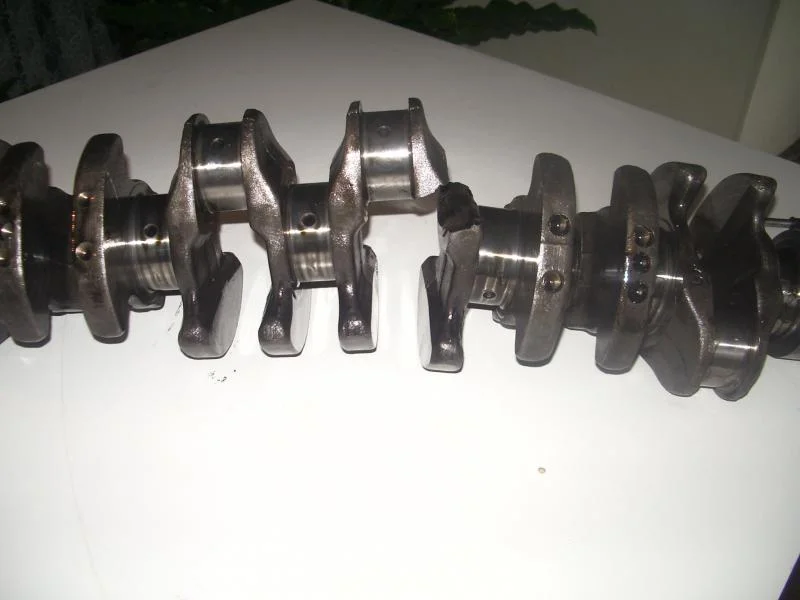

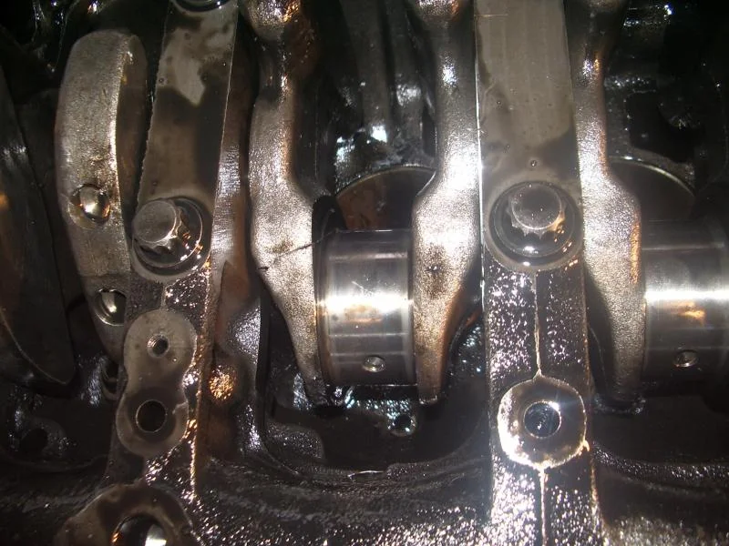

I've got a 1991 'Cruiser with the 'bullet-proof' 1HDT donk. It's showing 246,000km (I've put 80,000 on it since purchase) and I have also been chasing a noise in my car very similar to what has been described. Regardless of oils etc, nothing appeared to fix the problem. Had Reco injector pump, new injectors, glow plugs etc. Always serviced.
I suspected Beb's, although I still had very good oil pressure and it did not knock when started cold.
I also suspected the clutch, as I could feel it very slightly through the pedal.
I was told the valve adjustment didn't really change too much & besides, the ticking was inconsistent.
To cut a long story short, I think the actual problem reared it ugly head on a deserted hwy 31st of Dec (sample of my year :crybaby:)
What began as a slight rattle which I could feel more predominantly though the clutch pedal as the day progressed, suddenly turned into a ferocious banging, grinding, wailing noise as I was legging down the hwy).
Clutch was now 1inch from the floor and motor (and wife) was shaking quite a bit. Immediate inspection revealed no oil leak, so it hadn't cocked a leg.
Thankfully I'm not the only guy who needs money, and I managed to track down a tow truck who towed me 150+ kms back home.
Ripped the engine out and down, suspecting Crankshaft issues, and guess what?? It had snapped completely in half HORIZONTALLY between #4 B/E and M/B :bang:. I have never heard of this happening on a Toyota. Especially with the km's!
Nobody has answers. Most (including myself) suspect a flaw in the casting.
I've put some pictures on to show you, as most don't believe me.
I truly hope that I am the only guy which has this issue, although it worries me from what I read.
Should also mention the cab noise - all along, it has been quite noisy (engine wise). When the little ones are in the very back seats, they have to talk quite loud for us to hear them. It is (was) probably 50% louder than my diesel 60 series (2H). From what I've seen and understand, this will hopefully shut the thing up. A mate has an identical truck and says that he can hear road noise. I never could...
I'm in the process of doing a complete overhaul and will keep you posted with results.
BTW - I mashed one M/B - all other bearings were in excellent condition. It's got me going...
All the best!

holy crap, first time i saw this happen. nasty and $$$$$$$$$$$$.
the HDT/HZ/PZ all sound like a gasser with a tick, to be louder than a 12HT should have been a sign of "WTF?" but if you didn't know how one should have sounded then how would you know?

Might be a good time to junk the whole ill-concieved (IMO) 1HZ converted to direction injection idea, otherwise known as the 1HDT and get a plain old 1HZ from Ens Industrial or somewhere (mine truck?) and put on a turbo kit like the one I posted about a few years back and be done with the BEB voodoo for ever!
Toyota in their wisdom decided that the bearings didn't need to be any bigger to support the much higher loading from the much faster ingniting direction injection system.
Loads which are obviously very close the limits of the stock bearings. Without the correct high calcium oils (JDM oils), the stock bearings are prone to failure as you obviously know.
So, if you go indirect injection 1HZ with after-market (but factory approved) turbo, you get the best of both worlds.
Then again, a 12HT would be another option if you don't like timing belts & idlers, for example
I have to agree with Greg, the JDM vs. domestic engine oil is not the issue, it was a bad bearing material application. In some markets the cranks and bearings were done under warranty (some proactive, some not).
If it was a JDM enigne oil vs. other engine oils, then we would not be seeing them arriving here with bad bearings.
