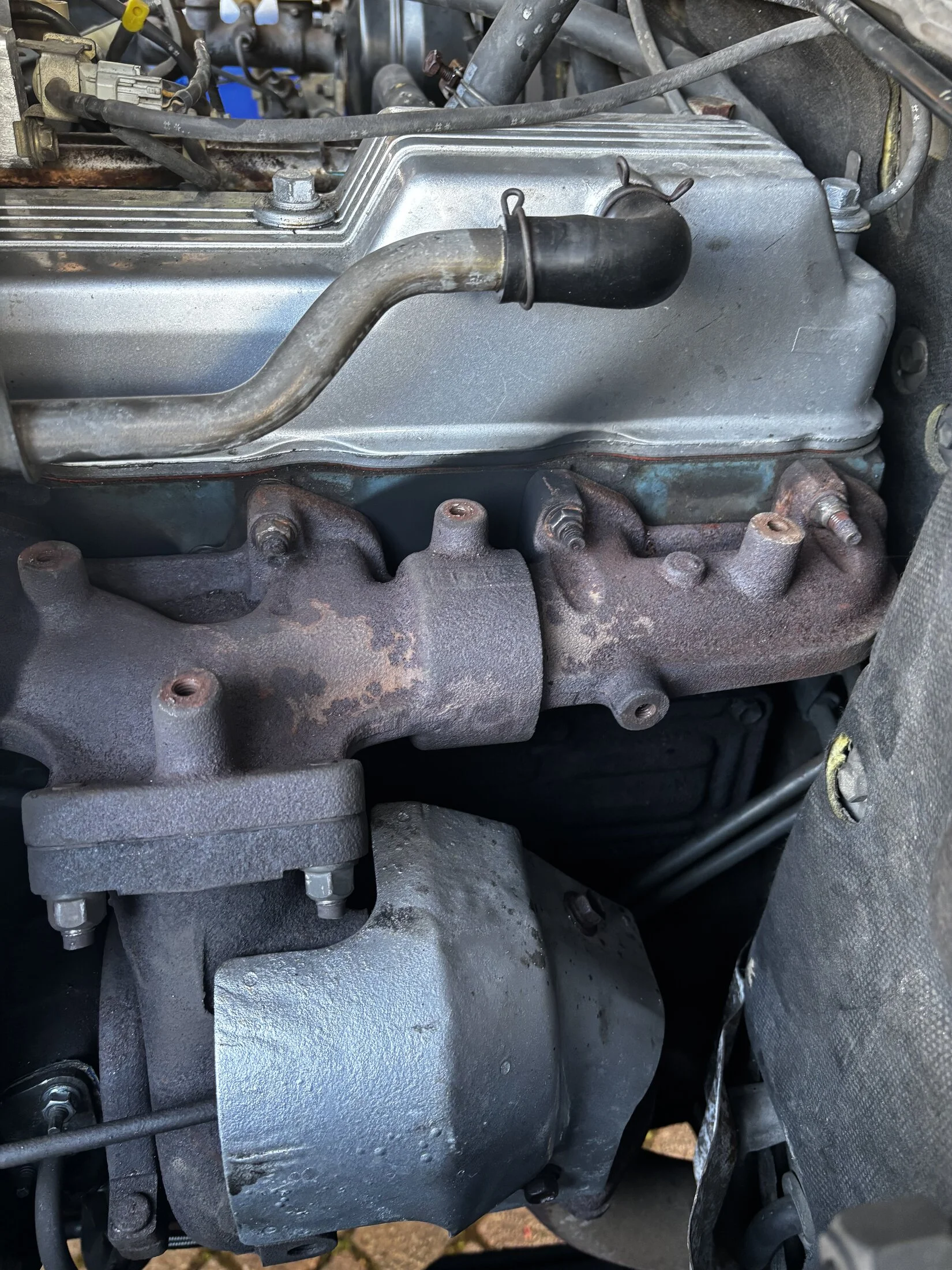

So the shop said it isn’t exhaust and they need another guy to look at it on Monday, they also think the actuator isn’t moving or moving enough.
Was exhaust after all 🤦‍♂️
Well that photo seems to make an exhaust leak rather more likely as the cause.
Wondering if high temp copper rtv on OEM exhaust gaskets should be used to prevent future leaks?
I have ordered manifold gaskets (not sure they are OEM) also ordered the manifold seal ring set which is OEM. I will take your advice and ask the shop if they will use copper rtv 👍
I have never used sealant on exhaust gaskets.. get a straight edge on your manifold before re-installing - it may need facing off.
