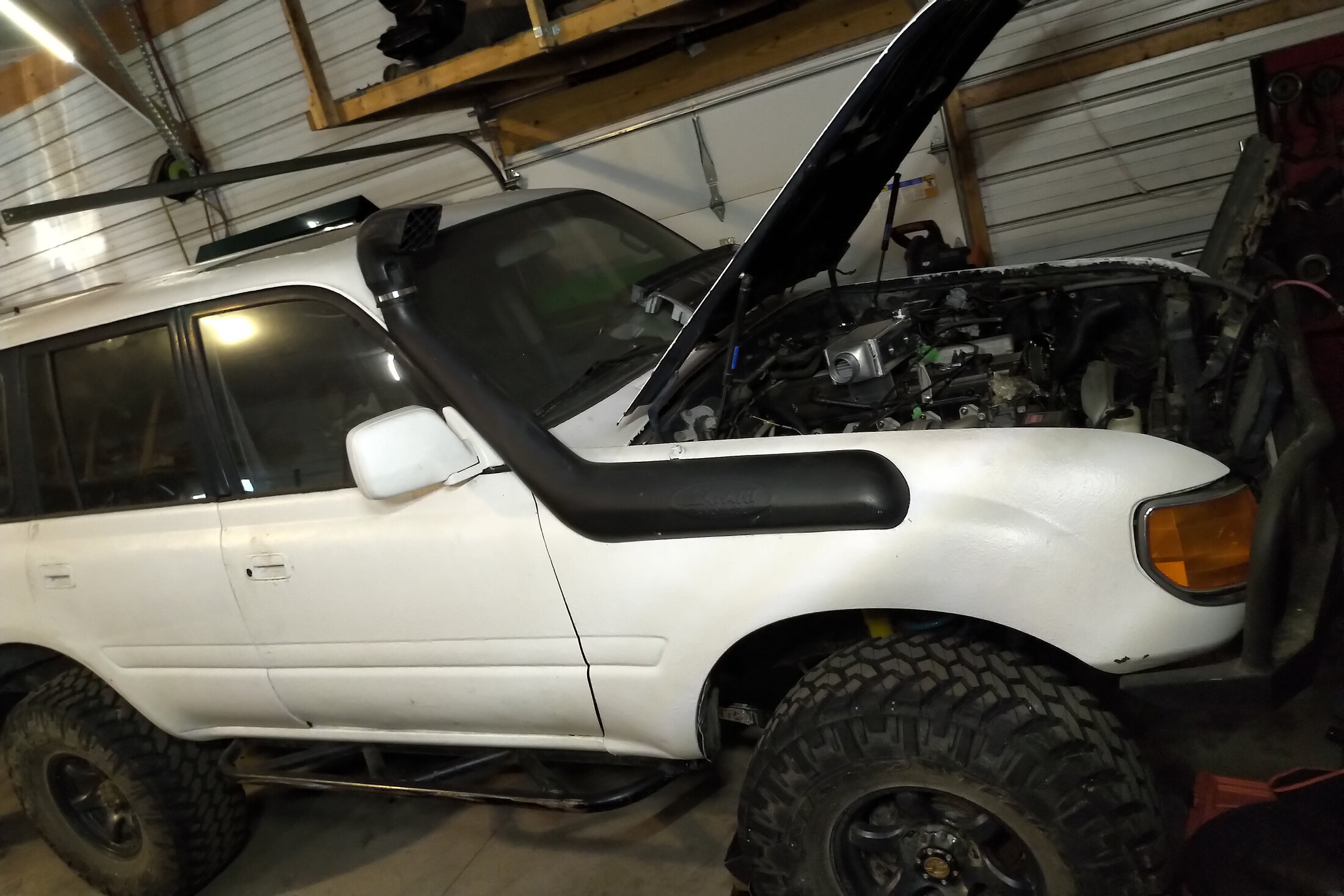

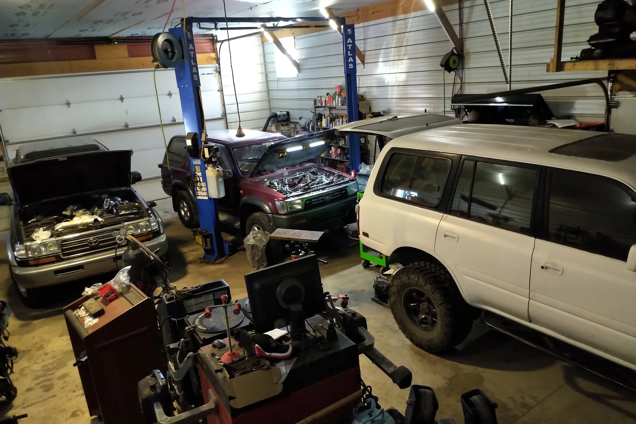

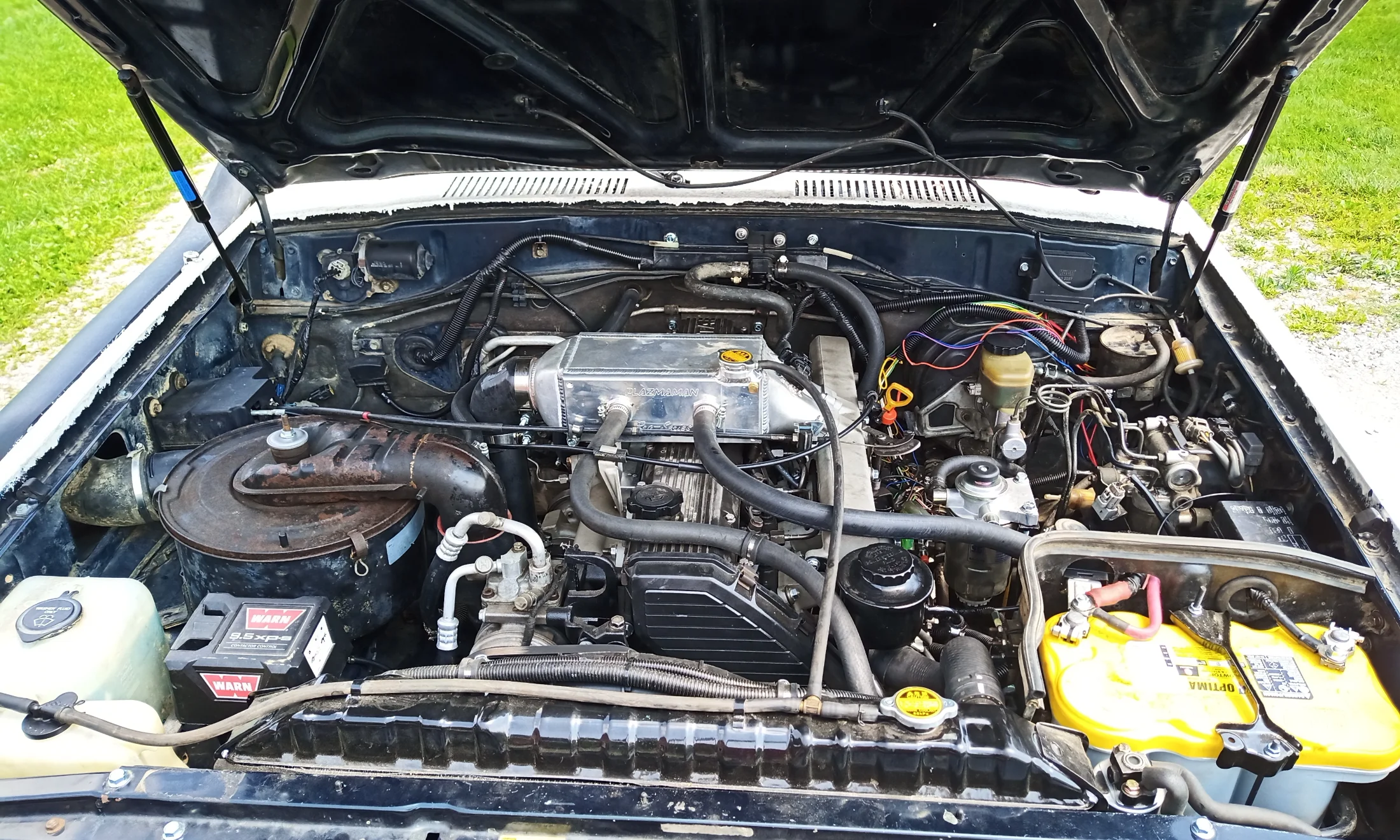

I didn't remember to take pics of the outside before i put it into the shop so here's one:
Always a good day when there are 3 diesel Toyotas in the shop!

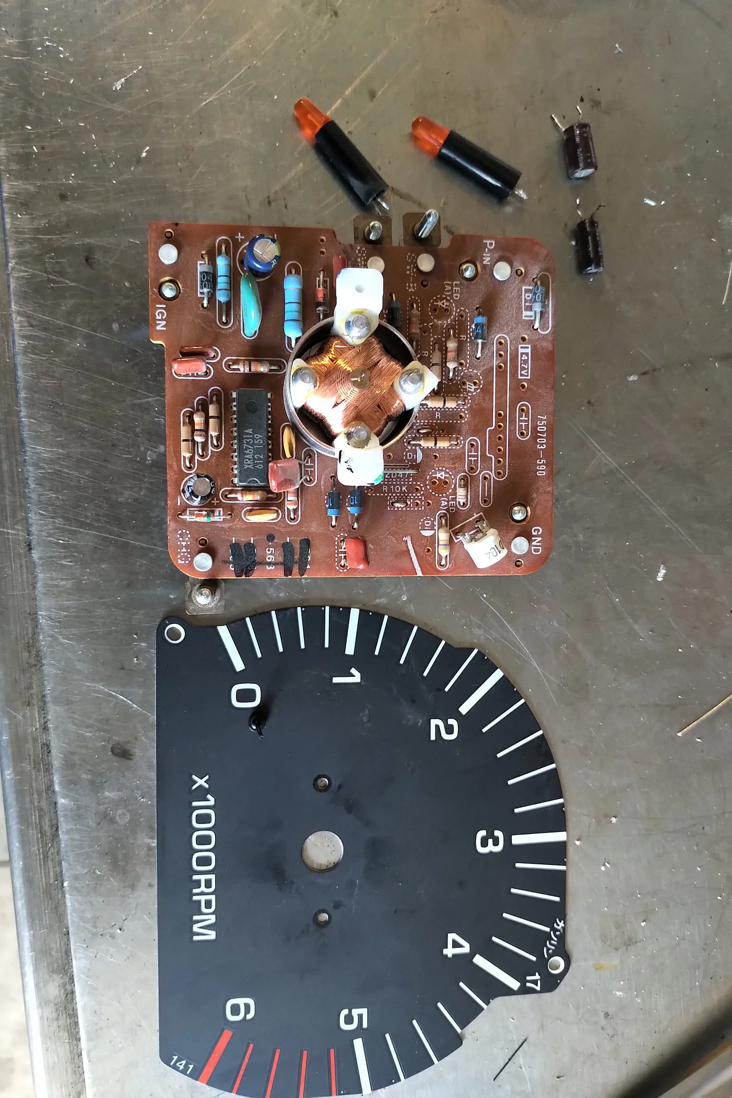

Cluster is ready. took the "turbo" lights off, just going to run the gas tach face-plate over top even though the redline is a little too high. leaking caps on the speedometer, no surprise there, traces are good though, caught it just in time. Put all new caps in the speedo and tach. going to use the check engine light as the glow light.

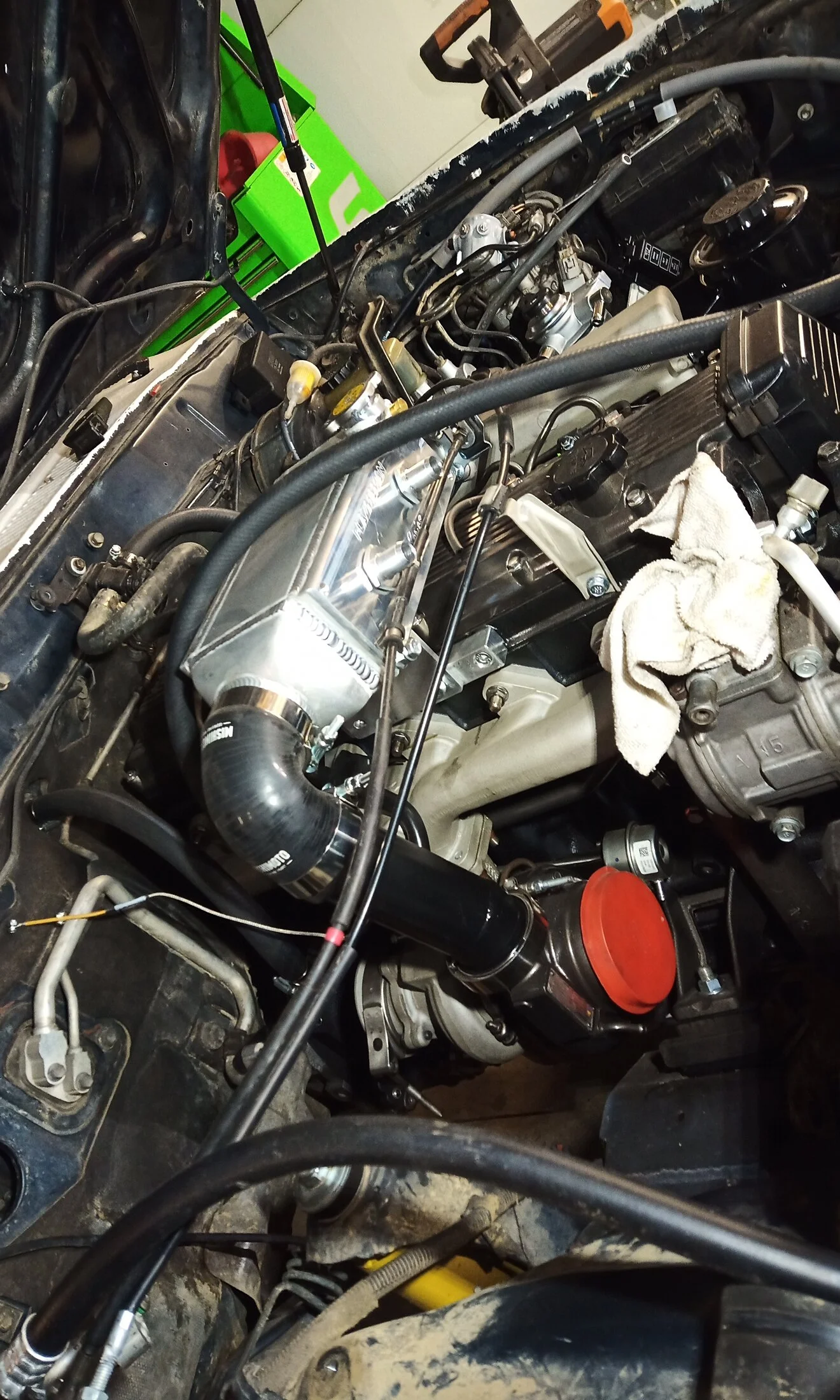

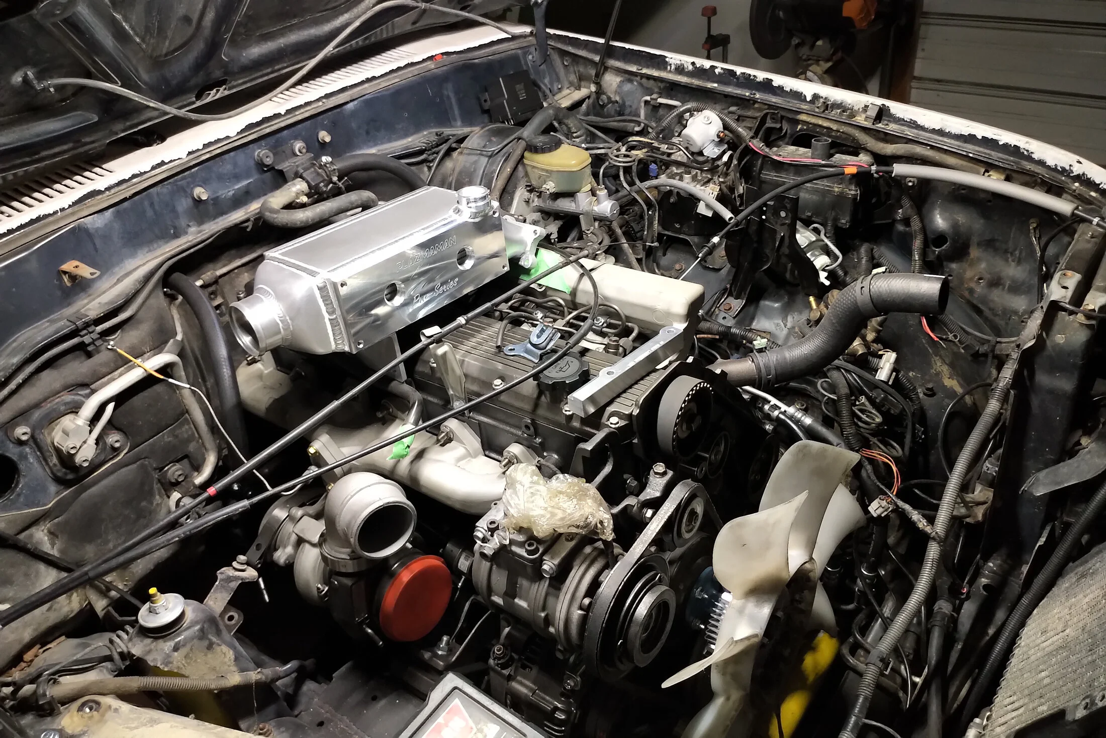

charge pipe to intercooler done:

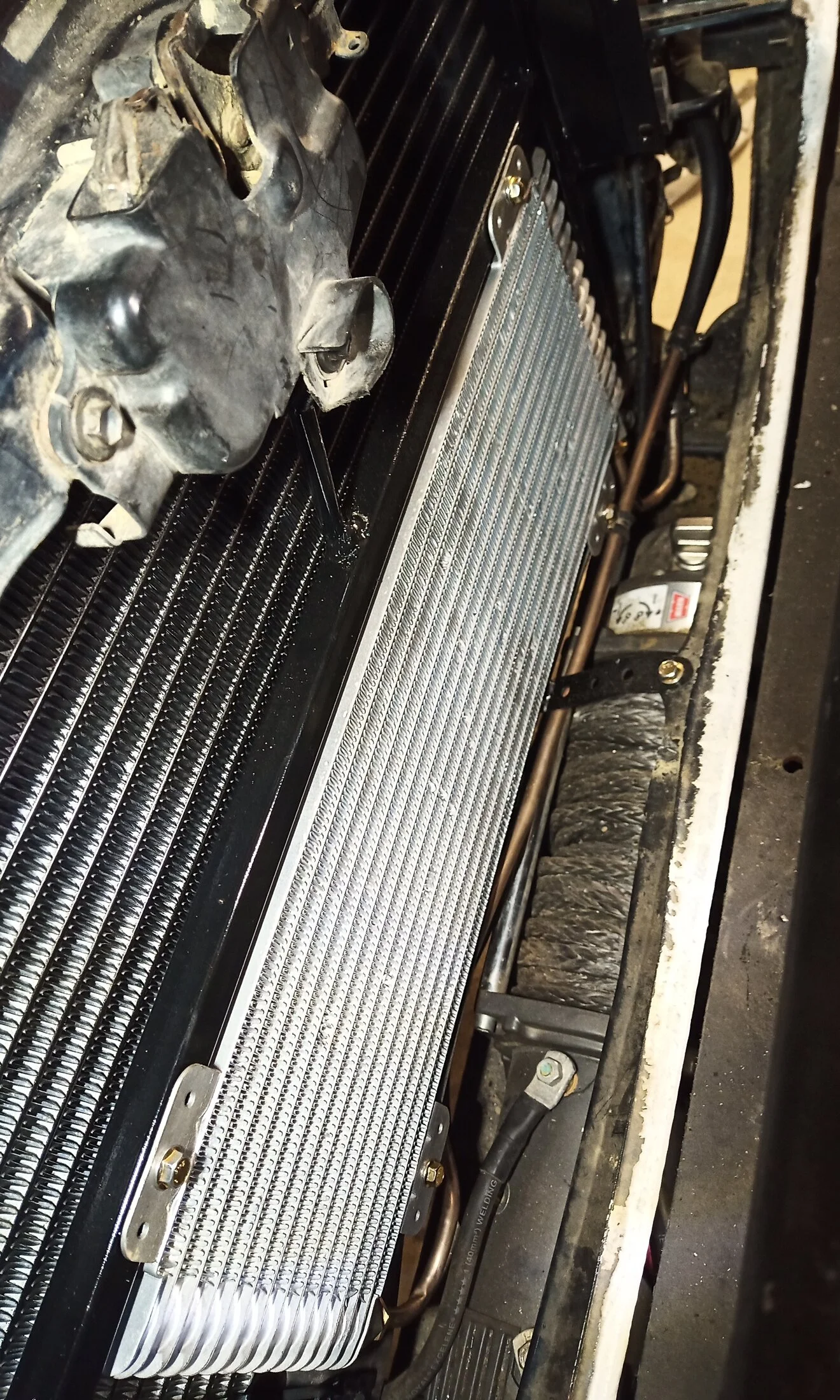

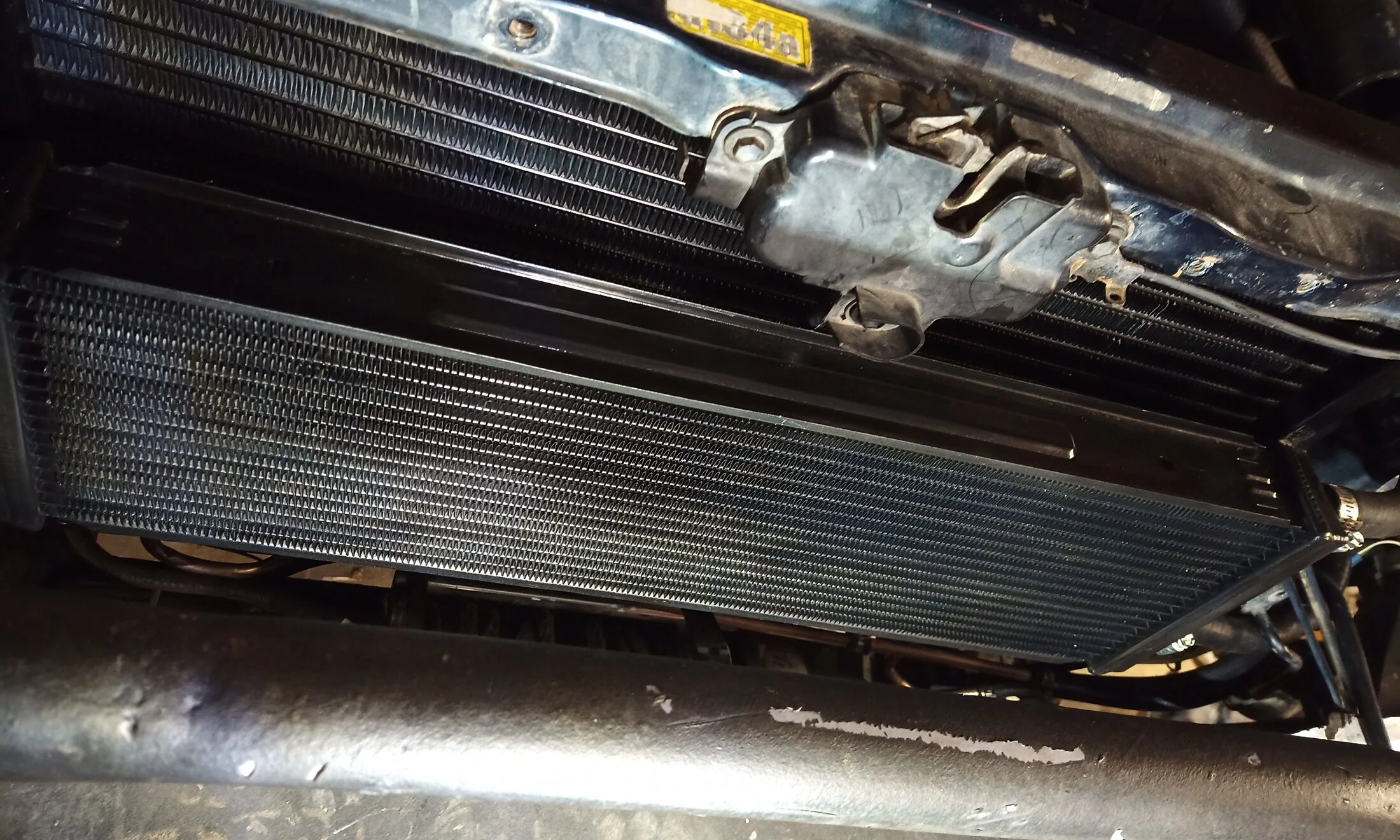

denso AC condensor, derale transmission cooler installed machined the fittings that came with the cooler into AN tube nuts and then flared and bent some copper nickel tube for the transmission lines.
Universal CSF heat exchanger, coated with more KG2400 didn't want the silver showing though the grill
heat exchanger is smaller then the one that comes in the plazaman kit but hopefully will cool down enough for my uses, there is at least an inch of space between the heat exchanger, AC condenser and trans cooler. the heat exchanger is gets the best air from right behind the grill.

Truck is pushed into the corner of the shop, easier to get to the interior then under the hood so I started working on interior. interment cluster done: coolant gauge mod, almost all new bulbs, diesel tach.

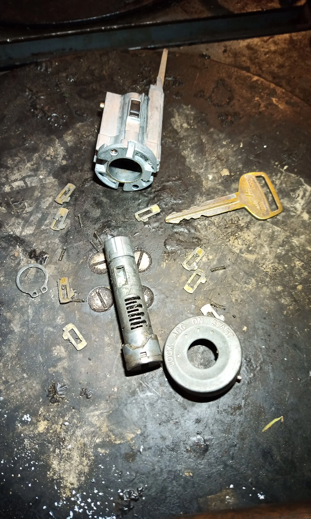

re-keyed all the locks with new wafers, new keys.

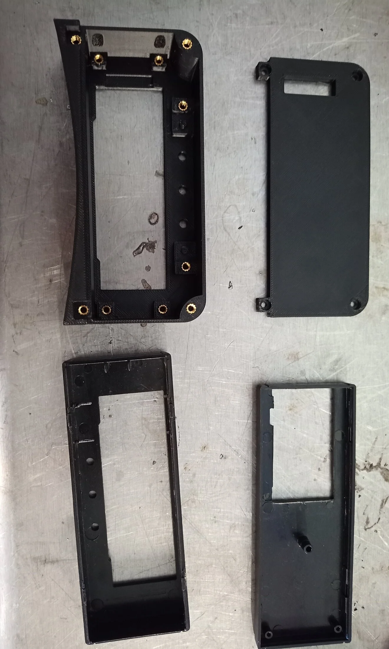

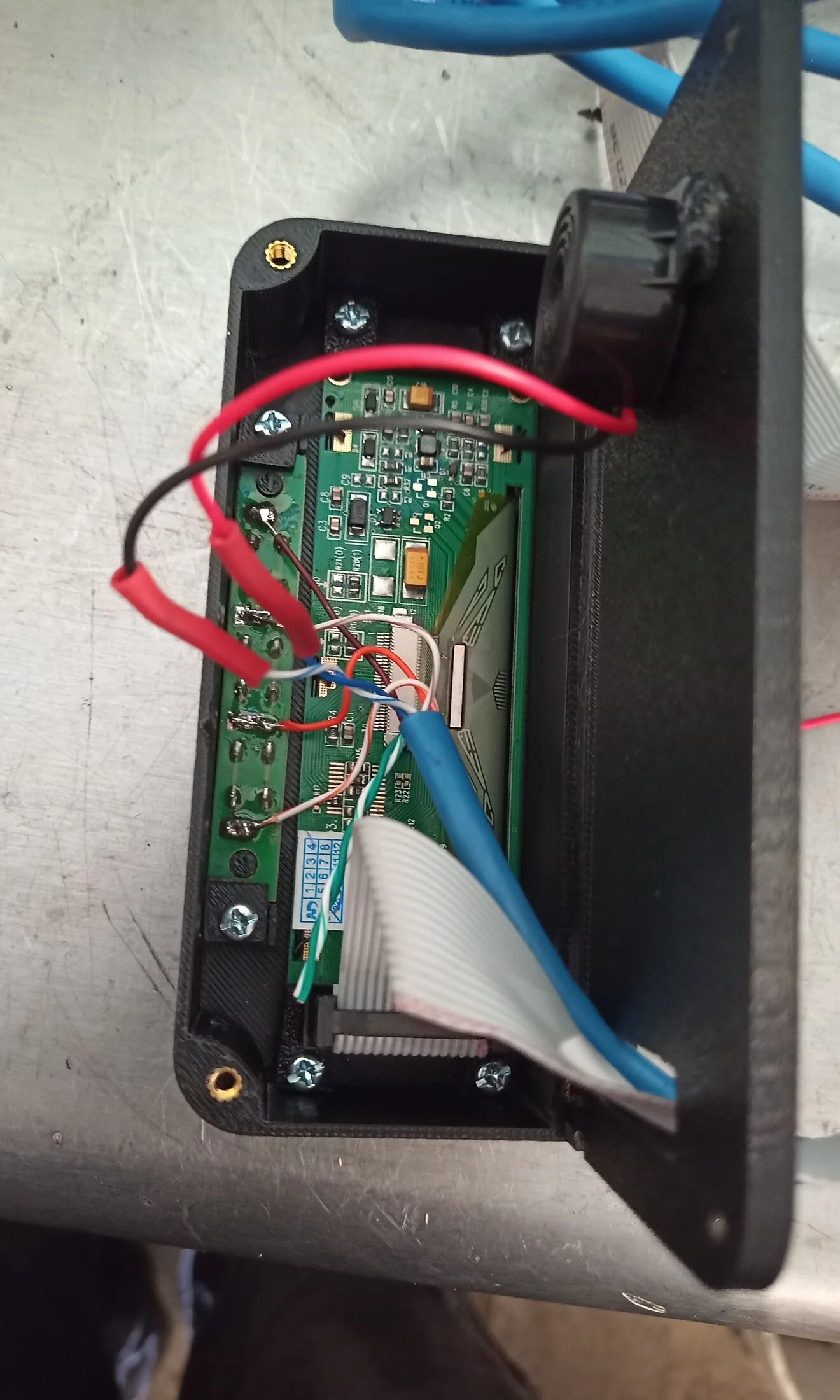

big shout out to @Trail Teq I asked if a UT comp system would fit to one of his steering column mounts. I sent him the screen and he made this great enclosure for the screen and buttons! Much better then the original snap together enclosure (your supposed to hot glue the screen and buttons in place) the trail TEQ enclosure has metal bolt holes and machine screws to hold things in place, much better. Curved base is a perfect match to the steering column cover, nicer texture then your average 3d printed part.
comparison side by side, trail TEQ top ut comp enclosure bottom:
with screen installed, i actually put the warning speaking inside since there was room.(yes i did heat up the shinktube before i buttoned it up)

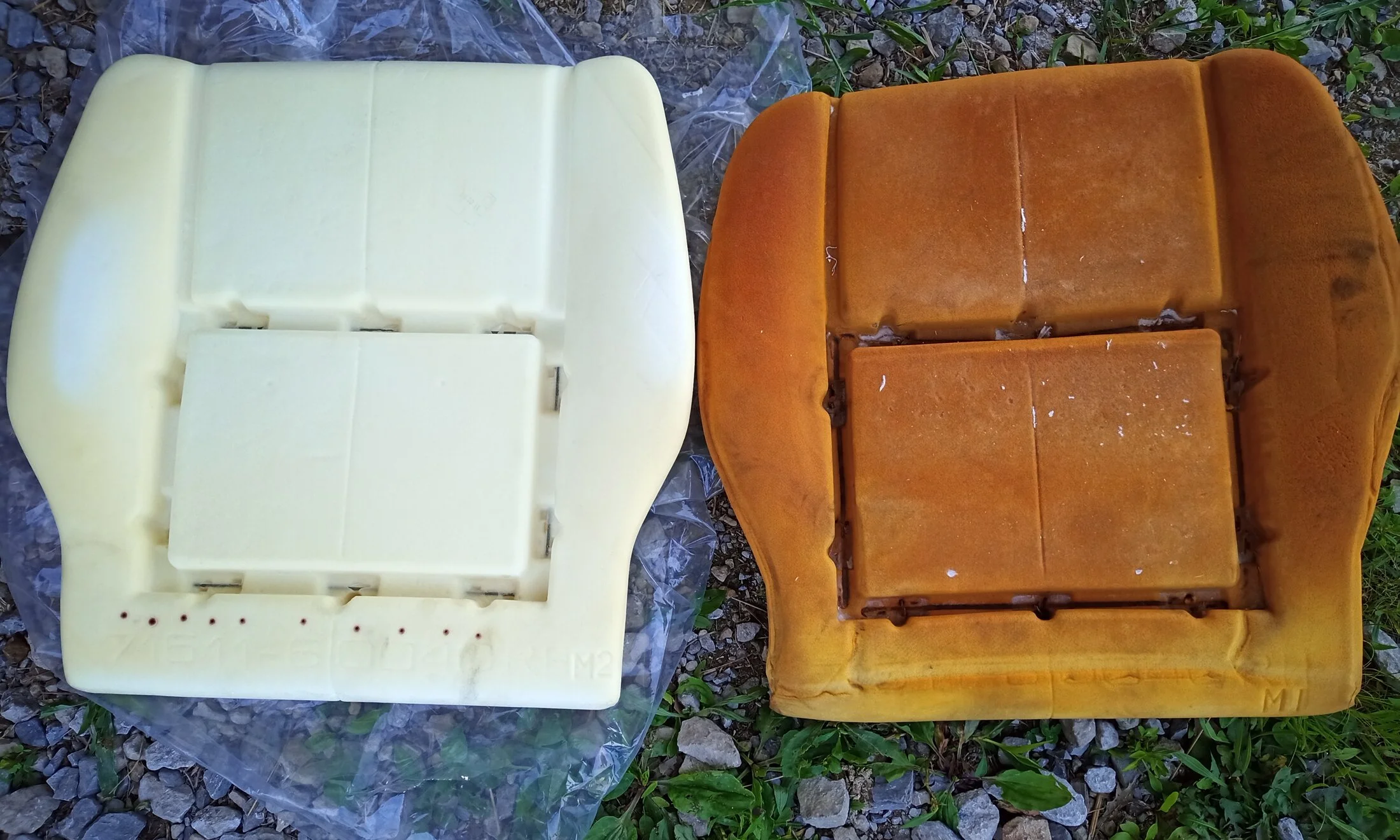

next I moved onto the seats. pretty sure these are 91-92 seats. covers are well worn. driver's seat was repaired once before. thought about putting a pair of corbau seats in would have been alot easier and about the same cost but i decided to repair what i had as i didn't want the seats to end up any higher of a position. Rear seats just deep cleaned with extractor and then covered up with escape gear covers. Front seats totally disassembled. driver's seat had 6 broken welds on the frame. foam repairs in the past cross threaded bolts, etc. Installed new bottom foam, welded frame back together but reused the worn fabric as i wanted to use escape gear slip over covers anyway only option i could find for replacement cloth was landcruiser heaven.

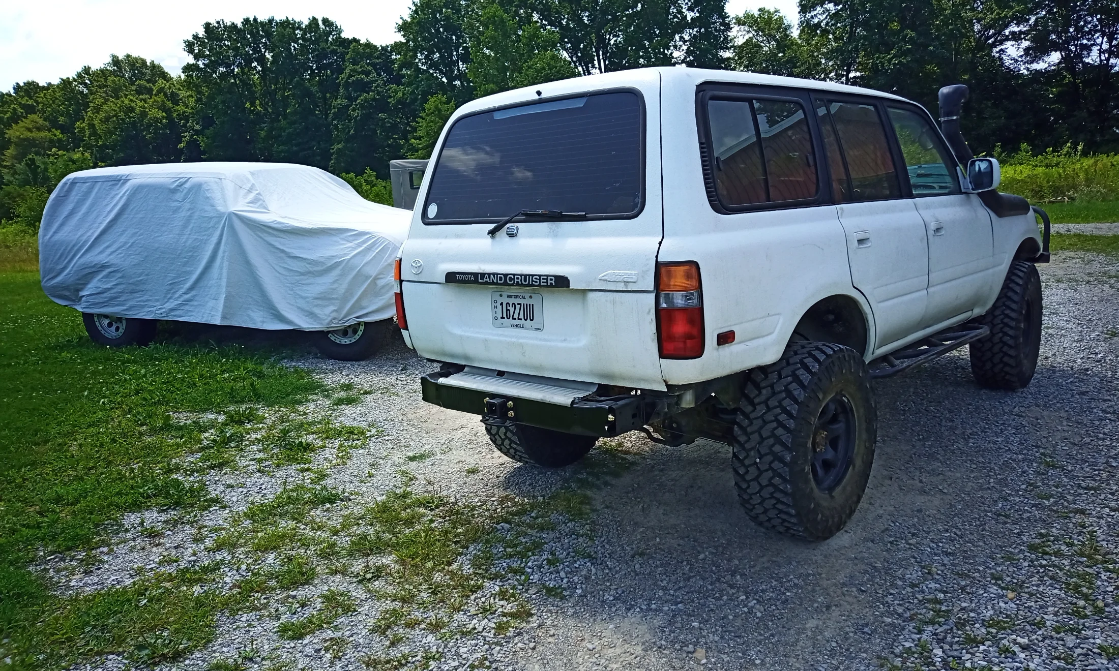

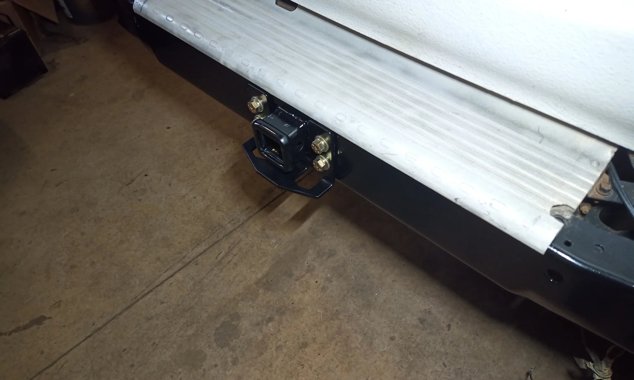

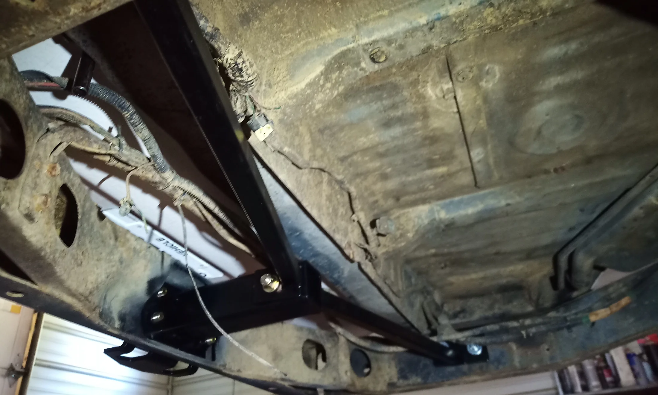

i wanted a strong tow hitch that didn't drop down like most, not ready to commit to a aftermarket rear bumper just yet, settled on the slee hitch. it's designed to be used with their bumper but works great without it.

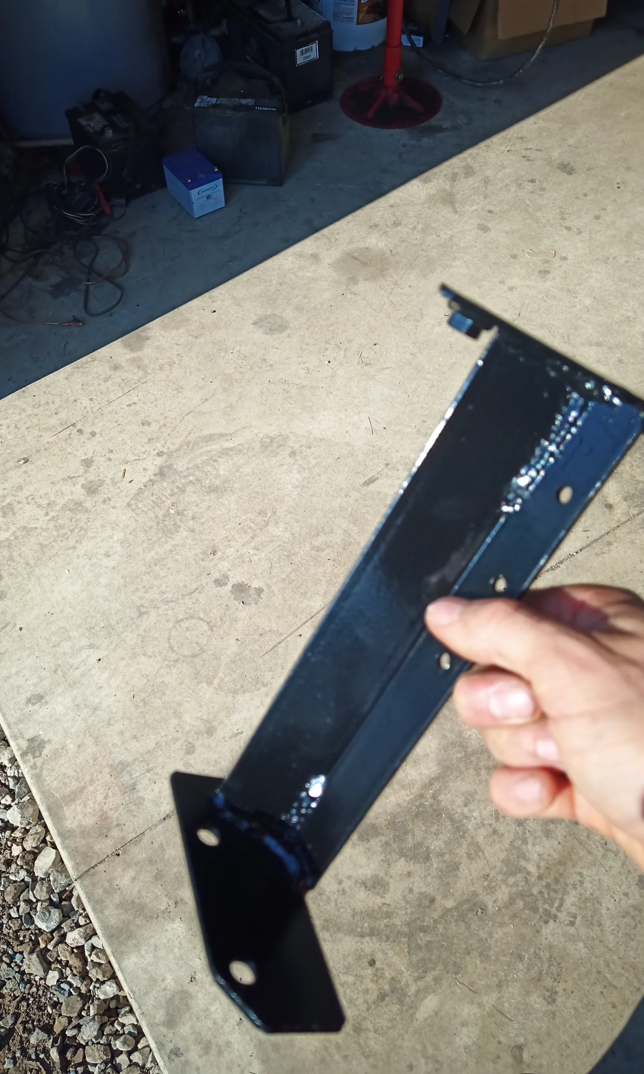

couldn't find anybody selling a fuel filter housing bracket so i made my own

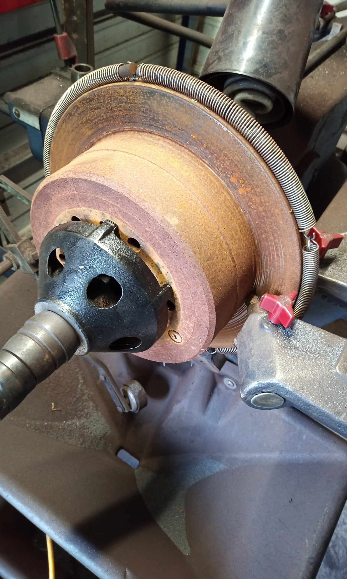

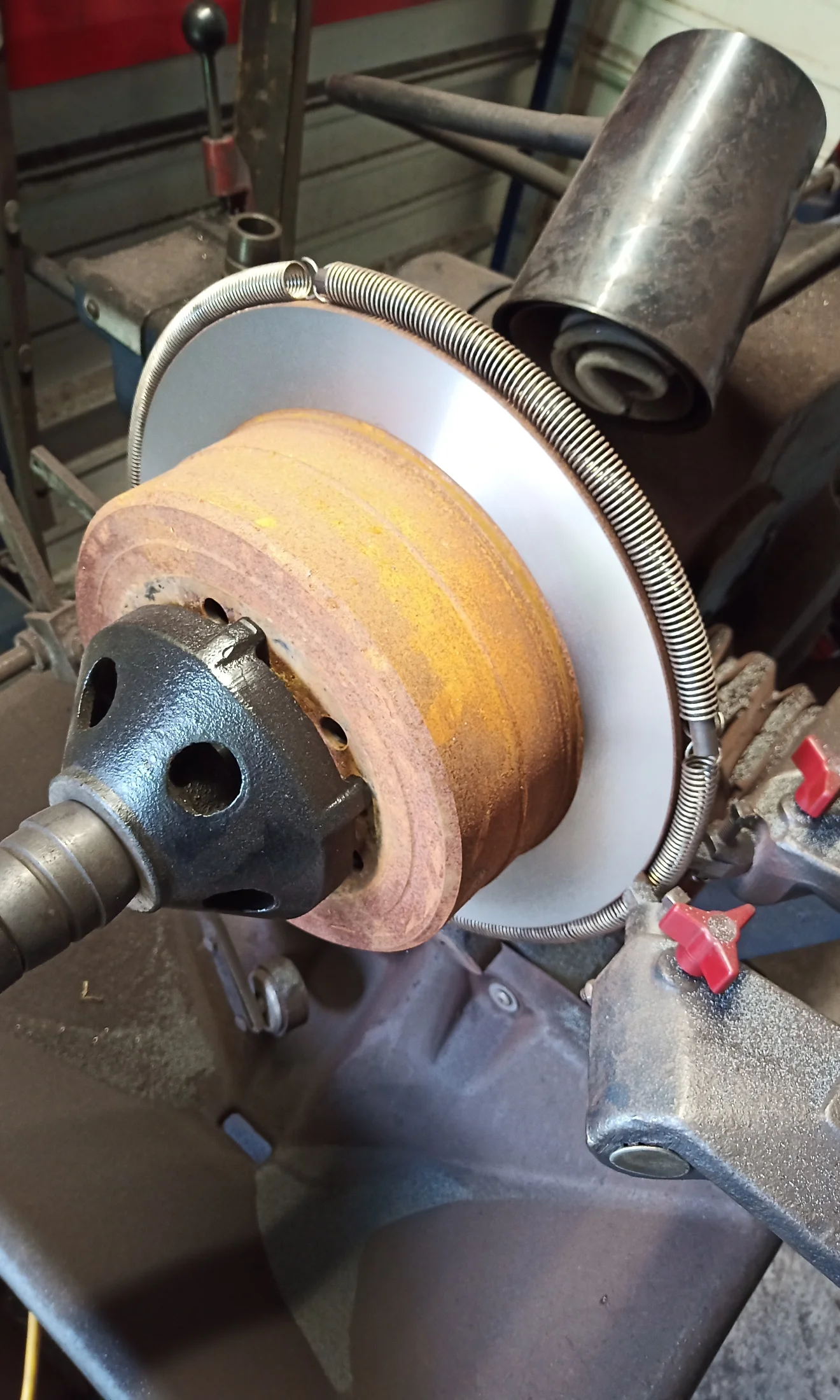

this truck has been sitting awhile, machined all the rotors. new calipers, pads, extened OEM hoses.

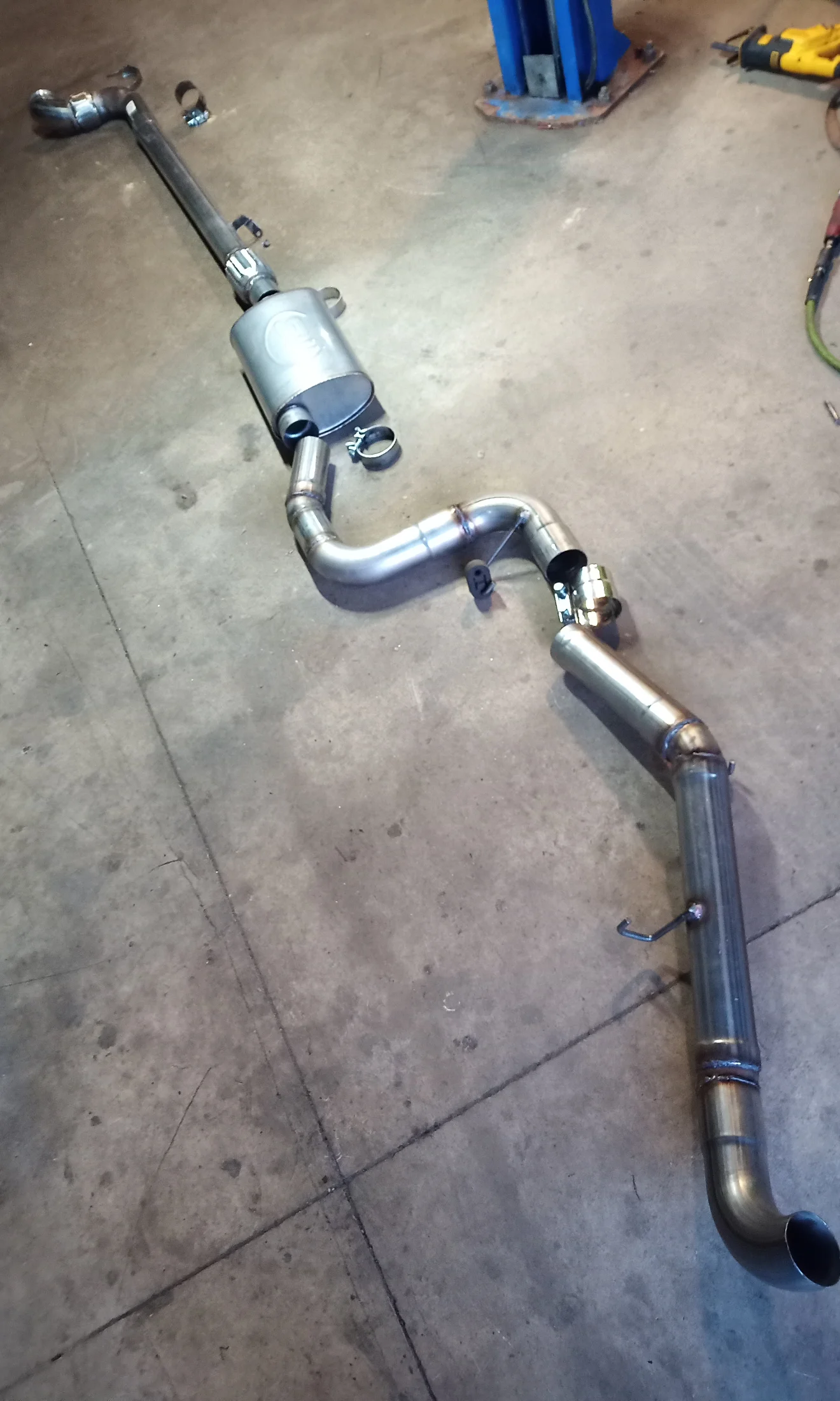

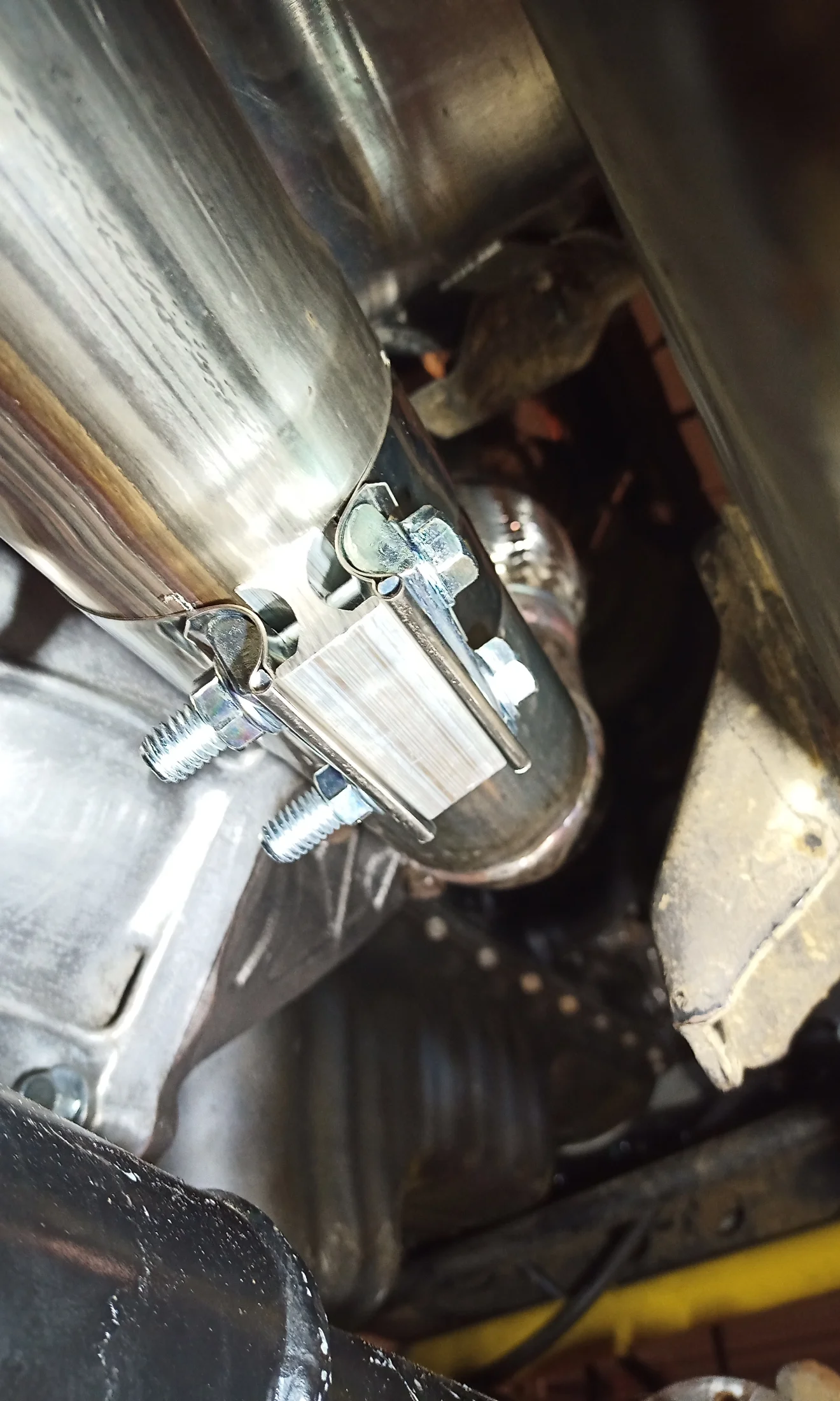

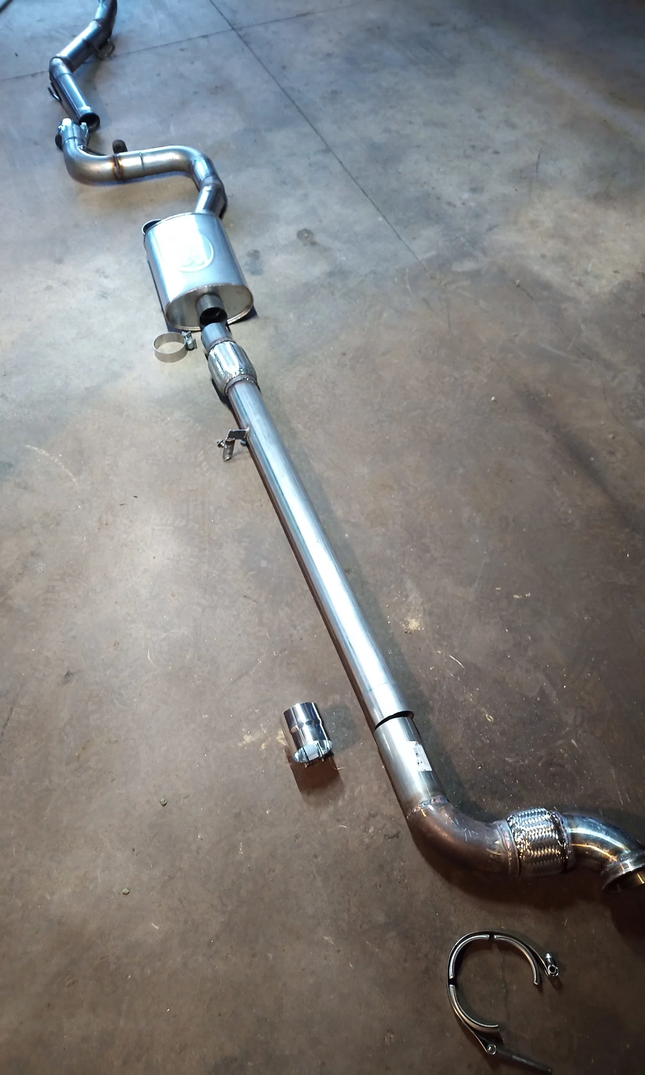

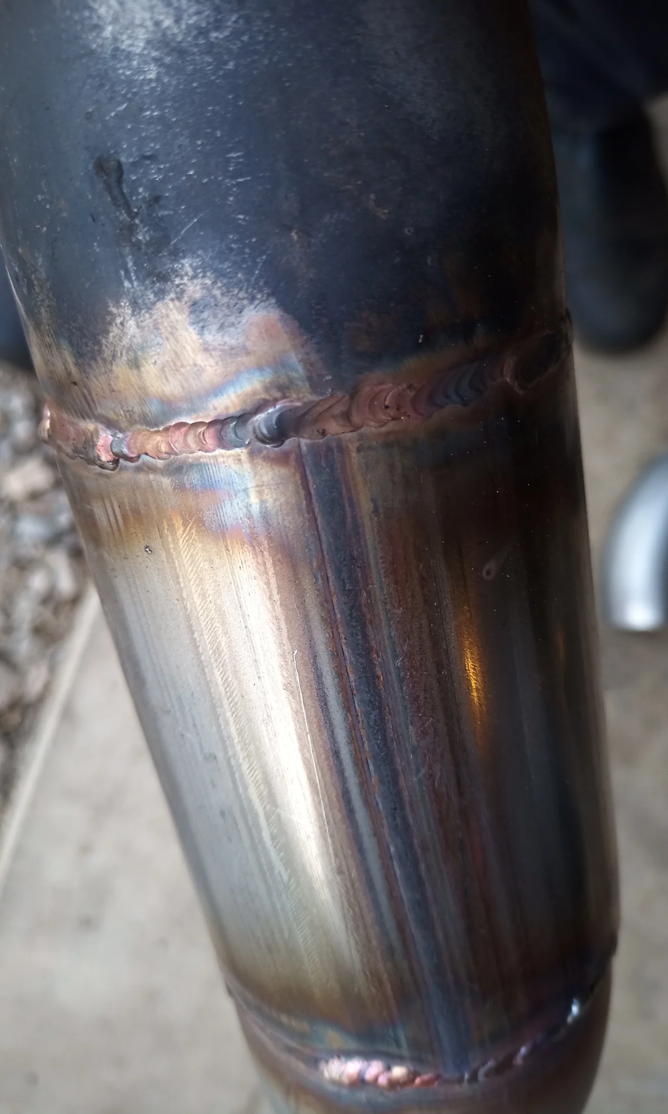

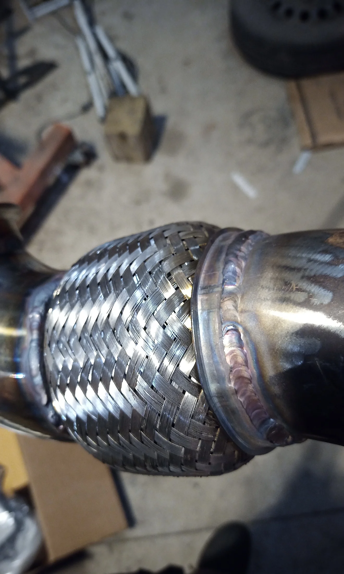

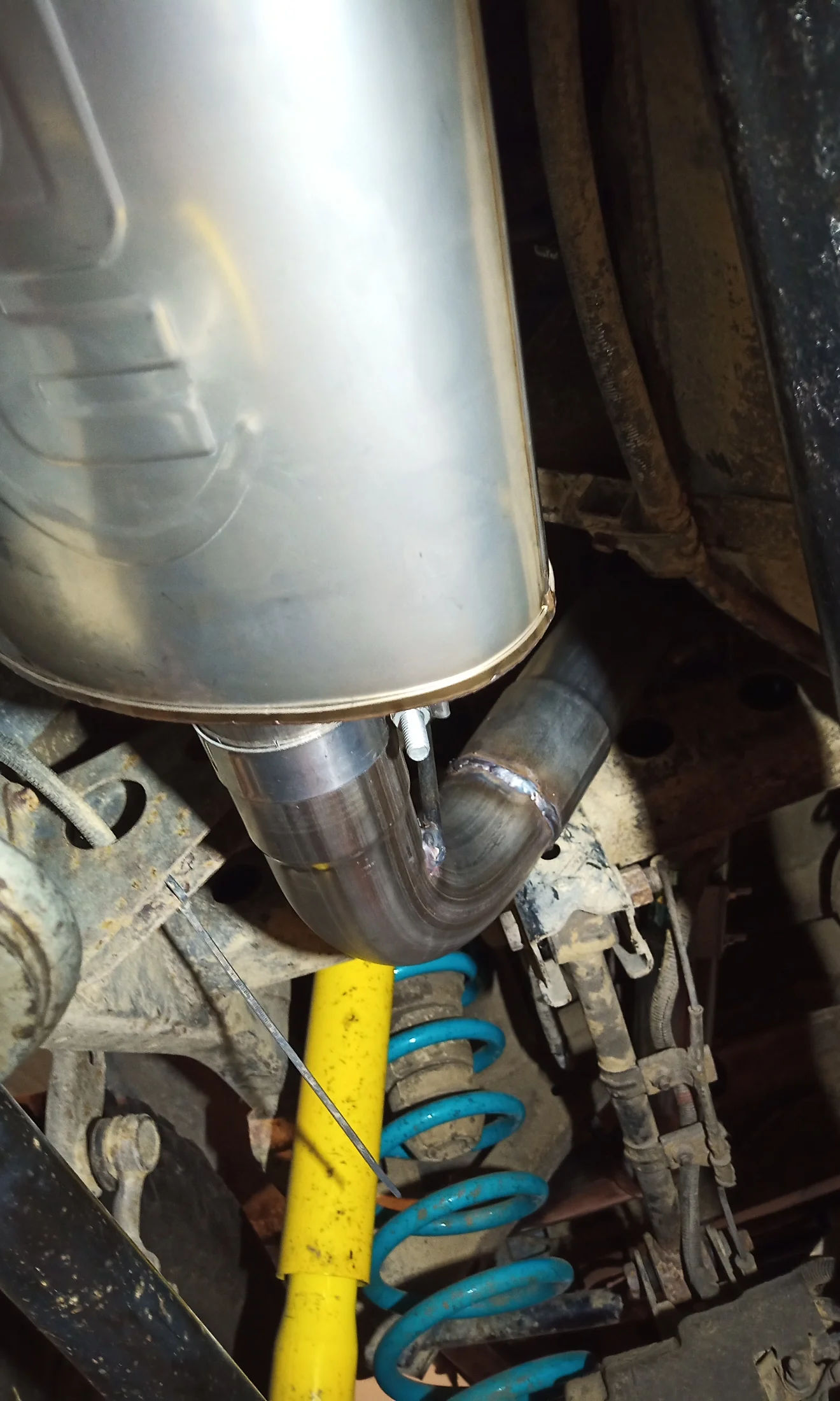

a while back i read a few threads about running the exhaust system inside the frame. i thought that's crazy it would be so tight with the transfercase sticking out on the right side also. so i started making a traditional outside the frame exhaust. halfway done i cut it apart and started over making an inside the frame exhaust... yes it is tight but there are many benefits. Way less bends, less exposure to smash with rocks and easier to tie in sliders. (when i bought my truck it was missing a tube on the right front prob because this is where the exhaust is in the way. the old system off this truck actually had some 3" non-magnetic stainless bends so I reused them the rest is 409 stianless. mostly mig welds but a few tig here and there. Stainless works turbo muffler,.
unique tail pipe over the frame at the end. the slee hitch is where you would normally put it. the previous owner cut away the bottom of the rear quarter panel.
made a new heat shield above the new exhaust location.

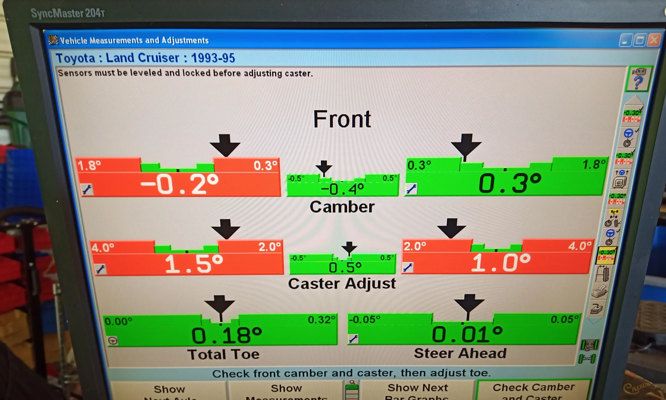

Dobs "2.5" lift springs. I'm measuring a 4" front and 4.5" lift rear even with a front bumper and winch. delta 3" arms more castor would be nice . i think i'm going to try a lower spring. i don't need the truck this tall anyway. let me know if you want to trade.

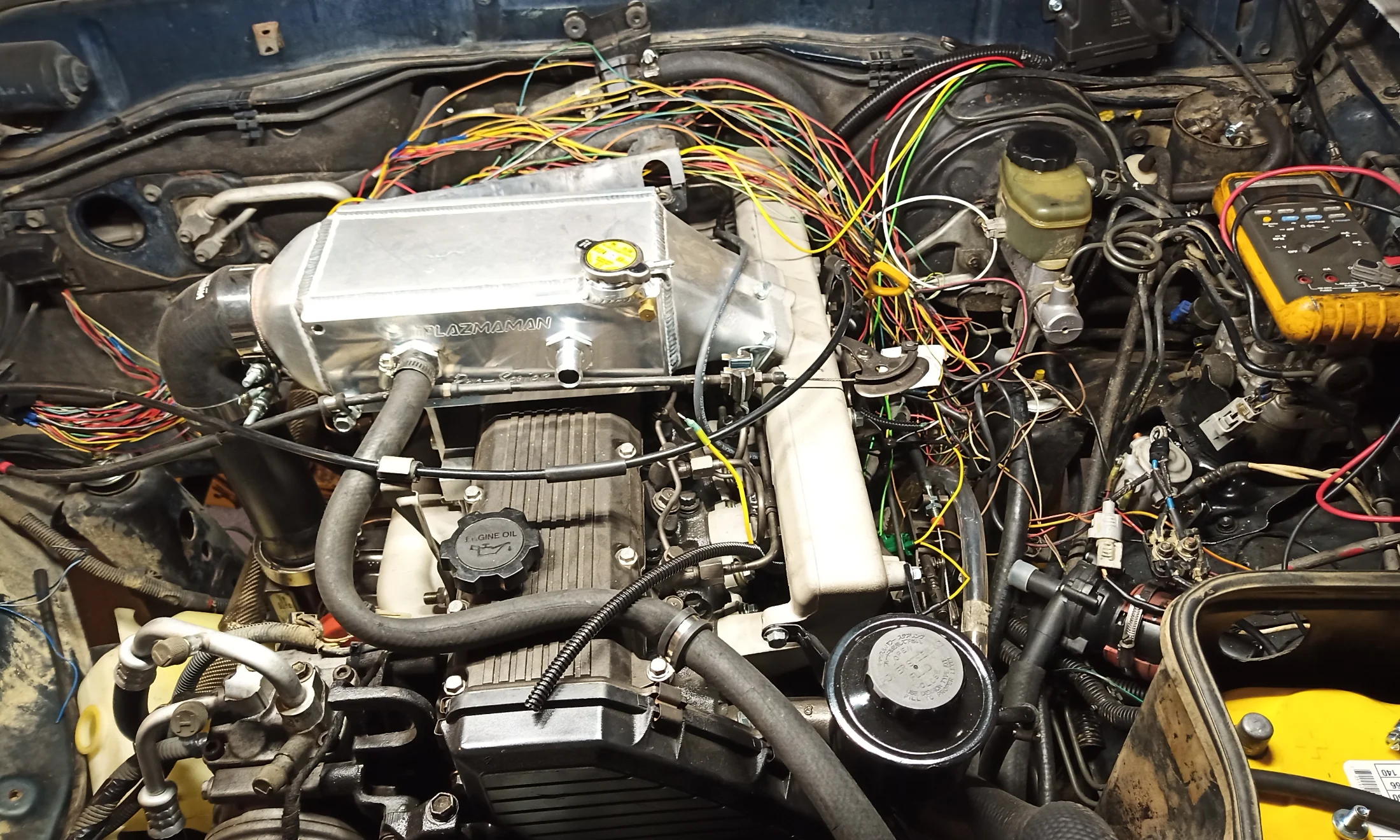

ahh wiring.

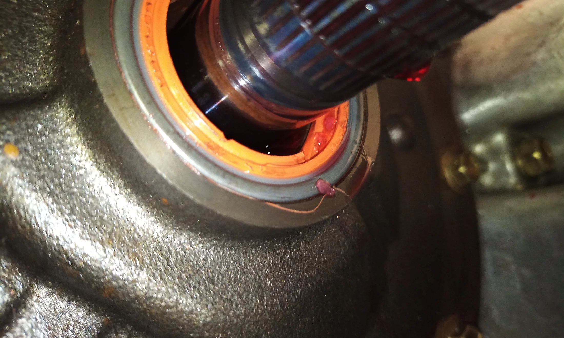

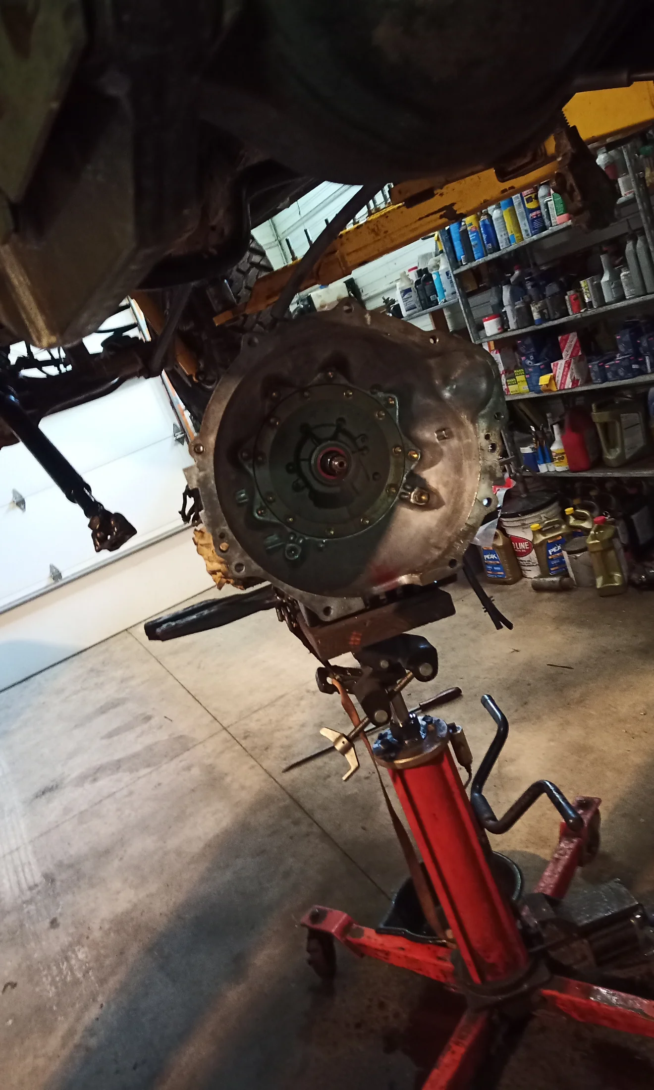

first start didn't go as smooth as I had hoped. there was transmission fluid pouring out of the front of the trans. As it turns out. wholesale automatics either chooses not to chamfer their torque converters or mine accidentally got skipped. The factory converter has a generous chamfer on the ears that stick out.... i've installed loads of converters and front seals. this is the only one i've ever torn.

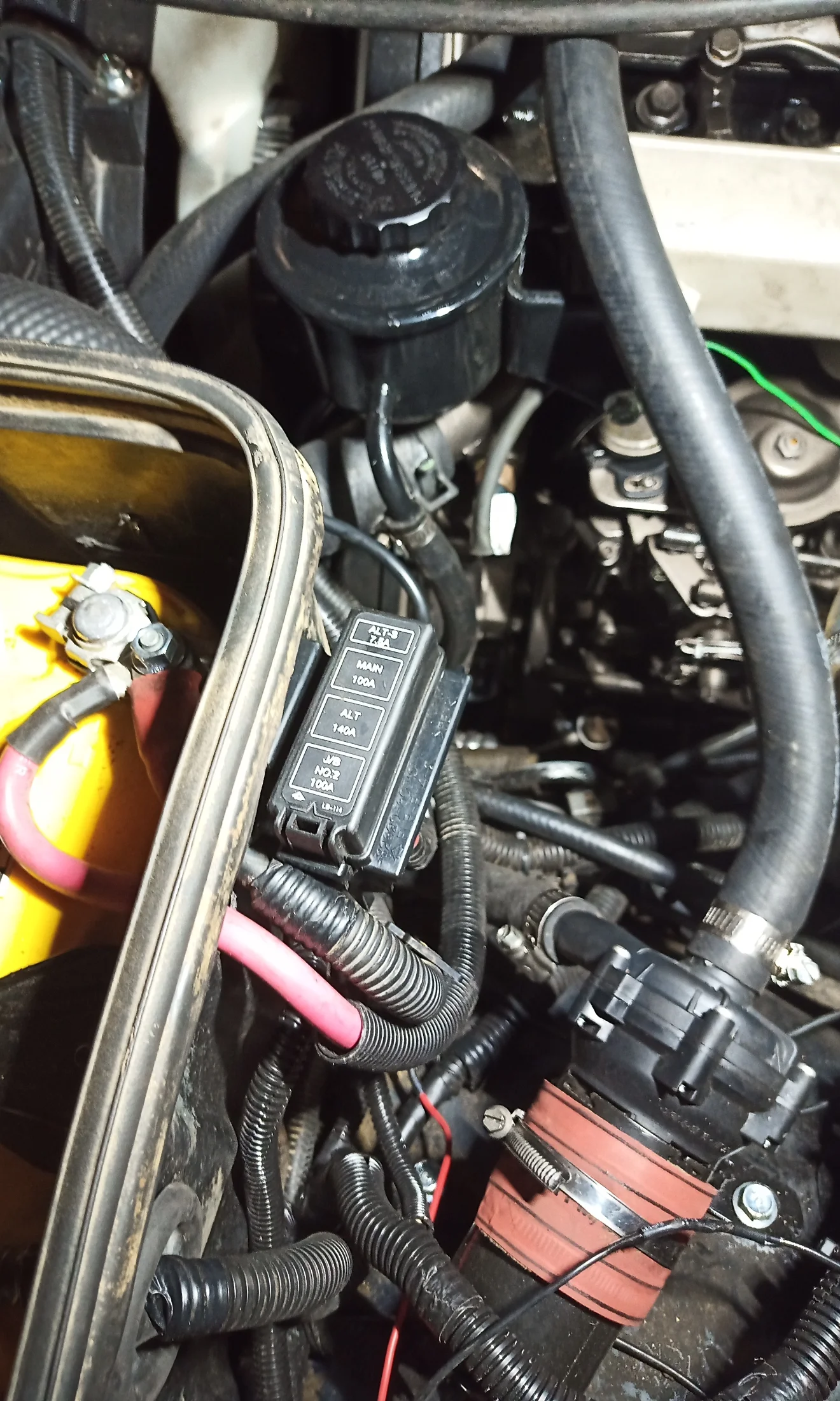

why run a map sensor when you can run a tmap? (temperature + manifold absolute pressure) i hated to cut into the nice new intercooler but it had to be done.

haven't finished up looming the wiring as i want to make sure the transmission electronics are working good first. Didn't paint the stock airbox as I'm considering cutting it up to make it 4" to the turbo but really the performance is pretty good as is. Then there is the interior still. didn't get to take it to the KTTR. Brought the tundra instead and had a great time on the easy trails.

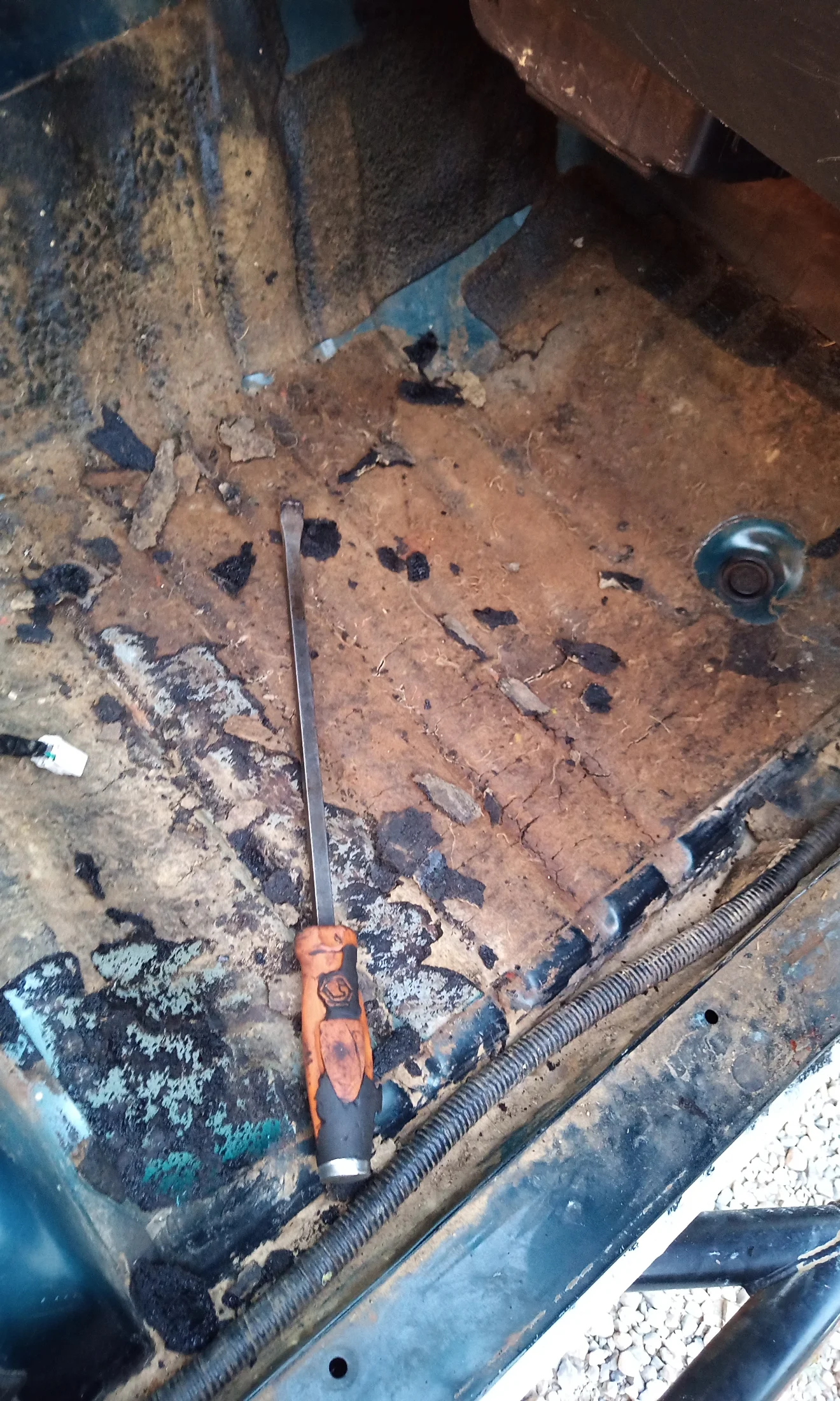

This truck came with no carpet. aftermarket carpet seemed difficult to get it cut right and would be almost impossible without old carpet to use as a template. was able to source a used carpet with no holes or damage, just dirty, stained and faded. lots of time with the tornador and pressure washer got it all clean. used RIT synthetic dye in a pump sprayer I used "smokey blue" "graphite" and "frost grey" all mixed together, it's very close match to the factory grey just a little less blue. sprayed it all down and let it sit wet with dye overnight. in the morning rinsed it all out real good and let it dry. The dye process was actually very easy. totally got rid of all the sun faded and stained areas. I was worried that it would be too crispy or that the dye would transfer but that has not been the case.
