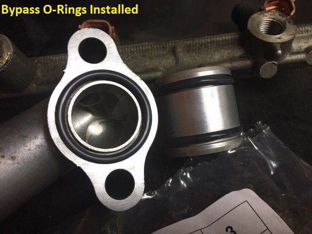

Change the bypass o-rings while you’re there.
Hi Joe! Thanks for the suggestion.
Yea, I replaced the whole bypass assembly last month (bypass pipe, inner pipe and o-rings) as the whole thing was leaking and not looking good. By the way, just a suggestion...that could be another kit that you could sell on your website as it is directly related to the t-stat kit that you already sell. A water bypass kit with the pipes and o-rings. I'm sure it would make some 80series owners life easier.
I finished the t-stat job this morning and went for a drive, the rig is running smooth with a new cooling system and around 2˚F cooler. Thanks @flintknapper for the heads up on the correct gasket placement!
