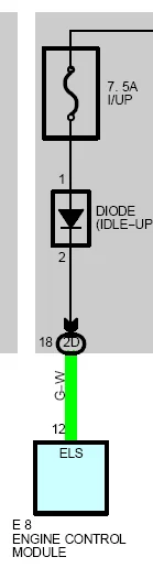

You might have to find a EWD (electrical wiring diagram) for your model and check to see if there is a OBD2 circuit.

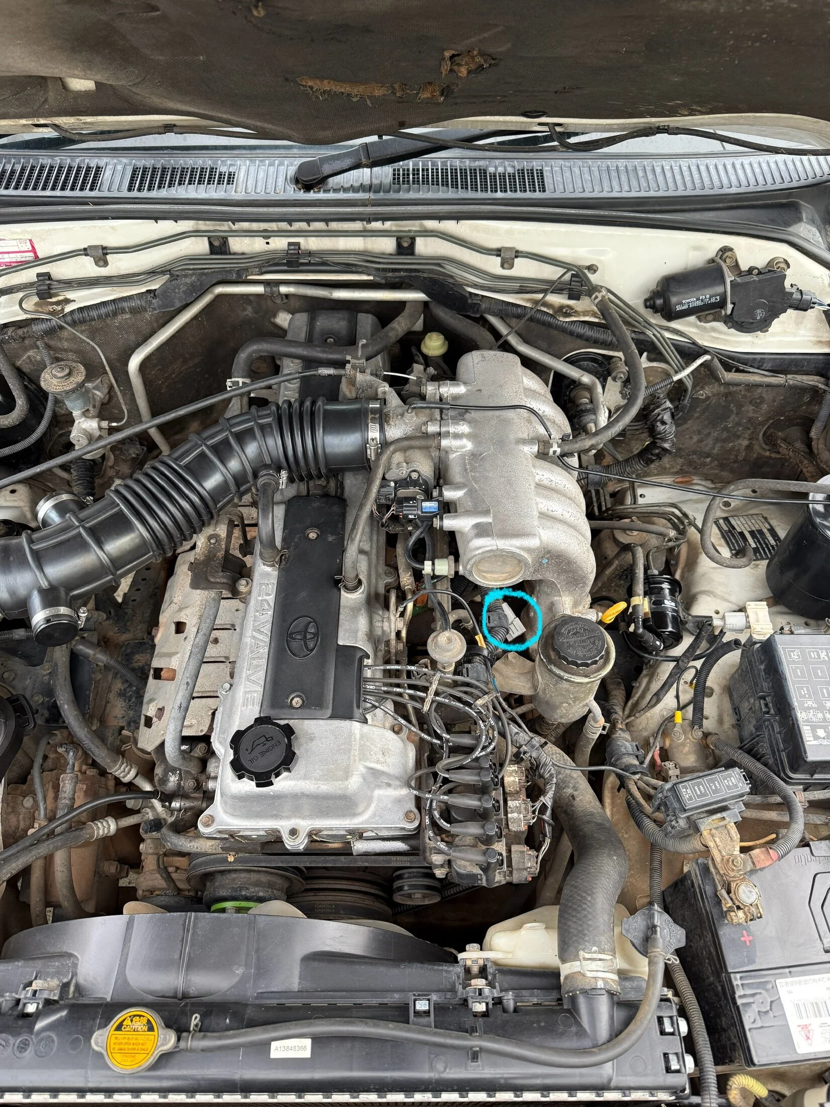

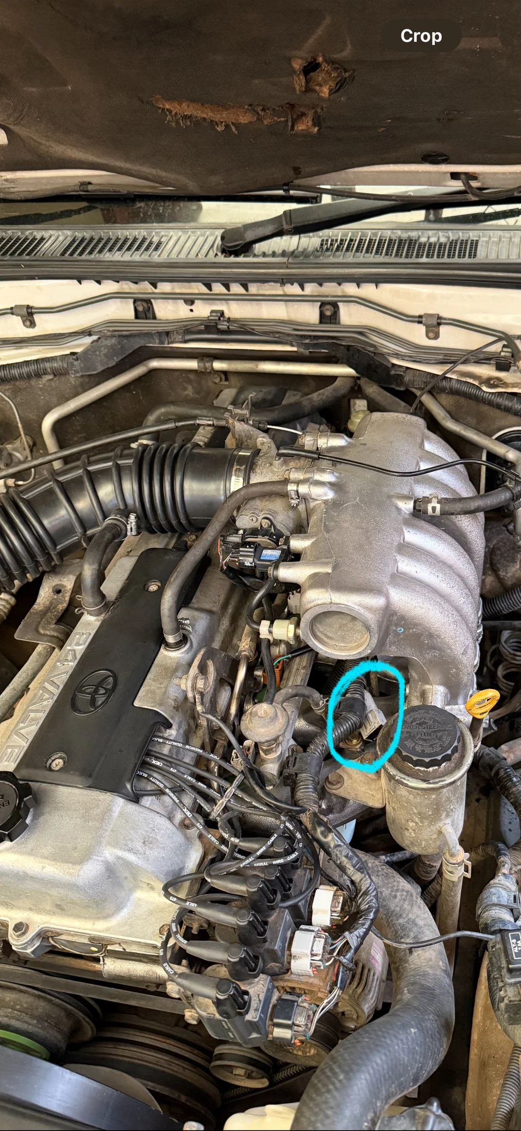

I’ll check for a piggyback this afternoon. I did notice a plug under the throttle body with a dongle thing in it. But I have no way of knowing what it actually does.

Have taken some pics! Hope you like, sorry the steering is on the right hand side! I also have an American 75 f truck, I kept that left hand drive.
I’ve circled in blue on one picture the plug thing I found, yet to find what it does.

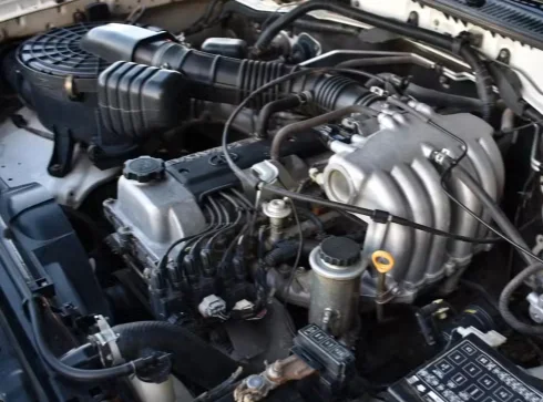

Neat seeing the newer 1FZ-FE. Is that the fuel filter on the passenger fender? Is that the stock location for it?

there are a couple of items missing before the throttle body on the intake tube that are blanked off in your pics.
See the pic below as there are two canister type plastic items that need to be in place if wanting it to be back to standard. You may want to source these and install so the air flow is what the ECU and sensors are looking for.

Double points to anyone who can help me with what the f**k this is?! I’m still extremely curious. Anyone got factory wiring schematics?
Can you take a closer picture of that electrical connector, end on? It looks like a diode end plug.
Speaking of diodes, do you know that you might have a Idle-Up Diode? Check into that and its fuse.
Do you even have an IAC given that you have an electric throttle?

The idle up diode I will definitely have to look into. So would it potentially be that it’s sh*t itself?
