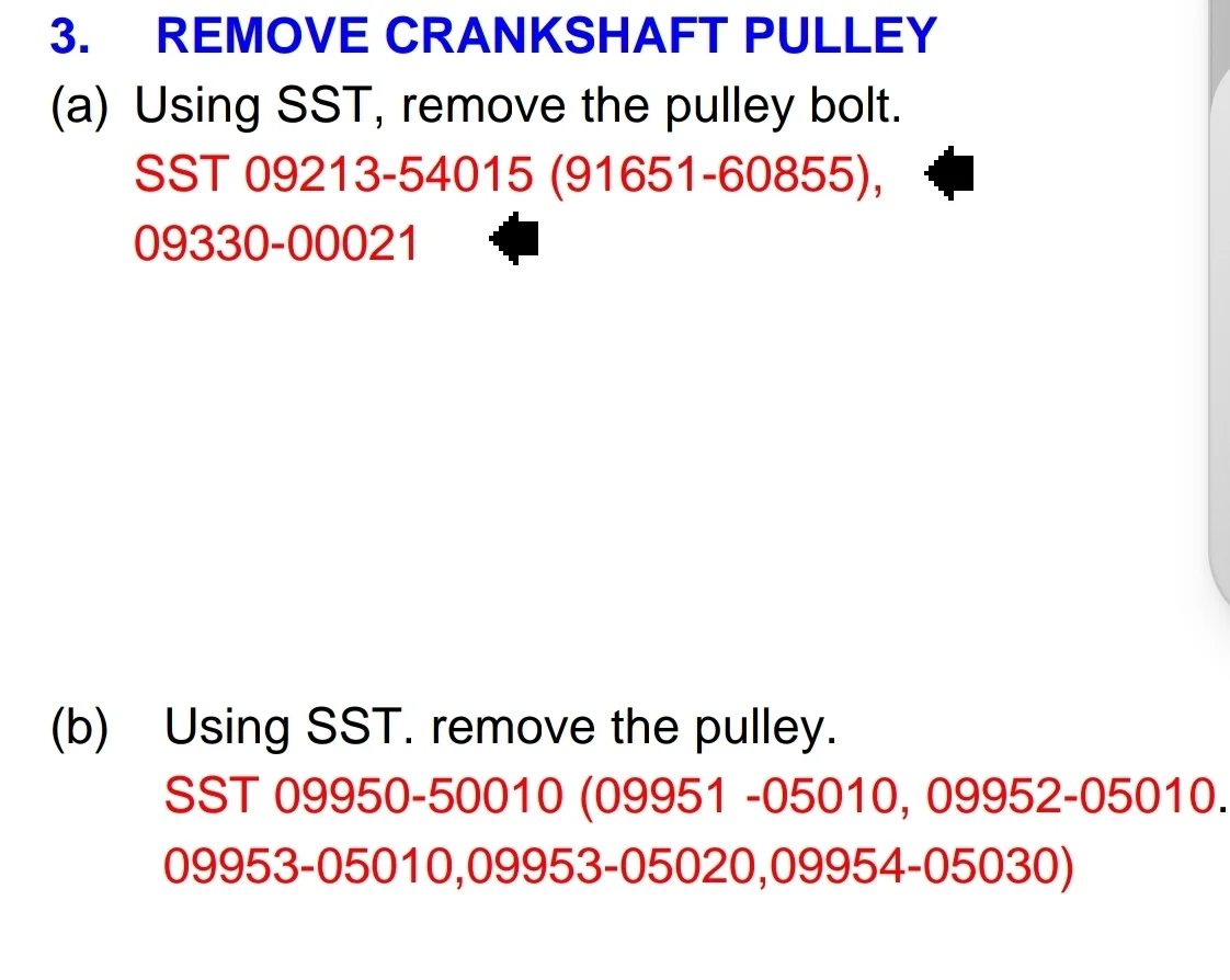

At least one of the SST tools by image description looks to be long enough to hit the radiator. I've seen a video of someone yanking the radiator and have also received advice that it could stay with a thin piece of plywood protecting the fins.
None of the SST tools look that proprietary but I also have limited information about this engine in this engine bay. Anything I have found thus far is in a full engine bay accessed with a hood, not through the front passenger seat of the cab.

Picture of said tools attached.
That first tool holds the crankshaft pulley so you can release the bolt. The second tool is a puller to remove the pulley. As you mention, they sometimes go a bit overboard on the process. In my experience Toyota crank pulleys can always be removed by hand.
I don't have this SST to hold the pulley on any of my engines, you can use an impact if you have access, or get a breaker bar on the bolt against a chassis rail, then blip the starter. I've also just drilled a long piece of angle iron, bolted that to the crank pulley and manually tightened the bolt. while the angle 'tool' is hard against the ground.
There is a Toyota Dyna (=ToyoAce) FB group where you might get more specific detail regarding radiator clearance, but I would guess you can get a breaker bar on there with the radiator in situ. If you can't free the bolt then time to drop the radiator and get an impact on it.
