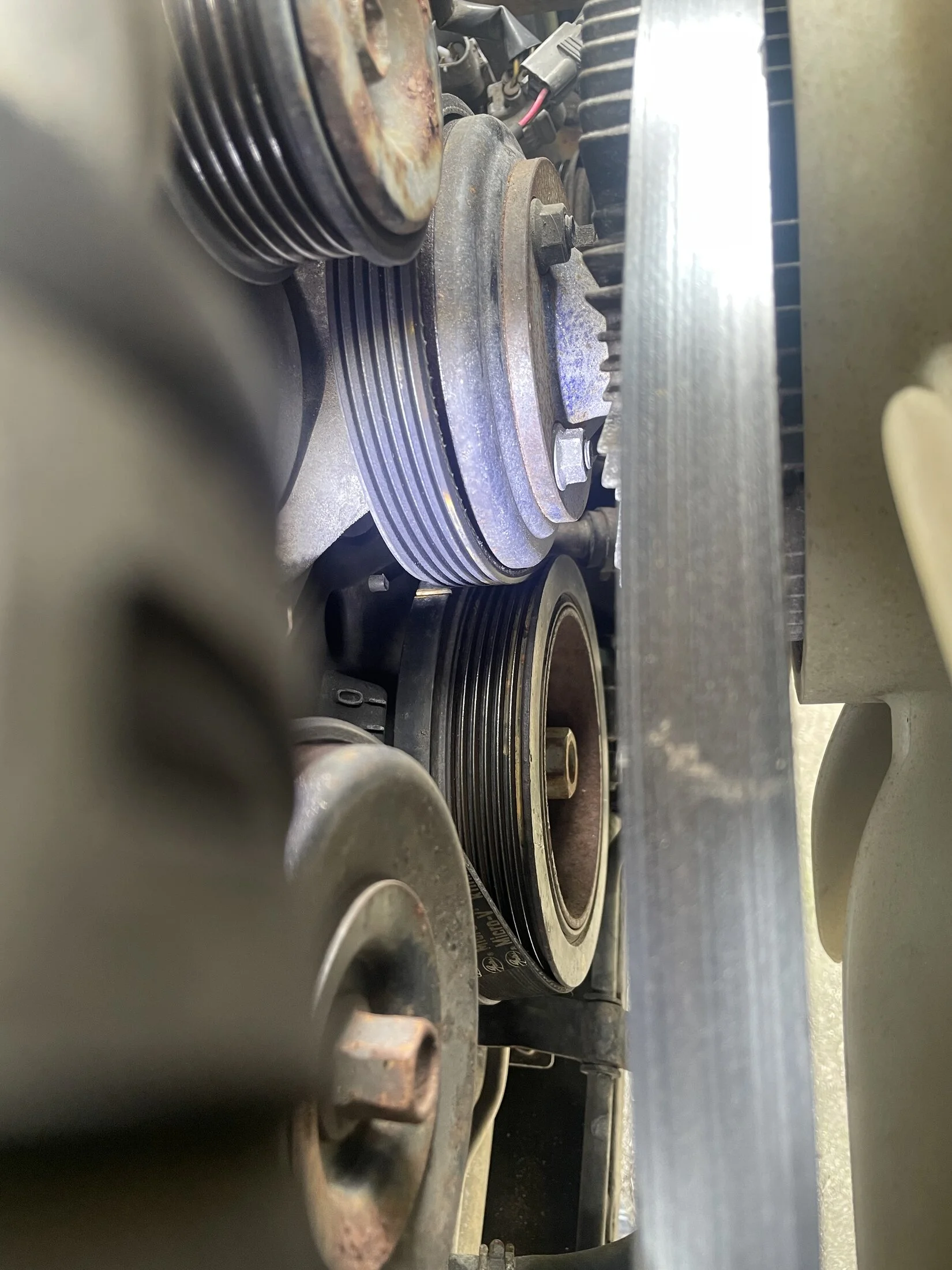

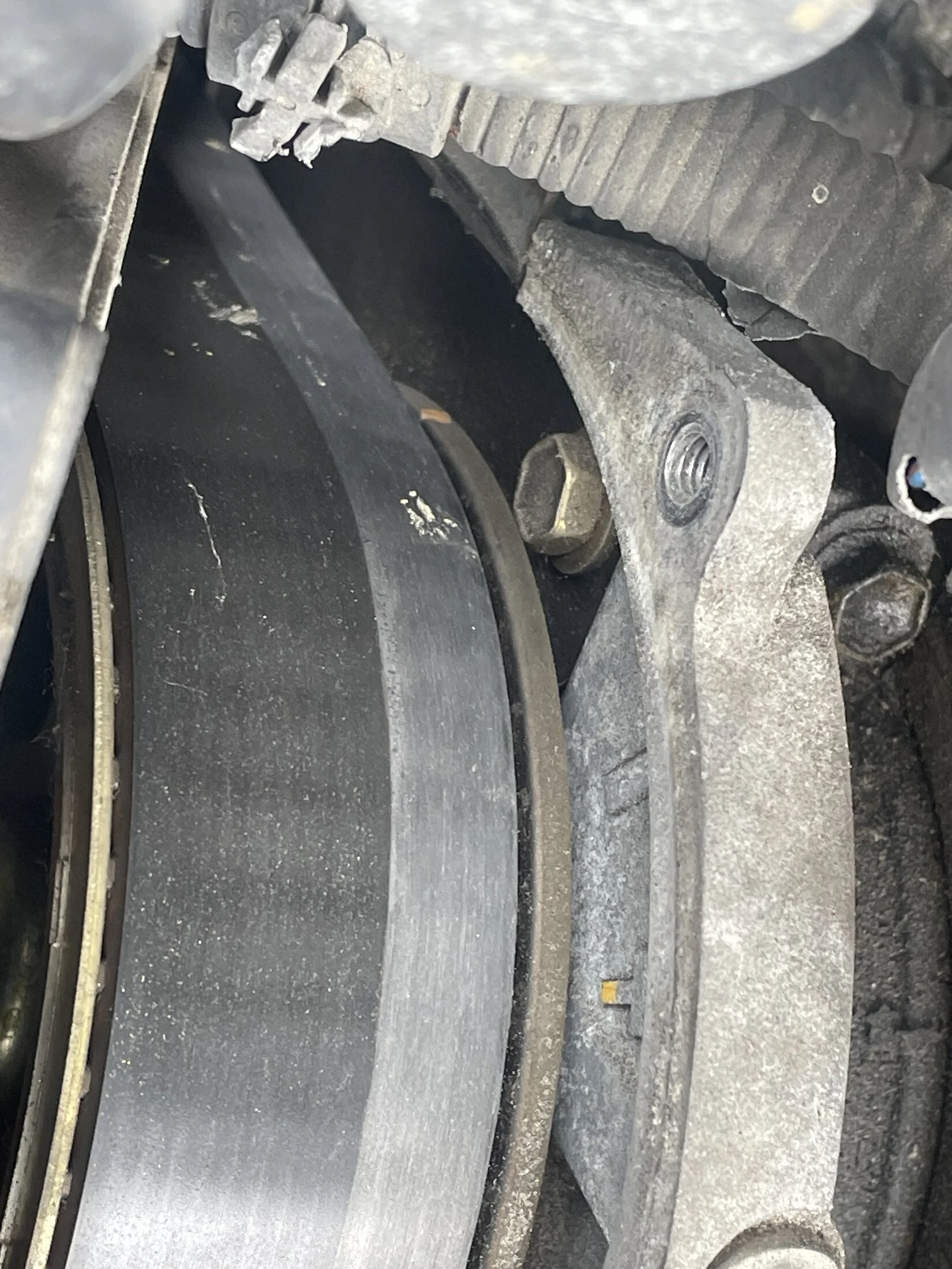

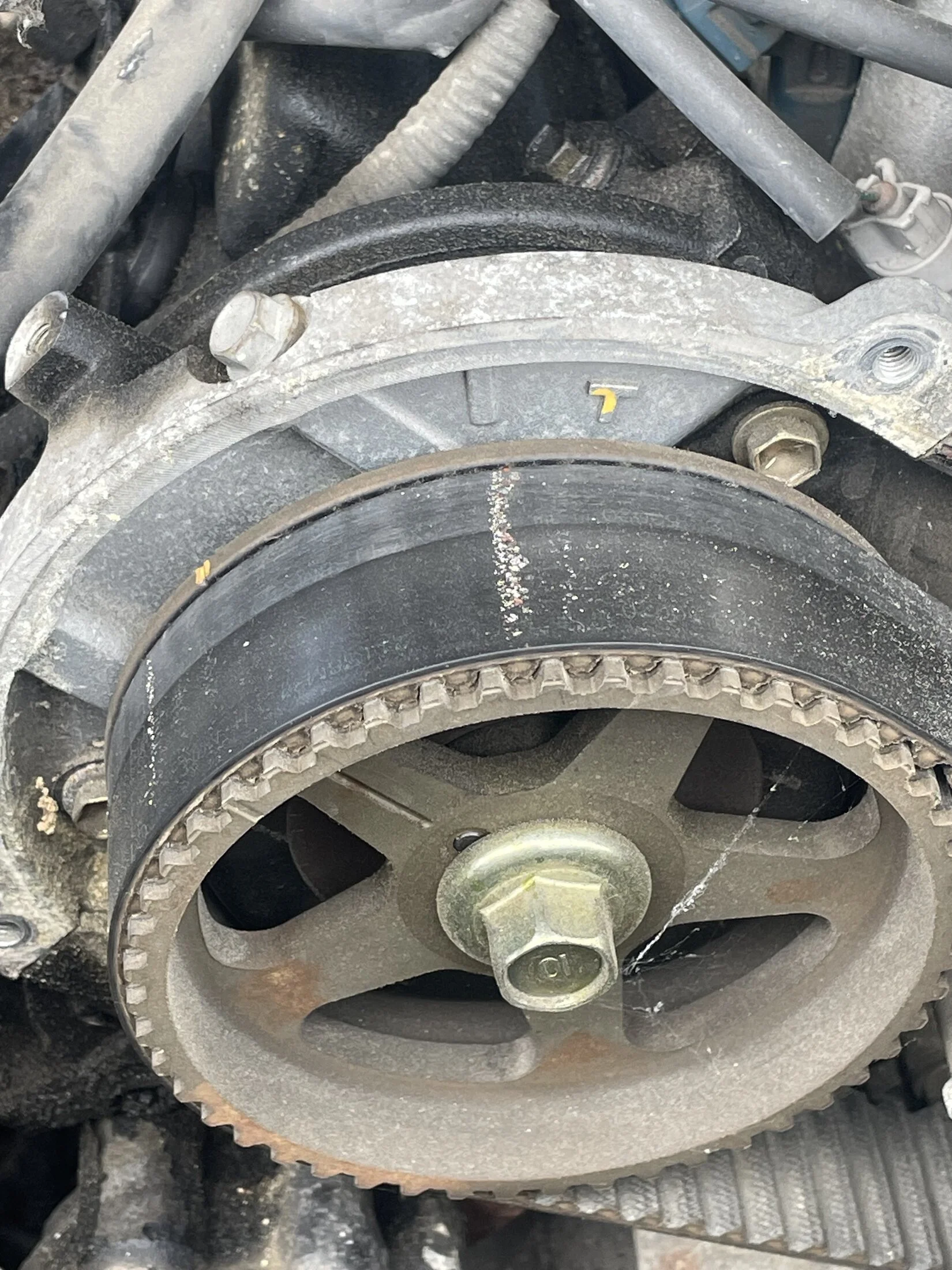

So I got the timing belt covers off and this is what I see. To me, it looks like its jumped timing but I'm not positive if I'm looking at it correct. With the crank aligned with that nub the cam gears are supposed to be on the T, is my understanding. Please correct me if I'm wrong. It also looks like the belt has some scuffage.
Crank Pulley
Drivers Cam Pulley
Passenger Cam Pulley
